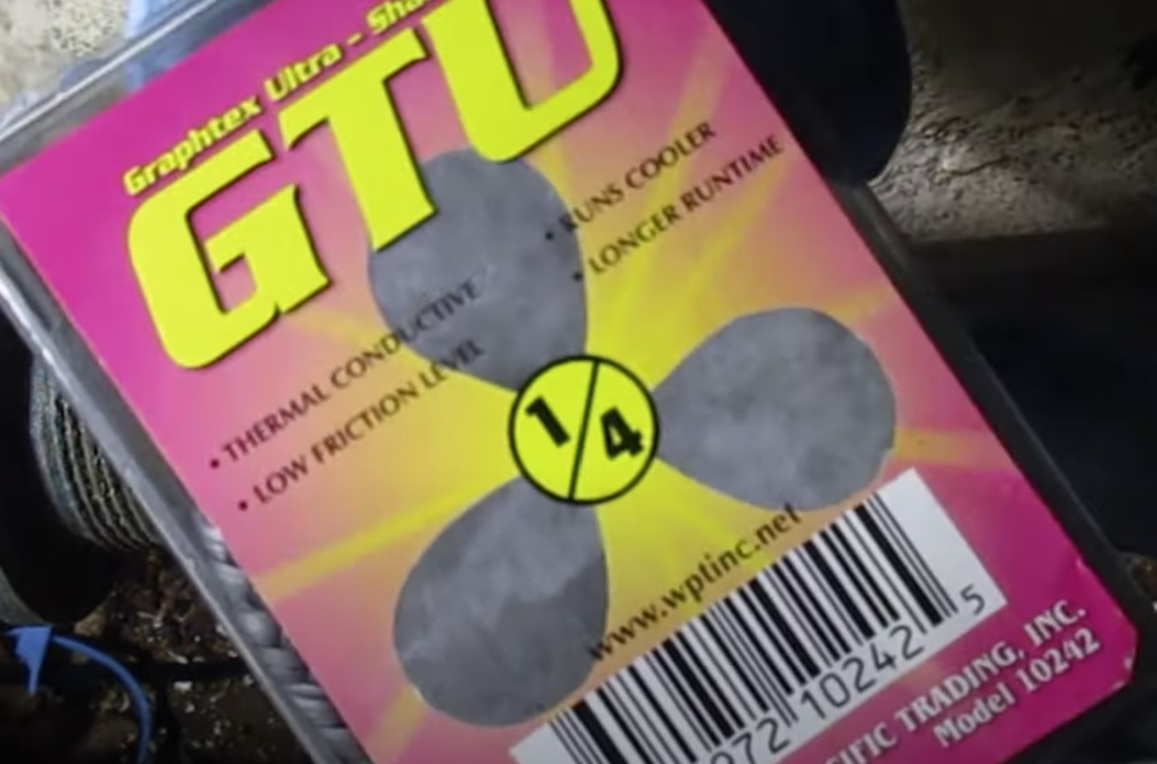

You're welcome, Jim. Effort! Our boat has the standard bronze stuffing box with a 1-1/4" prop shaft. No way can I get 1/4" into that box unless I hammered it in. I've been using 3/16" for years (seven to ten years) with good results and even tempted to go with 1/8" because of how difficult it was to install 3/16". Your picture appears to be of the same product that I use. Low friction, good seal, lasts for years.
