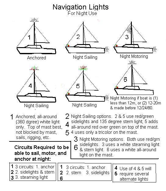

But then I wouldn't have a steaming light. " Actually, you wouldn't have a stern light for sailing at night. Your 360 white could be used for a combo steaming and stern light for motoring, and also for an anchor light, but not as a stern only light.
The simplest setup to be able to anchor, sail, and motor with the correct lights showing for each will require 3 circuits and 3 lights. 1. red/green sidelights. 2. anchor light. 3. stern light.
Another setup uses 3 circuits and 4 lights. 1. red/green sidelights and stern light. 2. anchor light. 3. steaming light. This is probably the most common.
"But then I believe Jersey 16 said that's good enough for these boats." Remember that Jersey 16 won't write you a ticket, but he won't pay for one, either!
The attachment may help you visualize some of these arrangements. There are a couple of these which are legal for part of the time, but which I cannot see being able to configure to do everything. -Paul

With the above and a switch on the bow lights and another on the stern light you could be legal for sailing at night, motoring at night or on anchor.
Paul that is the best 'single' drawing I've seen yet explaining what lights should be shown when. Thanks,
