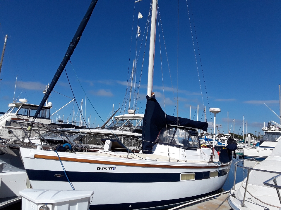

I just figured by chance someone out there has this same design, I have #155 of this built in 1972 registration as 1973 Coronado 35 sloop rig, some of original paper refer to as MS model?
Appears the wiring was updated nicely as boat is in above average condition.
With Perkins 3 cylinder running nicely. Lots and lots of room in a 35 with the queen bed aft.
