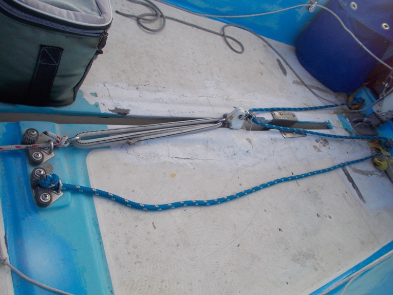

Gregory, I love dinghy sailing... so I took the time to find this piece that might give you some inspiration. I've linked the entire article here: www.analogengineering.com/sail/c15/ below is the section pertaining to your question.
" light weight centerboard is held down by the white/red line and the bungee cord. In a centerboard grounding, the top of the centerboard pulls forward and stretches the bungee and it can take a lot of abuse. I did this after pretty much ripping out the centerboard hinge hitting an underwater tree stump with a fixed pull down line. The blue line pulls the centerboard up and can also be used to keep the centerboard at varies angles between full up and full down (such as for a downwind run or running the boat in shallow water)."
