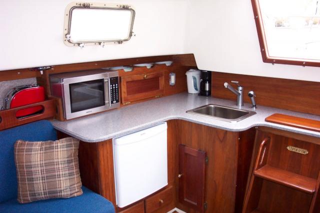

When I re-did our Hunter30 galley 5 years ago we installed Corian and have had no problems. Took the old counter tops and they used them as a template. Made sure there were lots of cross supports and just a thin bead of silicone which (I assume) allows for some movement. It was about $700......

Your galley is wonderful. Nice how the counter top wraps around into the companion way area.
