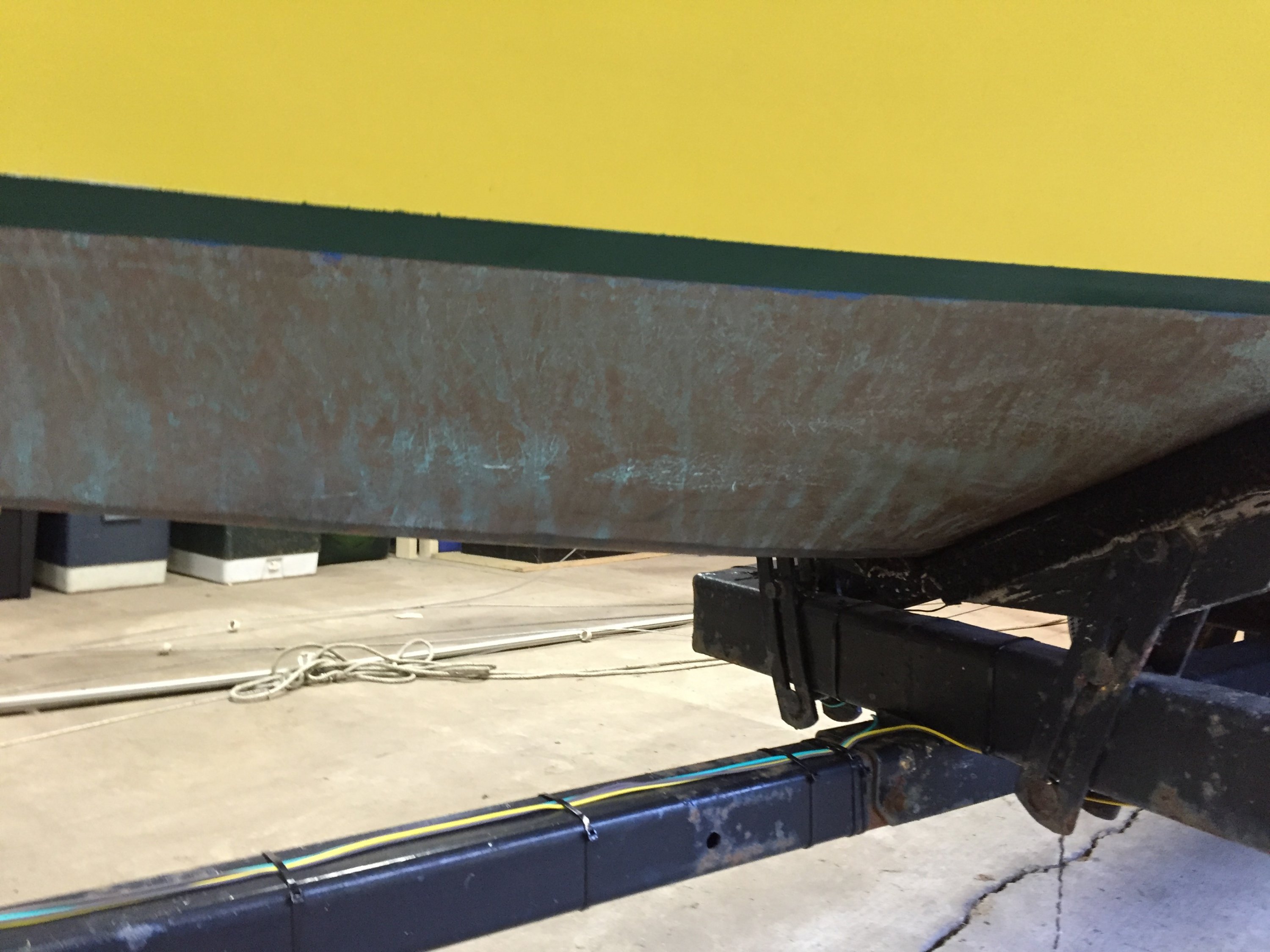

So I still have my 26' but bought an O'Day Daysailer a few weeks ago and have been having fun with that on the local lakes and figured it would be a great thing to learn and practice on. My question is this, the PO or the PO before him has painted the bottom with what appears to be copper. I mean it has the copper color and it's tarnishing green just like a non-cared for copper plate would.
Can somebody enlighten me on what this paint is? It's in great shape with no dings or scratches but the green bothers me.

Copper oxide is toxic to marine life and helps keep the scum off of the bottom of your boat. It is fine as is...leave it alone... and if you are not leaving it in the water you probably don't need to worry about anyway.
14,149
The green tarnish is the result of boat cleaners, especially ones with some sort of acid or bleach. Just wash it and run a green scrubby over the surface to clean it up. When it wears through, then add a coat. The easiest quickest bottom paint there is, but is does dump copper into the water.

So no TarnX to make it shine? I wish I knew it was VC17. Didn't think it came in copper color though. Just black and blue I thought. Most all around here use VC17 but I have never seen this straight up copper color before---anywhere.

I had a boat that had Interlux Bottom Kote Y999 Bronze. I thought it was VC17 but contacted the original owner to clarify. He had part of a can so I know this was it. You are not supposed to mix different types of bottom paint....is it possible to contact the PO and ask what was used on the bottom? You may be better sanding the existing paint off before applying new paint.

Yep VC17M, it makes your boat look like a giant copper kettle until the copper powder additive starts to oxidize in the water. This is referred to as an ablative anti-foul coating which minimizes the proliferation of algae and other water borne biologicals. It does wear down over a season or two, but once the boat is back on the hard, the paint job on our H30C hull takes less than 2 hours.

The original VC17 did not come in colors. It went on copper colored and once in the water it turned a darker brownish color. Once it came out to the water and cleaning products got on it the paint would discolor. A very light sanding or burnishing would bring back the copper color.

VC17m. My boat looks like that every year after I paint it. It slowly wears off, and you can powerwash it off as well. Just recoat with a thin coat.

Can anybody tell me what the color is for the ORIGINAL VC17? When you look it up to buy, there are 3 choices. Black, blue and then it says ORIGINAL.
VC17 is not an ablative paint. It is a thin-film vinyl paint and is quite hard.
