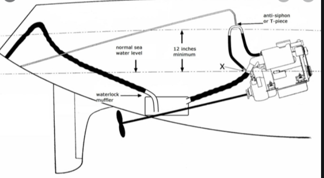

I hope yours looks like the diagram below of a 1984 Hunter 27.
I don't have as much curvature as the diagram shows and the final hose run to the outlet is flat against the hull. Ithink I'll dive under---which I was hoping to avoid, and see if I can plug it from the outside before disconnecting the hose. Thanks for the response

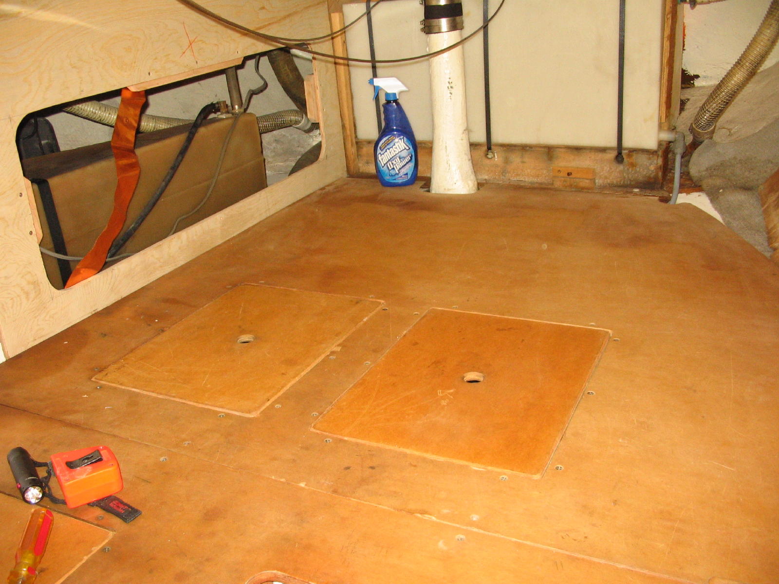

10,257
Steve, interesting note on the hose. It should leave the fiberglass fixture and go almost vertical to up under the combing then back down to the muffler, making an anti siphon loop.
EDIT: Picture isn't too good, but you can see the exhaust hose loop on top of the battery box in the picture. It comes from under the tank bulkhead, turns up then back down to the molded fiberglass exit.

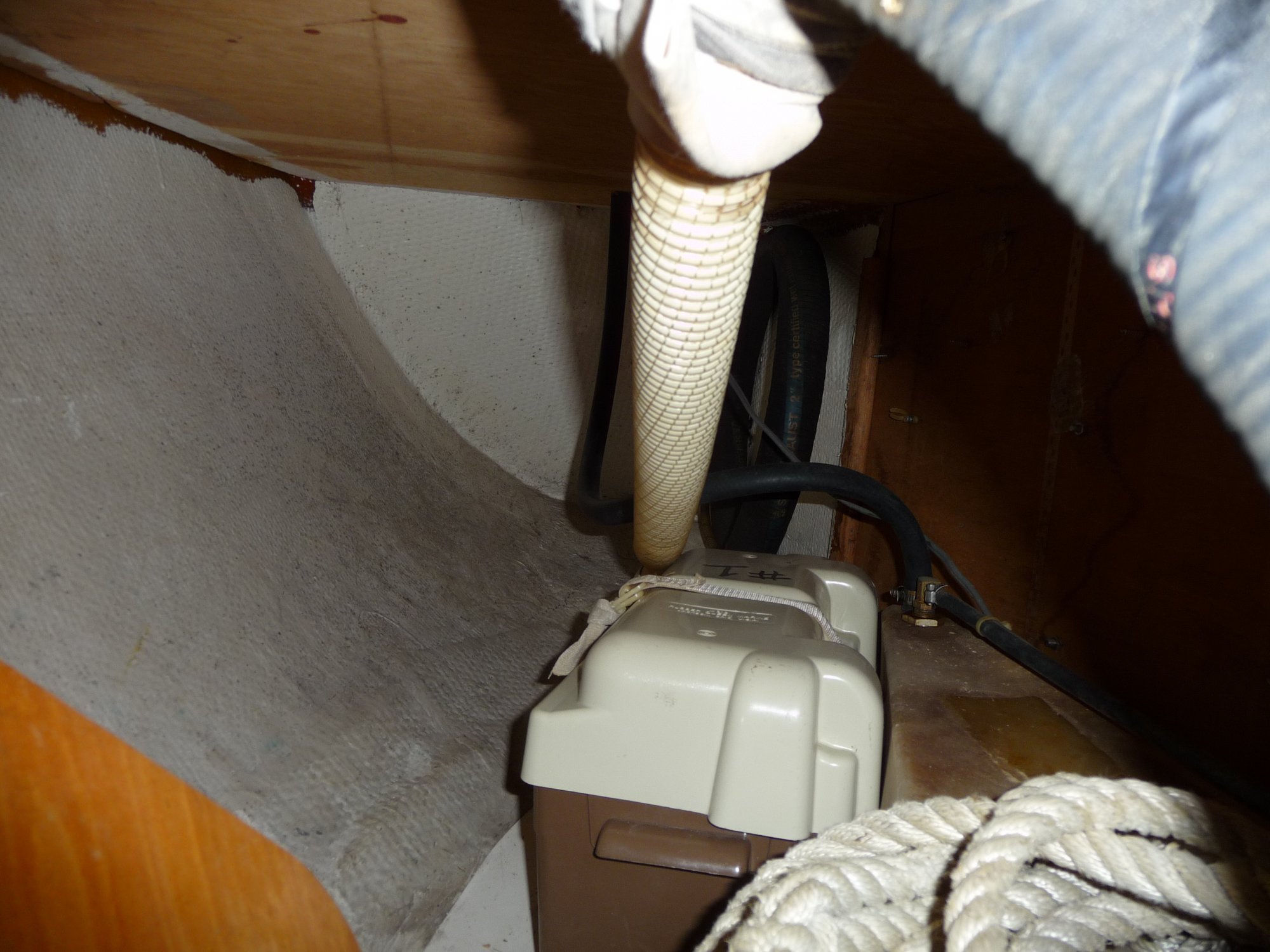

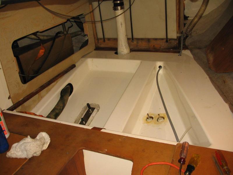

Dec 14, 2003
1,450
Steve, Kloudie is right that the through-hull is molded in and the hose is slipped on it almost vertical. With the boat at rest, the exhaust is about 4 inches from the water level. Unless the molded in 3 or 4'' high hose receptacle got banged seriously it should be OK. Not a bad idea however to plug up from underneat if you can. Even a packed rag (or a tennis ball) will slow the input of water if ever the stern got in. Besides the 40 gallons on the port side, instead of asking you wife to act as counterweight, you could plug up the anchor well and fill it up with water. That should raise the stern enough to provide safety and will be easy to empty by just removing the plug. Attached is another pix which shows the hose vertical. It is the one closest to the stern, the other one being from the starboard side cockpit scupper. Good luck.
