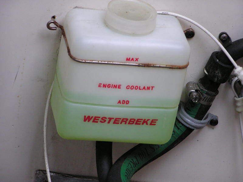

if it isnt, it could blow the lid off or crack the tank when the pressure rises in the system... or not if its a strong tank.
either way it would never work properly as a recovery tank without a vent to atmosphere.
