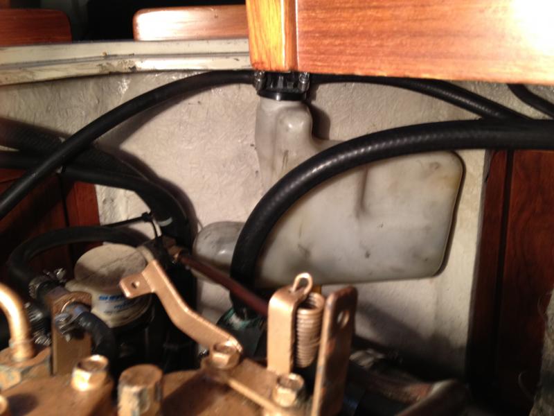

I bought an automotive tank from the local scrapyard, fabbed up a mount and will be installing it tomorrow.
My Catalina is a 1988 Mk 2, and it too had the overflow direct to the bilge

I have installed the overflow tank, I was lucky I bought a tank that was only about 2 inches thick, as there is not much more room than that, I fabbed up a mount from an old plastic drywall knife, and attached the tank just starboard of the aft engine access door under the sink, I kept the tank as high as possible, and routed the hose away from the hot exhaust. I should have taken pics, maybe later.

Pic of coolant recovery tank
Here's a pic of the finished install, now I wish I had noticed what vehicle the tank was from, the car was really smashed up, and there was not much of it left in the scrapyard
