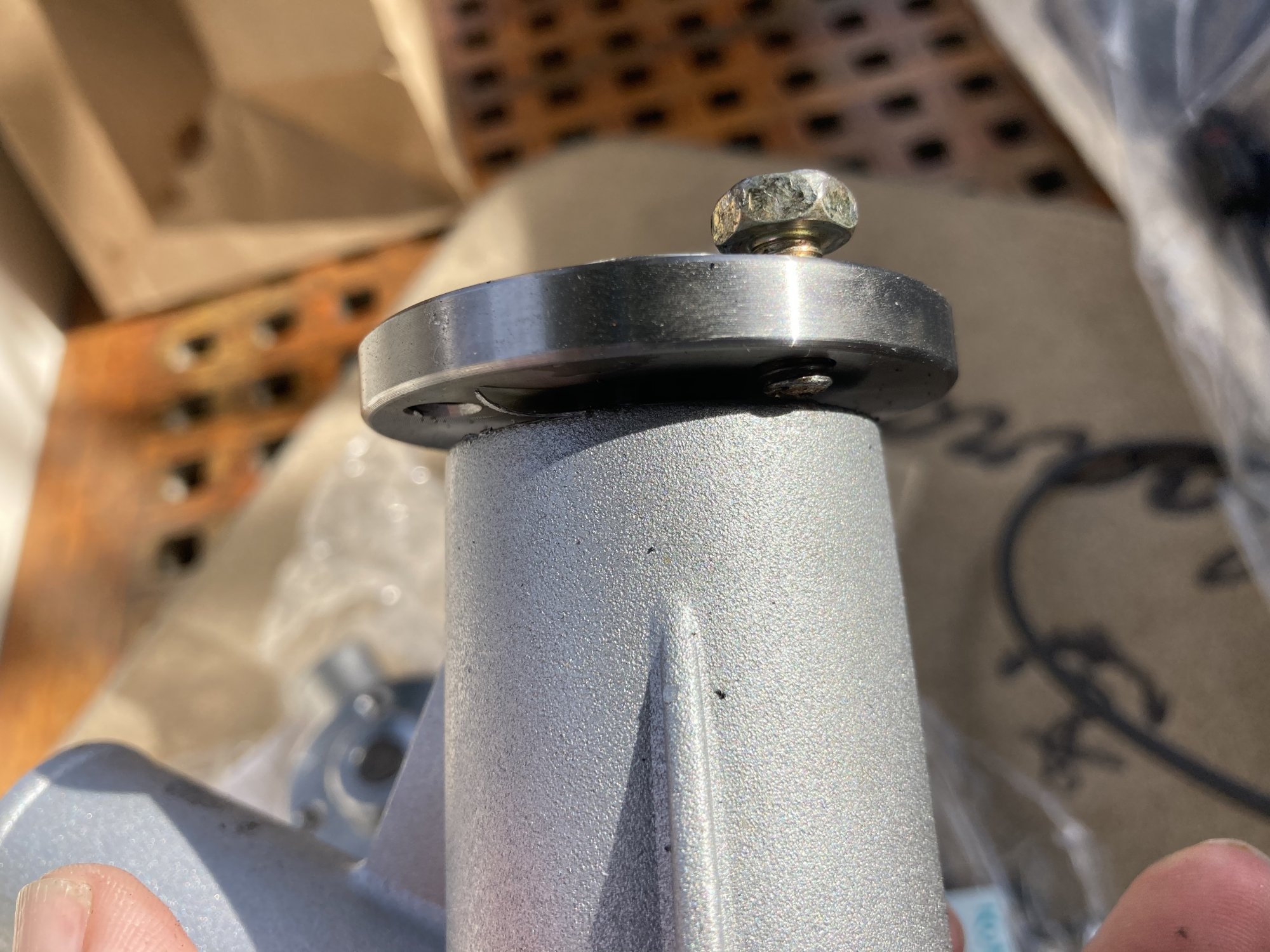

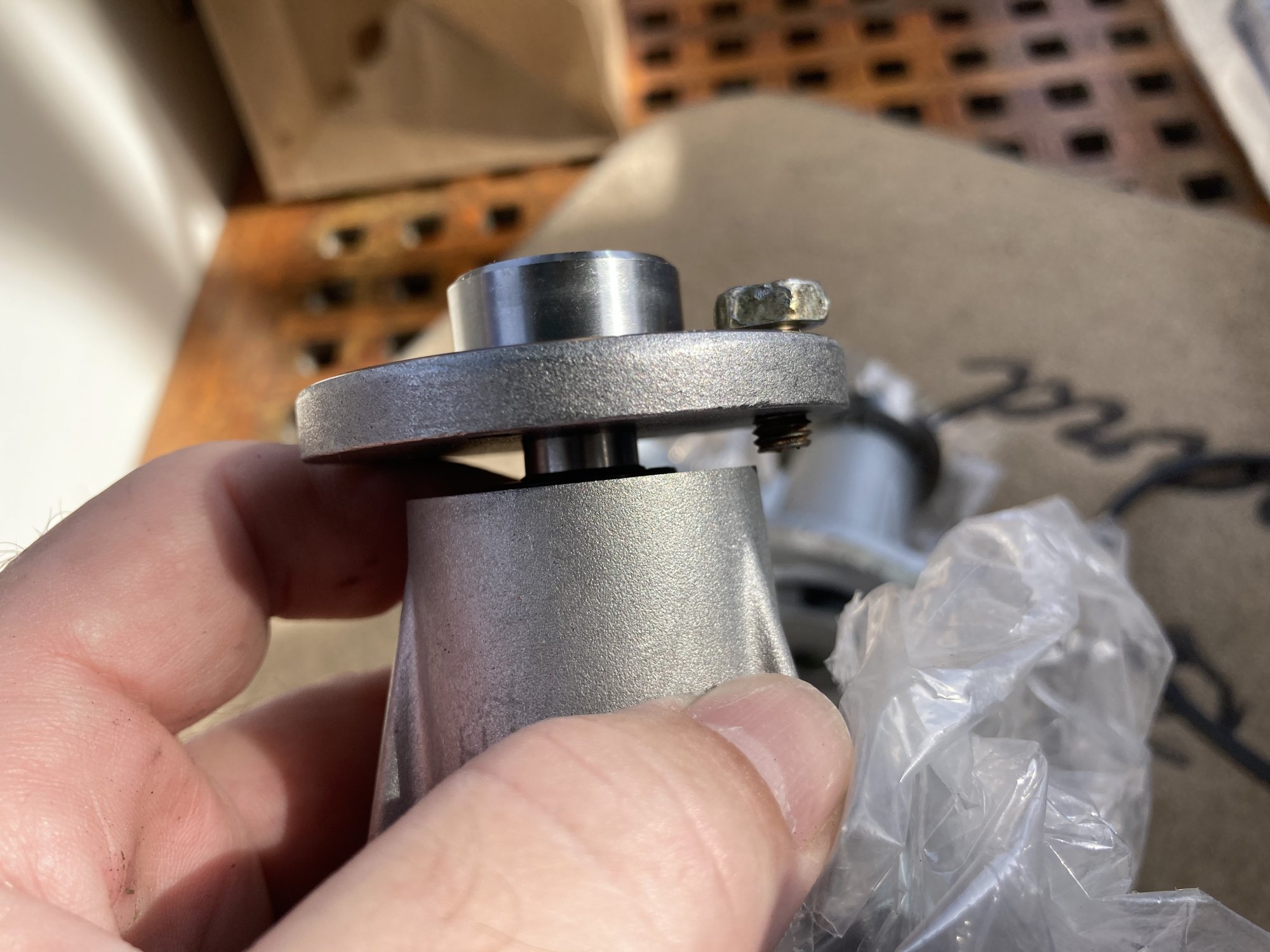

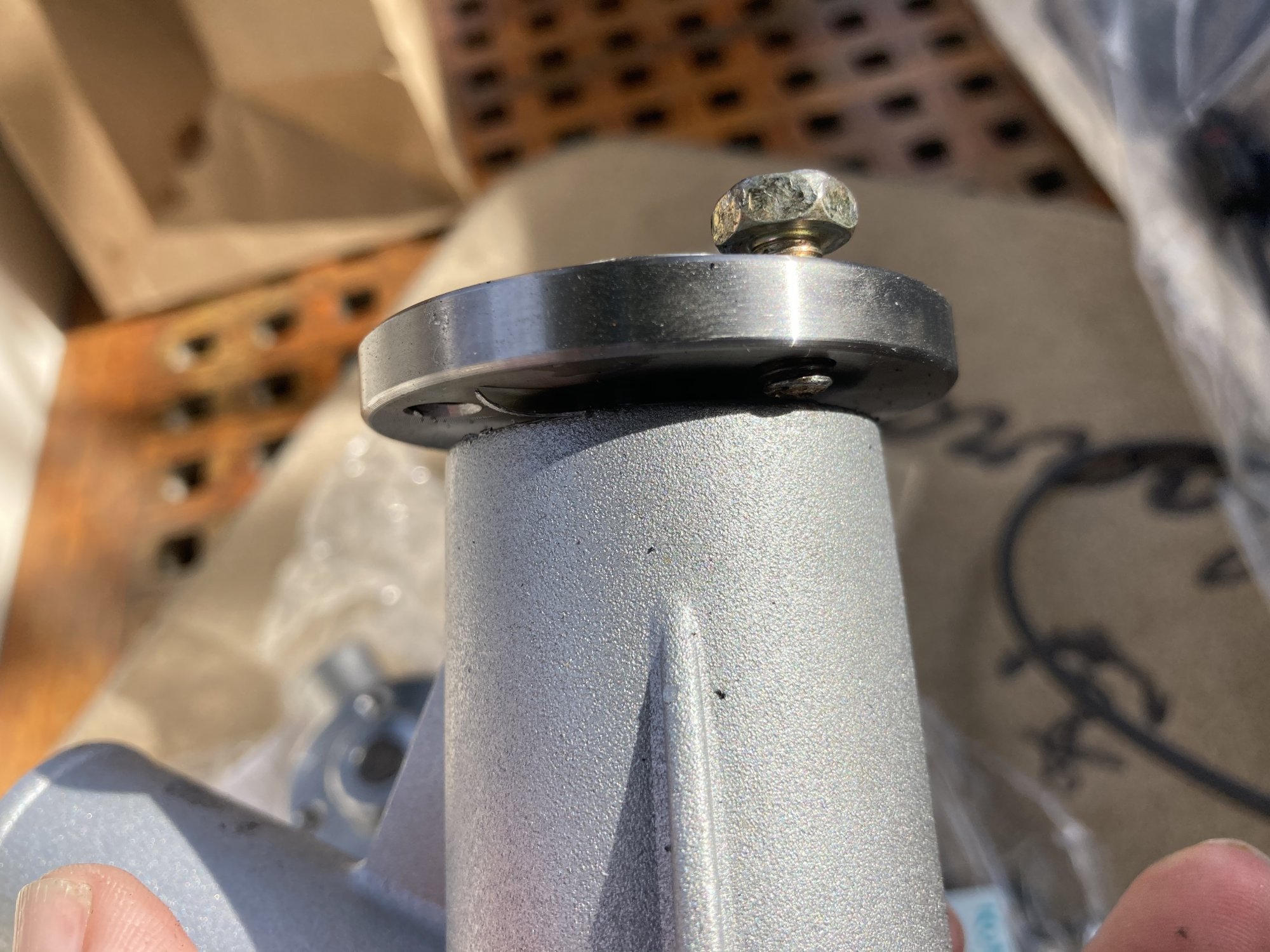

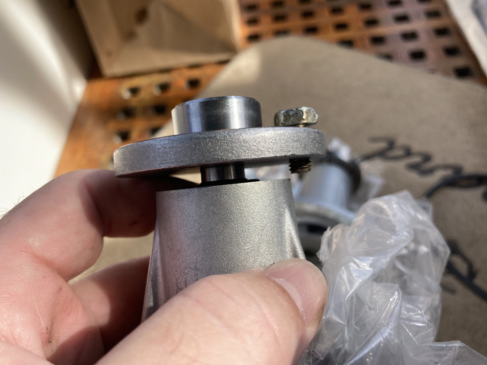

The aftermarket pump that seized in 3 seconds apparently didn’t actually seize on its bearing, it seized on the bolts holding the pulley.
See pics.

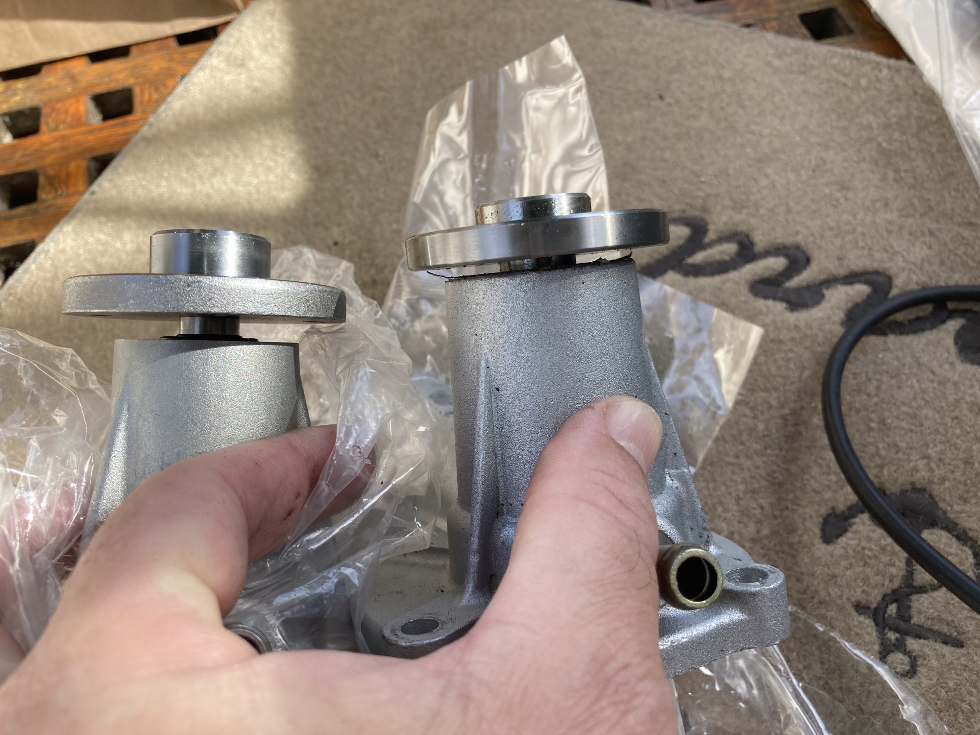

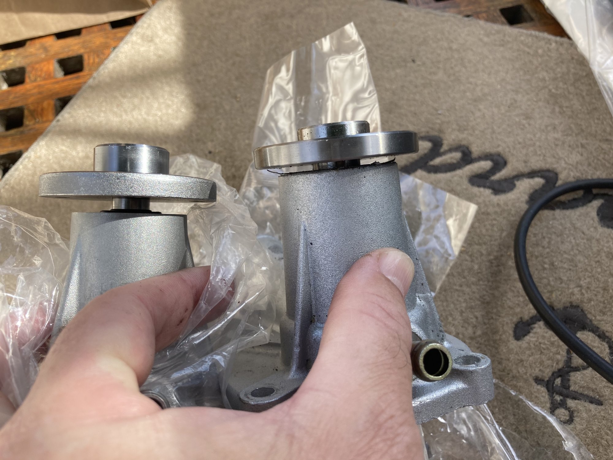

One pic has the new Kubota on the left, with the knock off one on the right. Totally different. Not enough clearance for the original bolts that came with the engine. You can even see metal shavings where the bolts contacted the housing.
I included pics showing one of the bolts in and contacting, and then in the Kubota pump and clearing the housing.
Totally incompatible with existing equipment, unless you know to change out the bolts to shorter ones I guess.
See pics.
