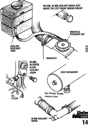

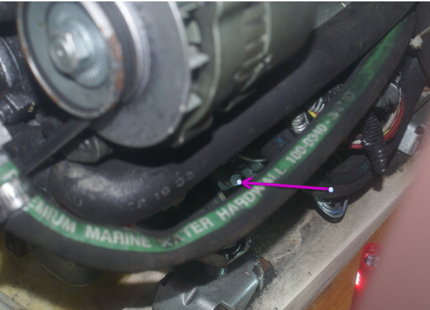

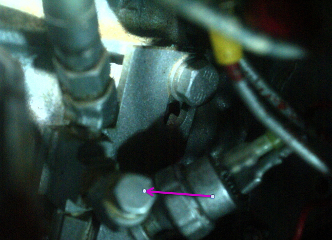

Would one of you C-310 owners let me know if the pictures show the drain? The first picture is the front/port side of the engine. The second is a zoomed in shot of what I think is the drain, located on the port side about an inch below and three inches back of the forward port engine mount. The third is a picture from the manual
If that is the drain, how do you drain it without getting it down into the bilge? There is very little room to work on the port side of the engine and there is no hope of getting a pan under the drain. mUniversal Marine Engine Manual, pub 200550, Feb 10, page 14, shows the coolant drain above and aft of the oil filter, located on the port side of the engine. The drawing in the manual doesn't quite match what is seen in the pictures I've posted.
I really don't want to put a wrench on it and open up the wrong thing.
