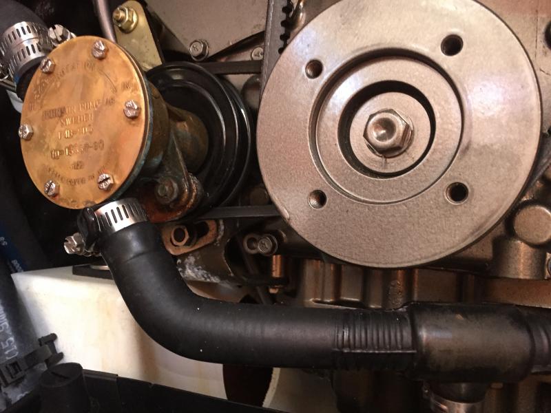

Anyone had issues with their water pump impeller housing dripping from the back side, or the shaft the impeller slides on. Can these be rebuilt.
yep, they can... and yours needs to be if its dripping.Anyone had issues with their water pump impeller housing dripping from the back side, or the shaft the impeller slides on. Can these be rebuilt.
The difference that the euro version of the Yanmar engine uses a Johnson pump. It's the same pump that is used on some Westerbeke engines. The nice thing about the Johnson pump is that instead of a paper gasket between the impeller cover and the pump body. The cover has an O ring groove. The last impeller, which is also different, that I purchased came with two O rings in the package. The impeller has a pin across the inside diameter that engages a notch in the pump shaft.If you mean the shaft seal on the side toward the engine be aware that the seal is different for the Japan and the European "version" of the yanmar 3gm30f. My local yanmar shop had to do some research to get the proper seal for my "YEU" / euro version.
