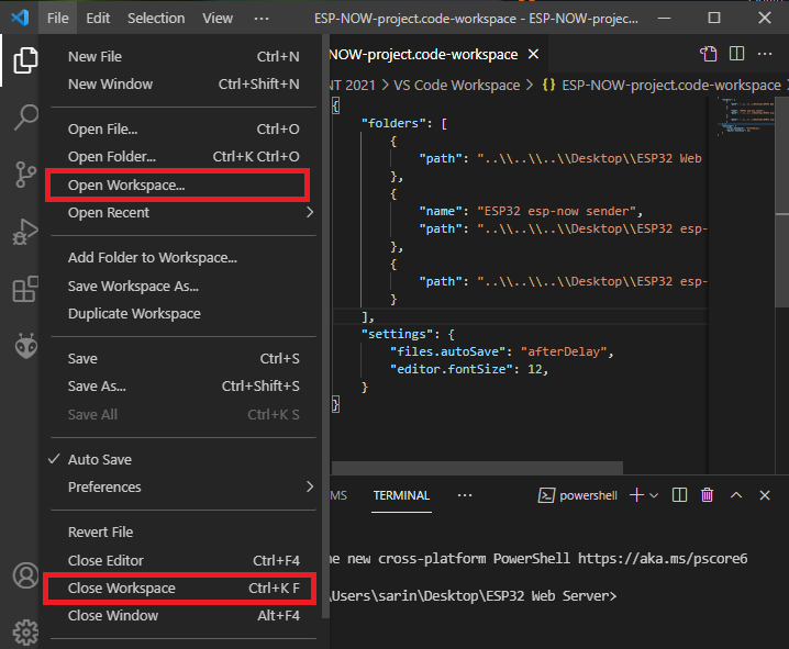

You'll need to install VS Code on your computer to build the code and upload it to the ESP32. After the first load, later code changes can be sent via OTA (wifi) from your computer.

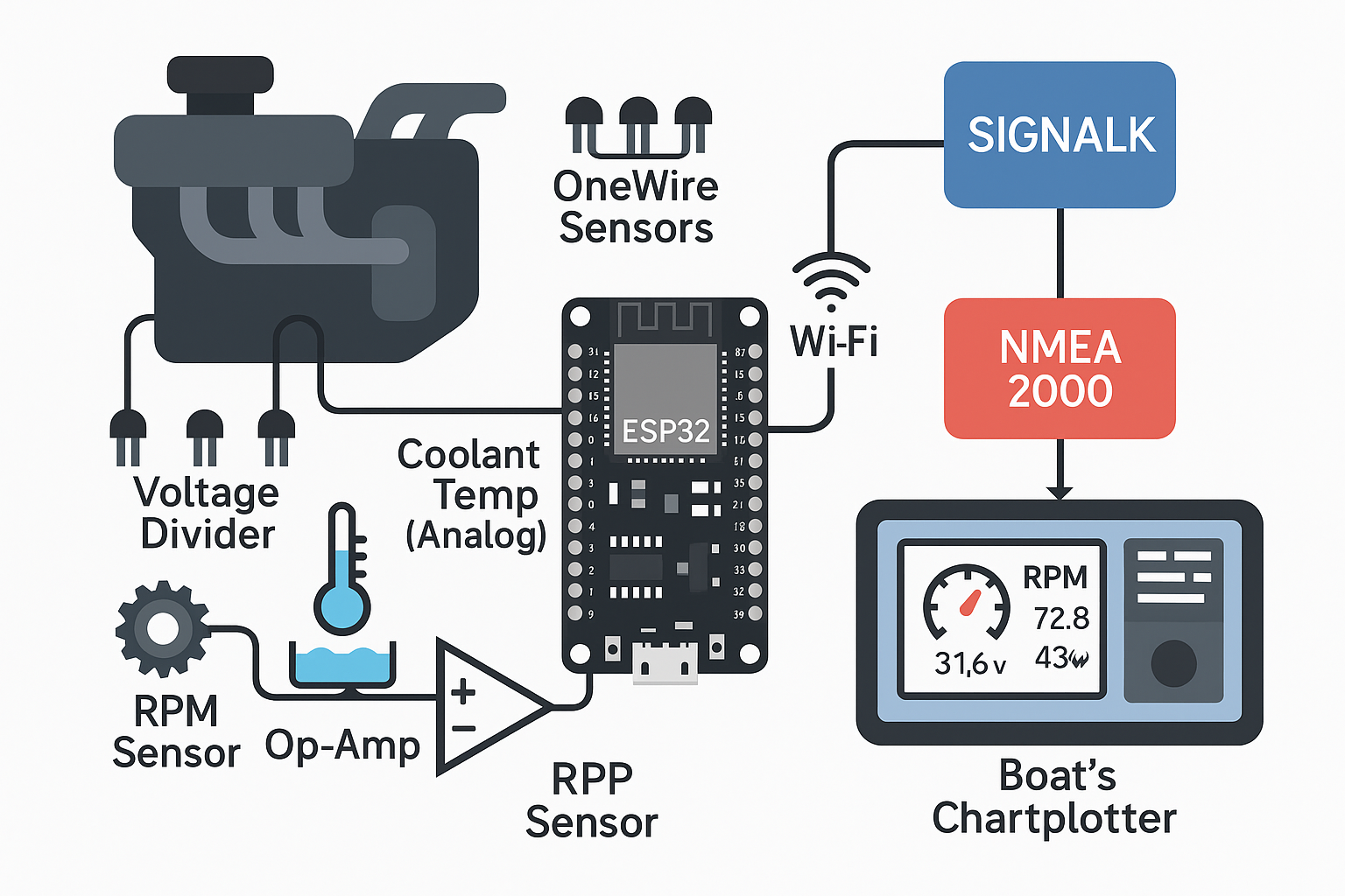

The commercial products I listed in post 1 assume your engine has analogue sensors (temp, pressure) and switches for low oil pressure, high coolant temp.
The code I wrote for the ESP 32 and the hardware sits in between analogue gauges and their respective sensors and "intercepts" the signal, just like the commercial products do.
However, I have not written it as a replacement for gaugues. Nor are my circuits designed to work as replacements for the analog gauges. The coolant temp sender is resistive, the gauge injects voltage and the current passing through the sender determines needle deflection. The RPM sensor produces a high voltage pulse (varies with RPM). Without the load of the RPM gauge, it could cause the digital interface to malfunction.

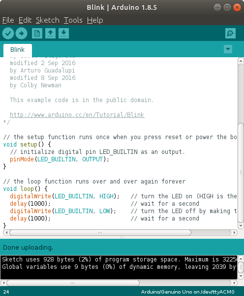

The ESP32 is very approachable to learn (or relearn) to program if you want to customize some features. Basically, we download preexisting code blocks, and either use them as is or tweak as we wish. The development environments can be from basic to very complex. The most approachable one is Arduino IDE. If you`ve ever written turbo pascal, MS VBA, it will seem approachable:
For more complex projects, Microsoft VS Code IDE has a bit more options to leverage, including a built-in AI assistant (debugging, writing functions, etc..).
Chat GPT 5 is excellent to assist with small coding projects. You tell it what you have, what you want to do and it starts spitting out code. When things don`t compile, just give it the error codes and it finds the fault pretty quickly....
If you google ESP32 programming on google, there are hundreds of step by step videos.

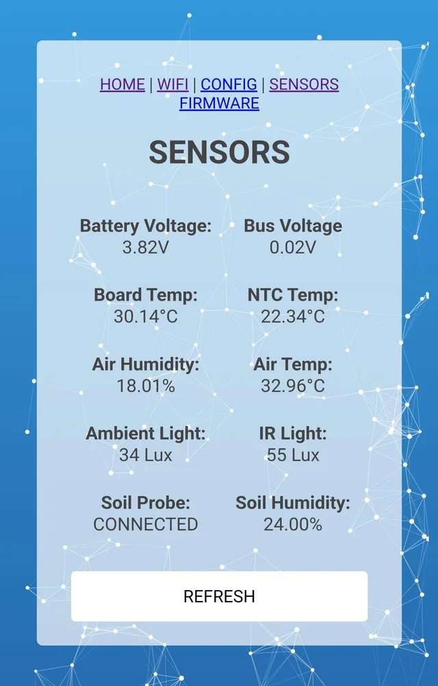

Another option, if you don`t want to send the data to SignalK and then onwards to NMEA2000, is the ESP32 can become a wifi hotspot. You then connect to it with your phone and it can display, via web page, all the data it has access to.
The UI for setting up the ESP32, (passwords), connecting to wifi, etc... is built-in. Nothing really to program except choose what fields to display.
Here`s an example of a simple ESP32 project, with the associated web page:

The code is mostly working, I'm trying to find exceptions that cause faults at this stage and will package the test circuits into a waterproof box now that all the sensors are functional.
1. Senses RPM from magnetic flywheel pickup (gauge must be connected)
2. Senses coolant temp from engine's sender (gauge must be connected)
3. OneWire waterproof sensors for exhaust elbow, engine compartment, etc...
4. Gets STW, SOG, apparent wind from SignalK. Uses this to correct baseseline data of RPM/STW/Fuel Flow (you need to know your baseline speed/fuel data and have a rough estimate of the impact of wind and load (towing a dinghy, extra crew, etc..)
5. Estimates engine Load (%) based on above data and know engine rating curve
6. Sends values to SignalK. SignalK can display web based dashboards OR send the data to NMEA2000/0183 devices
7. Engine hour meter. User can set starting hours to match the engine's analog gaugue
I'll provide screen shots and install photos once I've cleaned up the wiring!

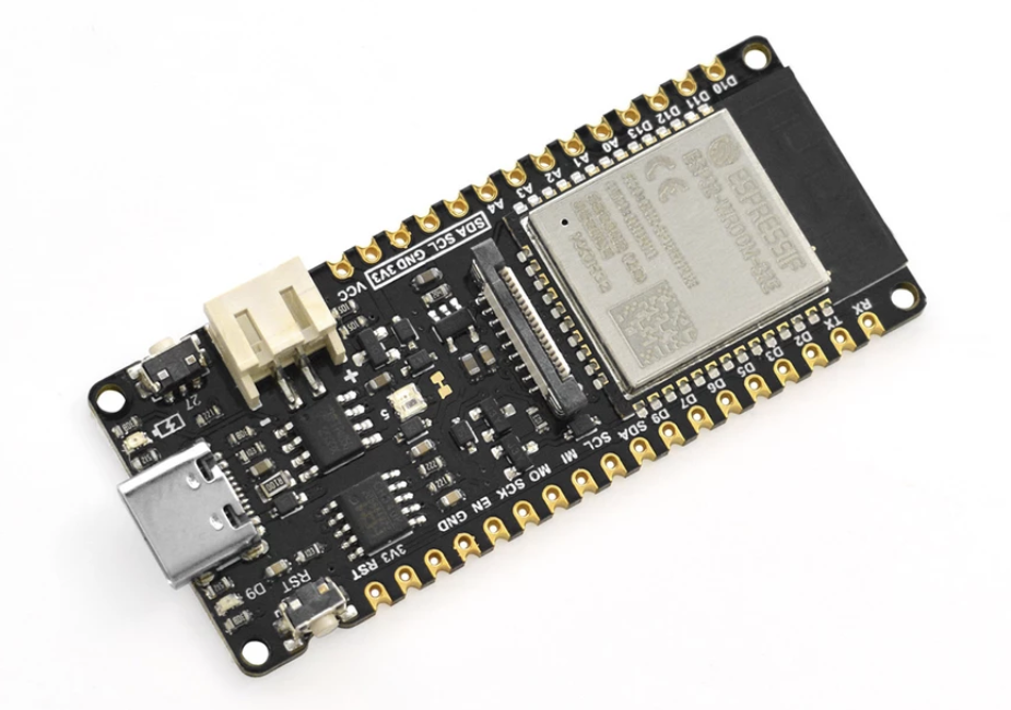

Hardware list:
base hardware:
Unlock Easy Connectivity with Gravity IO Shield! or Enhance Your ESP32-E with the FireBeetle 2 Terminal Block Shield! (optional, makes wiring much easier)
https://www.sparkfun.com/sparkfun-buck-regulator-breakout-5v-ap63357.html or Explore Multi-Voltage Buck Converter for Power Systems
