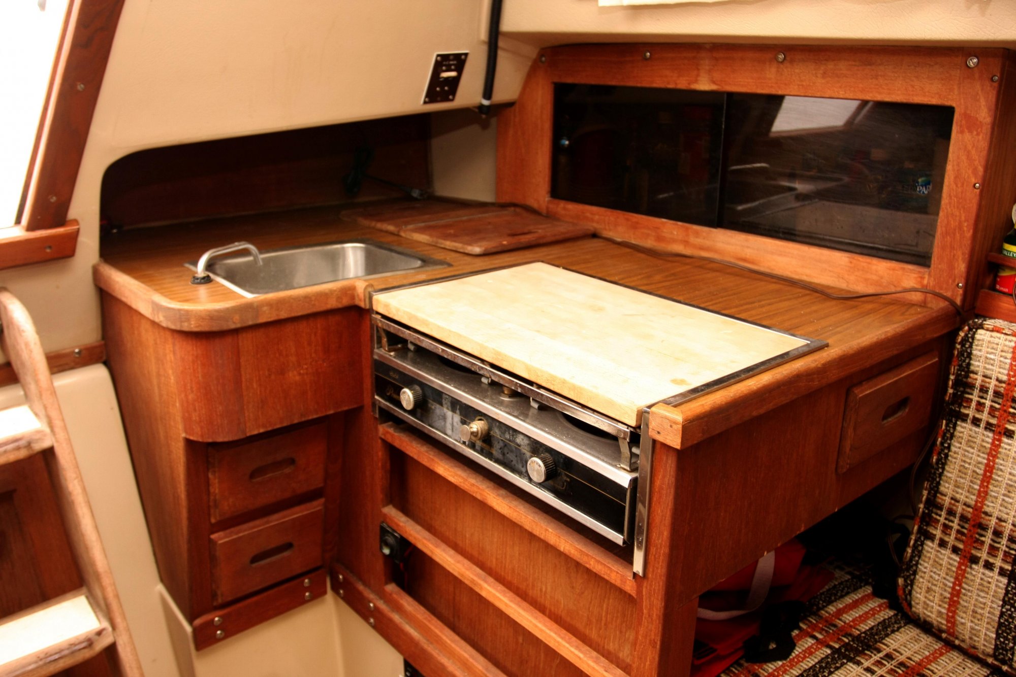

I have a Catalina 27 with a chest cooler in the galley. Would it be possible to take the hardware from a mini fridge (motor, coils, etc) and turn my chest cooler into a fridge? Marine refrigerators are $700-900 and I was looking for an alternative.
The boat is kept docked with shore power and only taken out for a few hours at a time.
What are the possible negative outcomes of doing this?
I realize household refrigerators are meant to be kept upright too.
