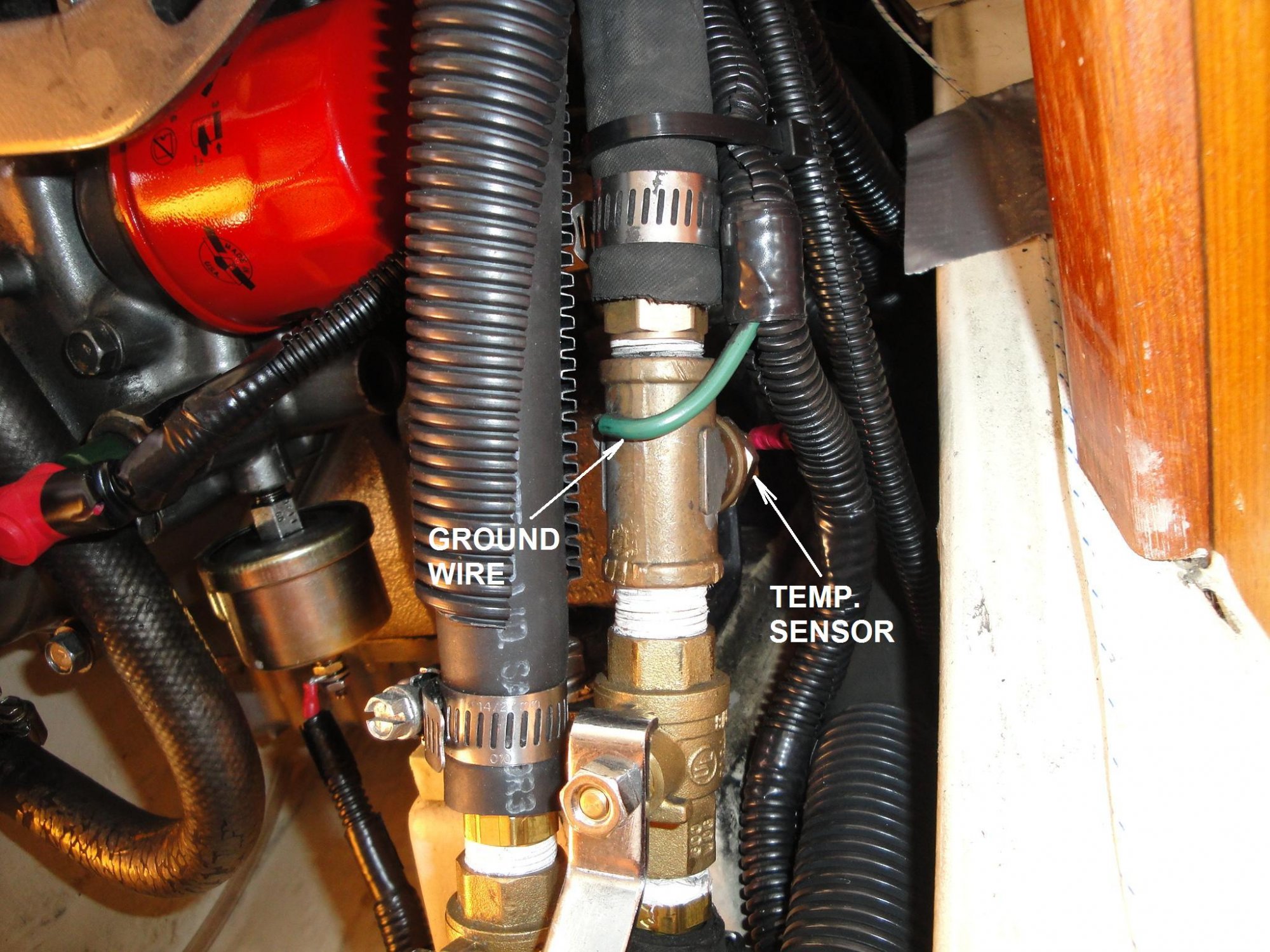

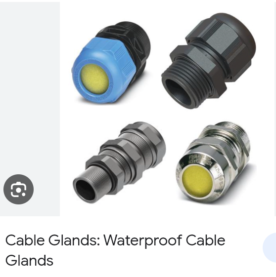

This is really not as bad as you might think. I managed to go down through the bottom of the binnacle with a waterproof cable gland to ensure no water got through to the ceiling liner below.
From there just followed through to a good sensing point. None on the engine so I used one of the engine coolant hoses to the hot water tank. Because it's in a non conducting hose, you have to make up the ground.

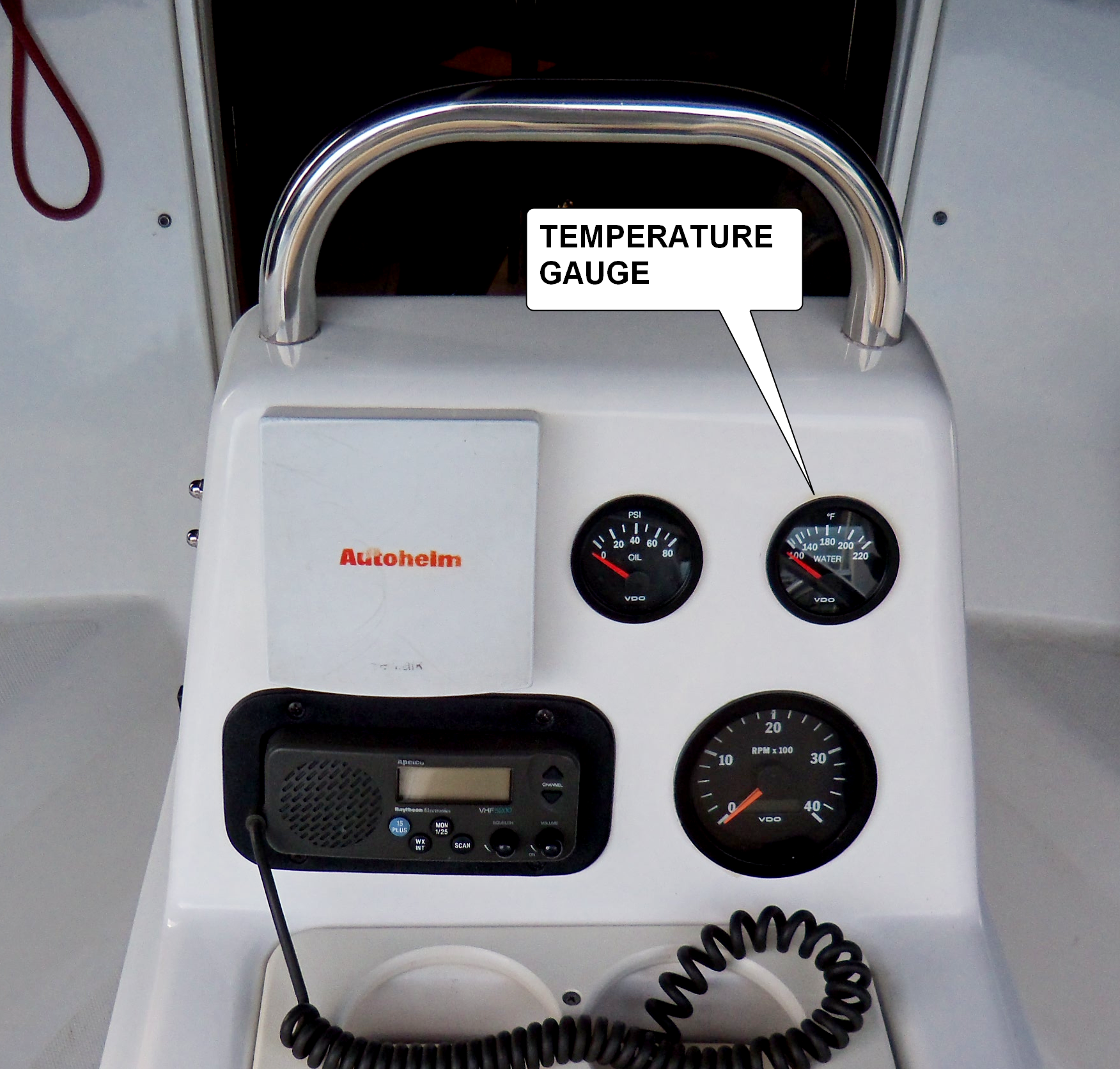

  2. Gauge, the instrument that displays the temperature, you will need to acquire and install this on your panel. They have certain requirements as to signal they receive from the sensor installed on your engine
  3. Sensor, you will need to acquire and install a temp sensor on the engine or in a hose that contains the coolant from the engine (as Ralph indicates). On engine sensors provide more accurate indication of the engine temperature.

With all the food for thought you've provided, you got me thinking that if I do indeed use the wiring to the warning light to put a gauge on the instrument panel, I should install an idiot light on the binnacle next to my chart plotter, which is an area I do look at regularly. The cable path from there to the engine compartment is much easier than from the starboard coaming.
