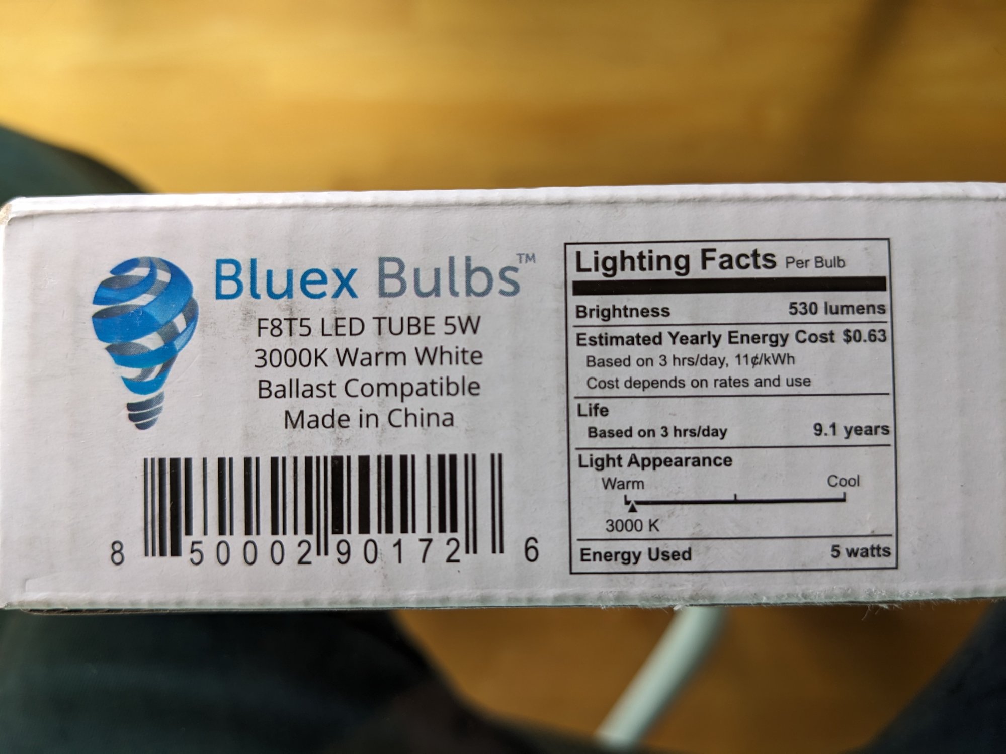

Hunter 36 San Diego
2005 H36. My ballasts work just fine and the fixture was more complicated than some, so I just bought these LED replacement bulbs online. Initial reaction is that the light is great and the power consumption is reduced by about 60%. They were $20 for 4 of them, so pretty affordable. Now I will just have to see about durability in the marine environment!
