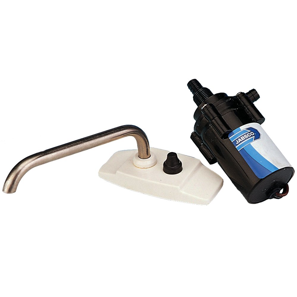

I put a platform to install the pump on close to the tank, under the v-berth. Cleaned a spot and a little to make the epoxy stick, glassed in a small piece of plywood. Picture 1, 2.
