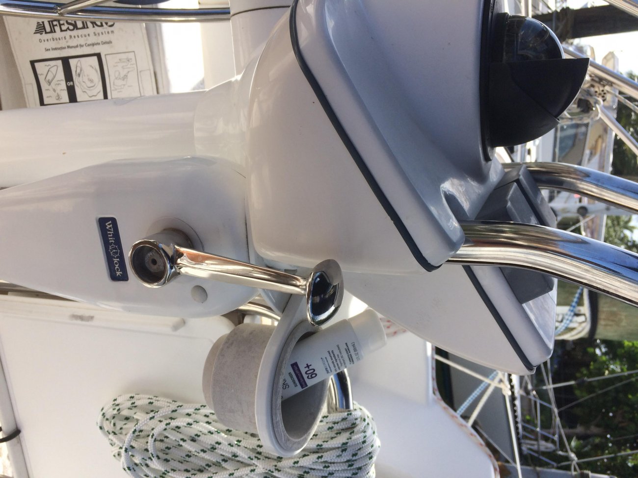

This is a 2003 Hunter 306. Can you please look at this picture and tell me how to disengage the transmission to increase the throttle. I did look for any release. I did try to pull out laterally. it appears like there is something mission over the control lever attachment nut.
It is. That is a Lewmar single handle engine control. I've have one now and have had 3 others, all slightly different but the same idea. It is missing the neutral plunger, and it's covering cap.
The single-lever Spinlock controls press-for-neutral as your describe.

jack do you believe this will work. found online. tom
Lewmar Morse Button-Plunger Kit
LEW89800013
$ 34.00
ll work
LEW89800013 it is just rubber boot, glue and the mushroom plunger. tom

This mushroom plunger with rubber cap drops easily. I got a friend to machine couple spares piece for just in case.

i just ordered one for 34.00 with plunger, boot, even glue. thank you for all.
