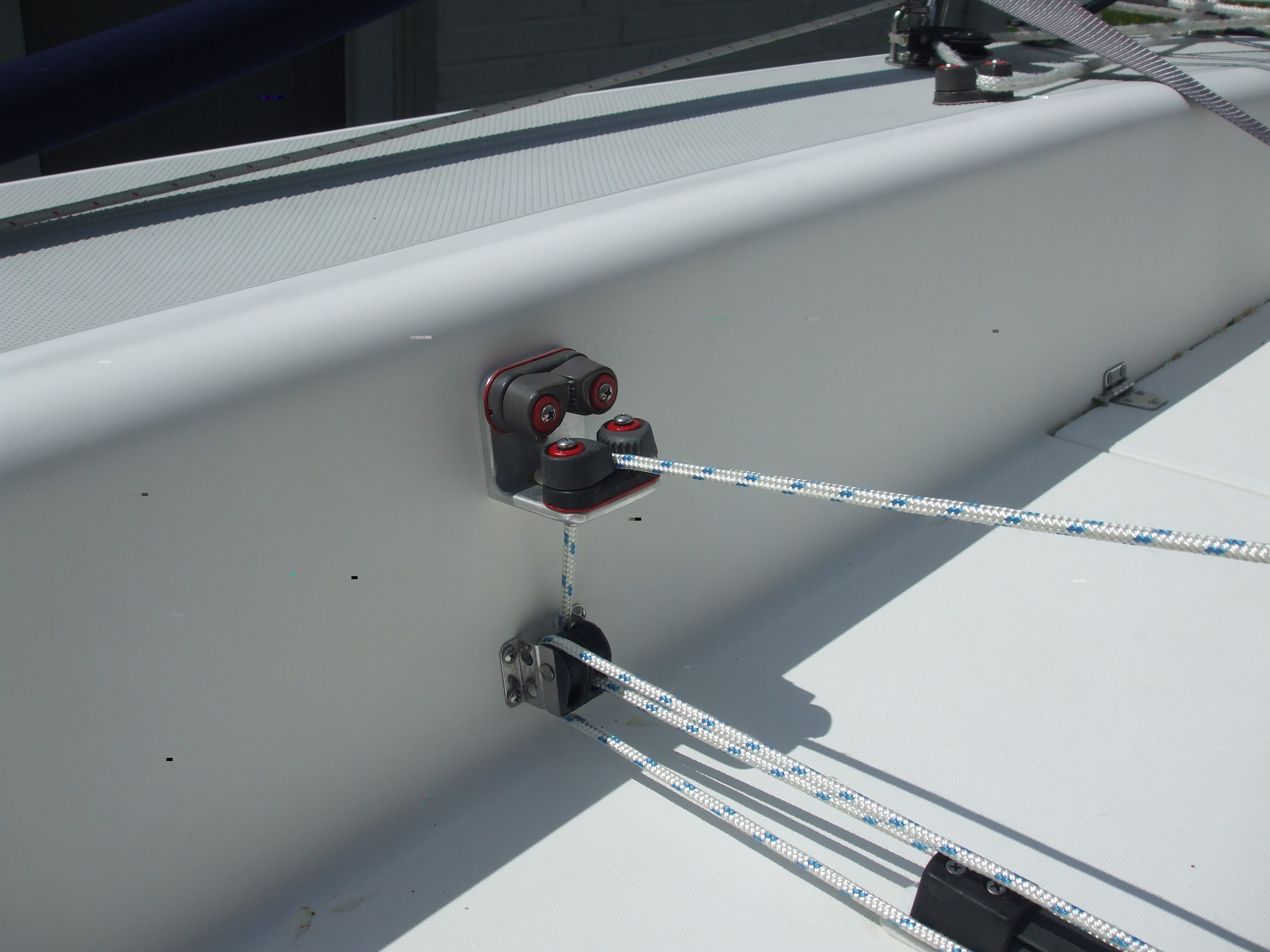

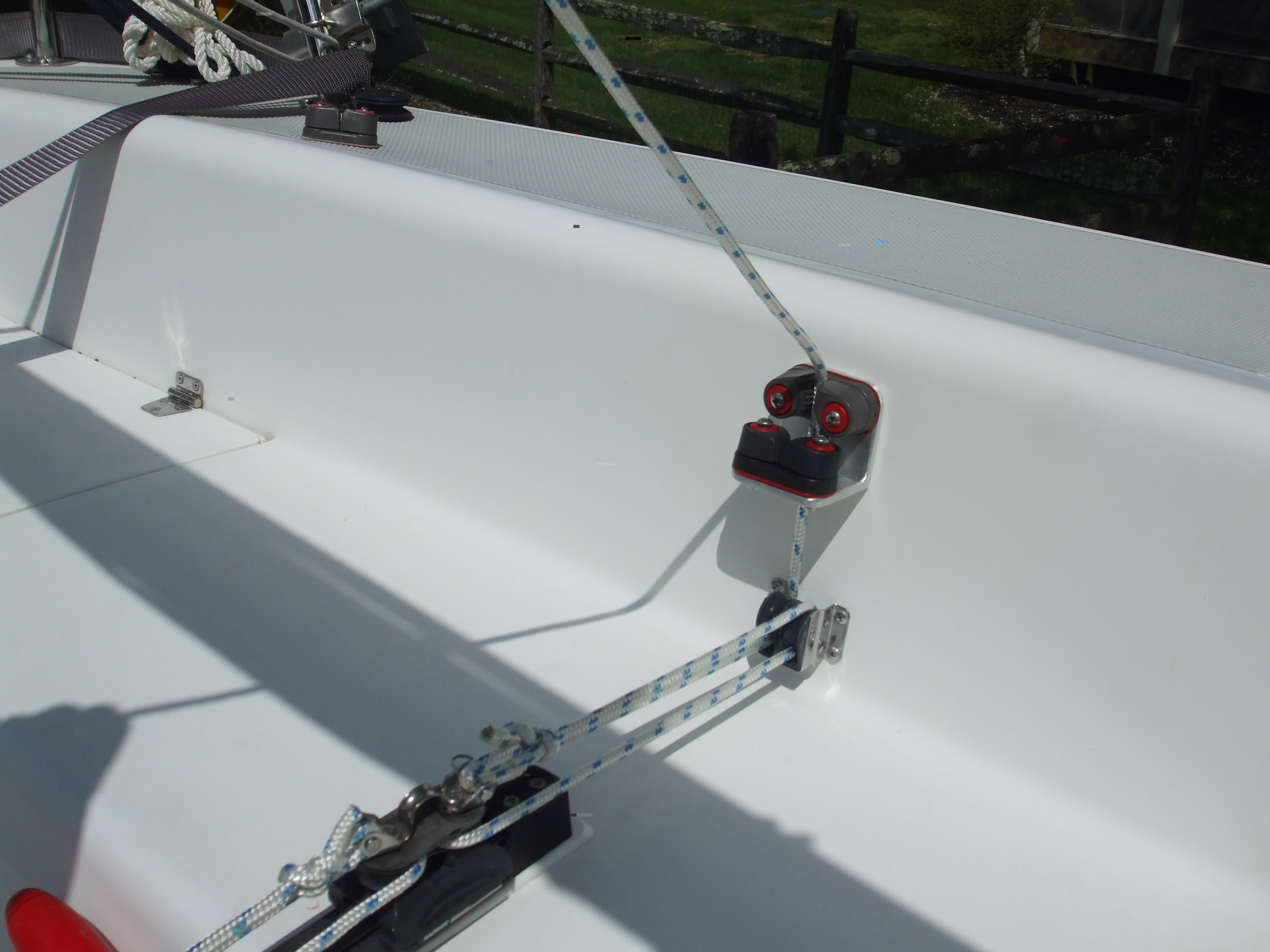

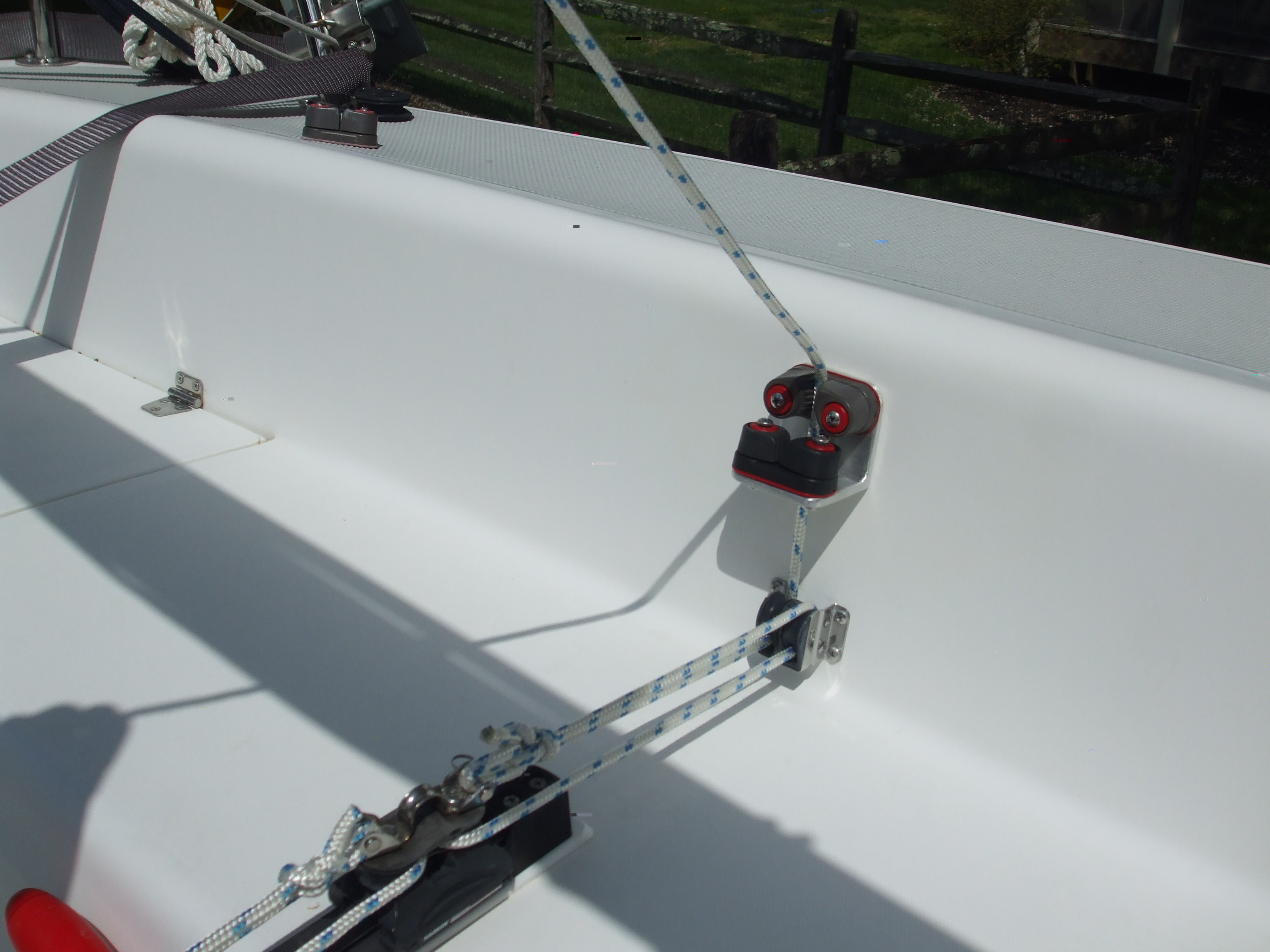

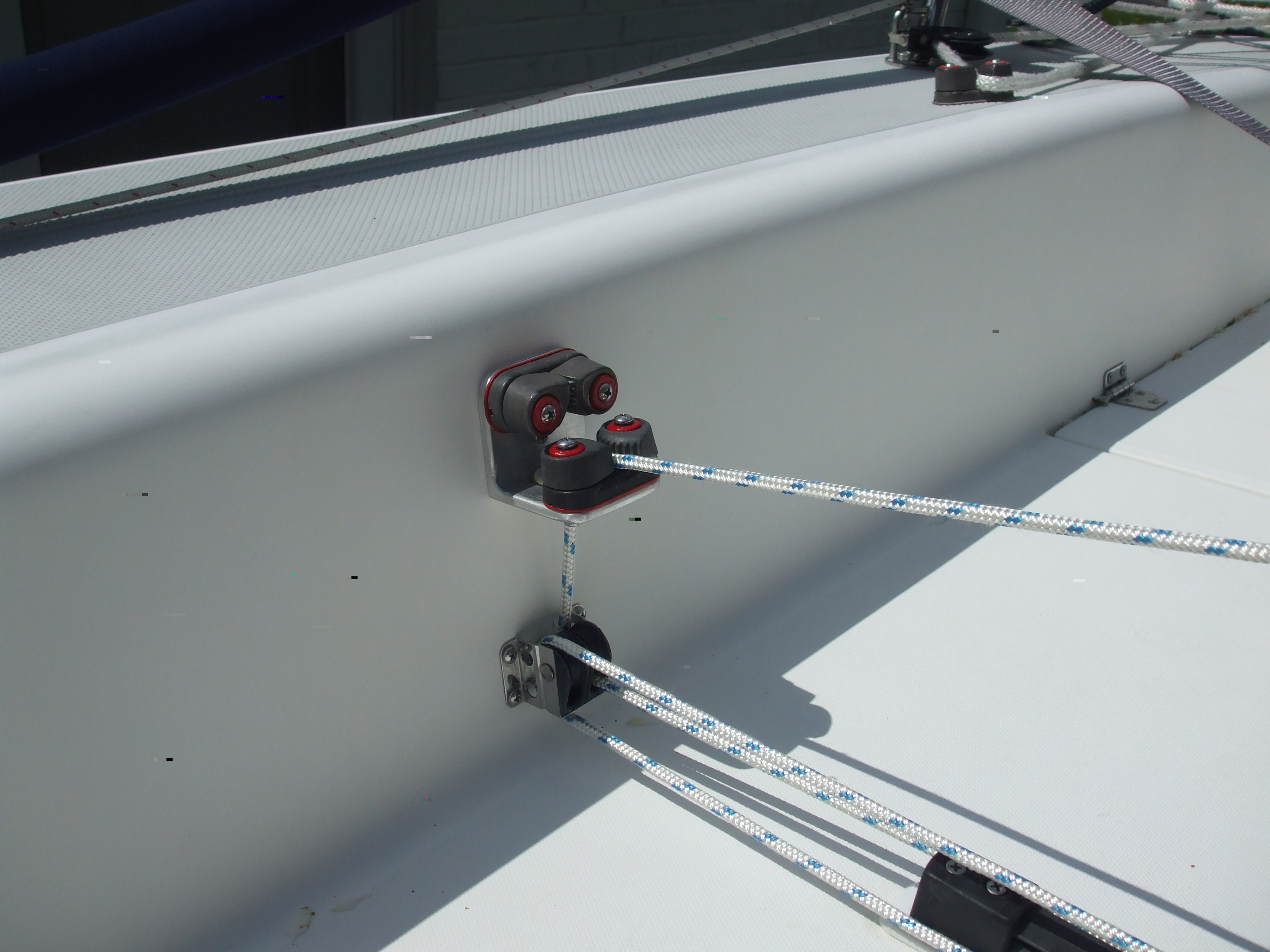

This is a follow up to a previous Post of mine on the topic, now shown installed. This Traveller set-up uses a "Continual Line" to operate the Traveller and utilizes double Cam Cleats on each side, one horizontal/one vertical. I understand both J22 and Megels use this system! I found it fairly expensive, to purchase the parts, so I made my own brackets. The big benefit of this system is you can cleat/uncleat either side of the Traveller from one side using the "Continual Line." Note, the Port Side using the vertical cleat, while the Starboard Side uses the Horizontal Cleat.
