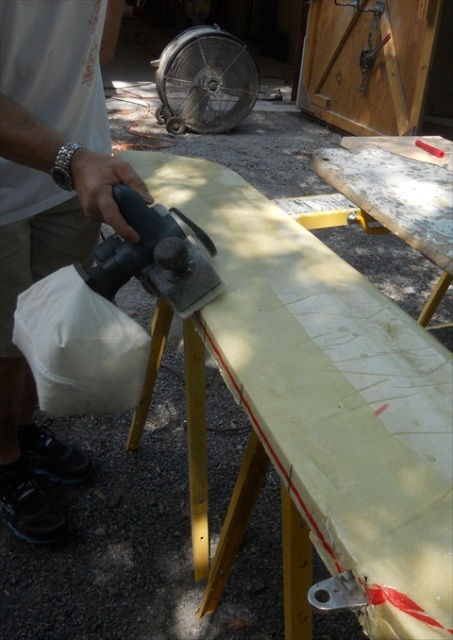

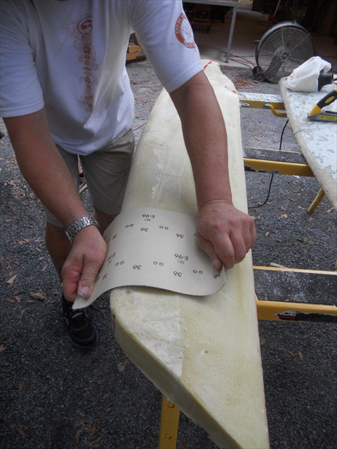

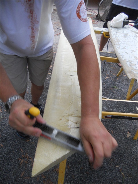

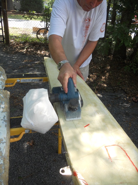

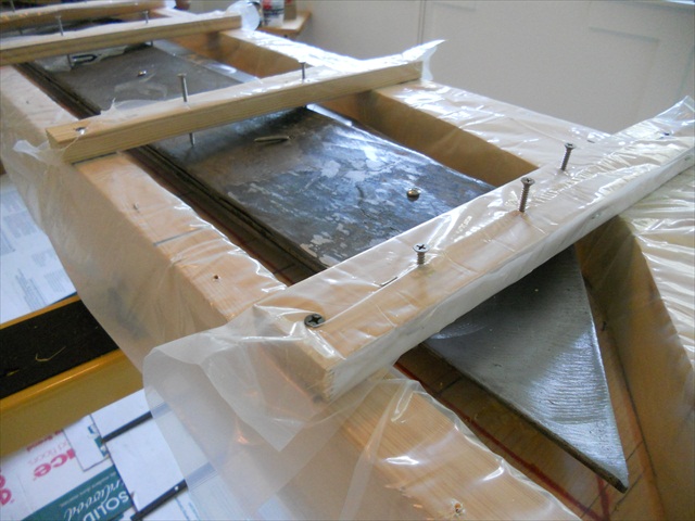

There are many of us who are trying to maintain or refit an old boat that would otherwise be lost to time. For everyone out there who is facing the necessity of replacing an old and worn centerboard, I thought it would be helpful to share with you everything I learned in the construction of a new centerboard for my Ericson 25. I destroyed my old board and reverse-engineered it to build the new one. The building of the new one involved making a mold, filling it with pour foam, and then shaping the foam into a foil shape before applying the kevlar, biax, xynole, and 10 ounce cloth. It was a big project, but, in the end, a satisfying one.
