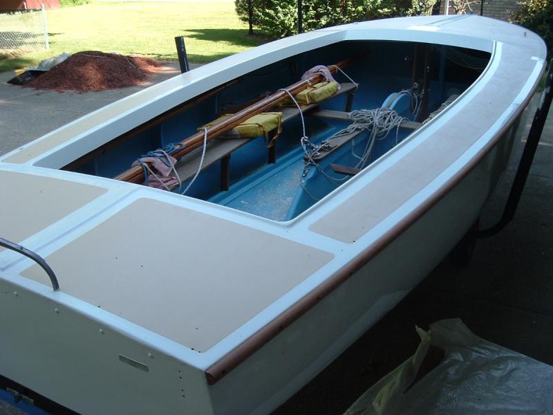

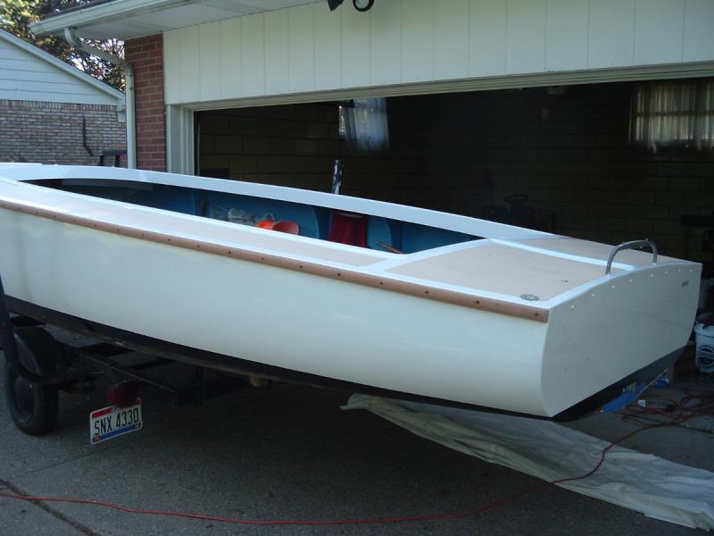

Should also have mentioned that I did paint a boat. I rolled and tipped my Highlander using Brightside. Its alright but I want my big boat to be perfect. I also used to maintain a Catalina 22. With three bottoms to paint in the spring you can begin to see why I am tired.

Did not mean to suggest I would use Brightside. Just happened to have some for the old 1968 one-design. I just finished a mast in Perfection so am well aware of the difference. And I have done gelcoat repair with good results. Like I said, just tired. Still leaning toward a professional spray job.

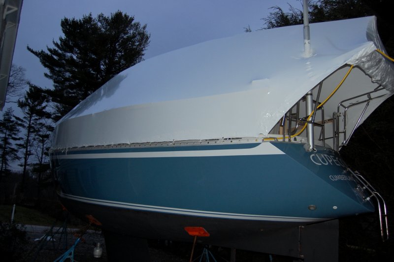

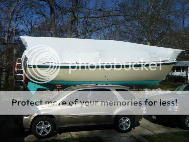

the 'downsides' of painting is that the boat cannot be covered' (especially with shrink-wrap, etc.) ever again without a good risk of the paint 'lifting' under the cover. No topside paint can withstand such 'high humidty' conditions without 'risk'.
Rich is correct however painted boats CAN be covered with shrink wrap. It has to be done correctly and you need a shrink wrapper who has a clue how to do it...
Ideally I would love a Canvas cover but can't get anyone, including Fairclough, who thinks they can build one like this. I won't even let canvas touch our topsides...
RichH
Feb 14, 2005
4,773
THATS the way to shrinkwrap a painted boat ... the ONLY way. If the shrinkwrap 'touches' the paint the forming/condensing moisture (and NO matter how well 'vented' the shrinkwrap is) will cause the paint to lift !!!!!! Got the teeshirt ... got the shoulder bursitis from the 'rework'.
Tim R.
May 27, 2004
3,626
Not that hard. I do it every year. My boat is not painted. I do it for air circulation. Not a drop moisture under the cover.
