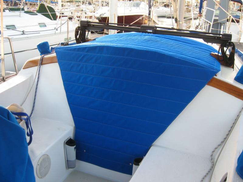

I sewed up a cover out of Sunbrella, and put about 4 pounds of lead shot in a pocket on the bottom. The weight pulls the cover tight and doesn't let the cover blow around. Be sure to cut the material to the correct rounded shape!
Attached is a picture of my cover shortly after I made it, while I was still rehabbing my boat.
Joe
Jun 1, 2004
8,323
I'm not sure I'd want a canvas sling with 4 pounds of lead flying around....I didn't say it was bad, just that I'm not sure.....
Most people use sometype of stainless or nylon fastener.... here's some examples on the boat canvas supplies site You might take a look at Sumner Patterson's web pages... he and his wife did a lot of canvas work.... but what you're looking for is pretty common. I had snaps on my cover, but will convert to the directional type when I replace it....

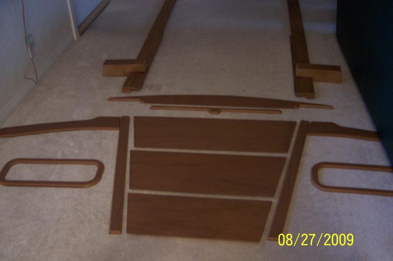

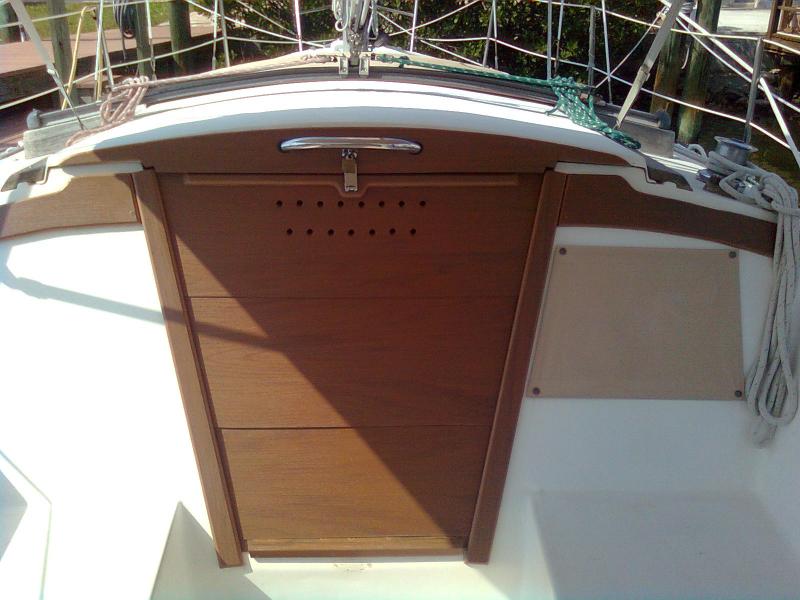

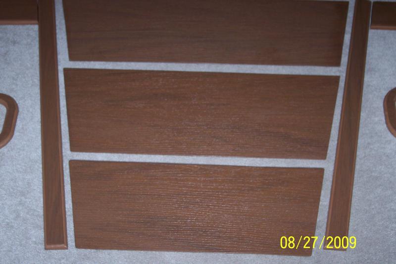

Was up pal? I always had a problem with water thru my companion slats. The problem was from the orig. design.
Rain came in thru down from the top hatch spaces to the boards. Another was the louvers angle. Another was the foot step area.
When I re-did the wood with the Sensibuilt faux wood product, I made as close as possible fit up cutting down on spaces where the water intruded. I also redid the foot plate where a lot of water came in.
Putting a cover on is questionable in that a lot of water flows down from the top hatch. How would you seal this? Another problem is that you won't be able to vent as much moisture from inside the boat. Hence mildew buildup.
Temperature changes will cause moisture buildup in your cabin. So unless you have a vent on top somewhere, you may find that you create another problem.
I know some will disagree, but there's never ONLY one way to fix a problem Sunbrella will breathe somewhat, but how much? Here's a pic of the new slats for reference. the fit up is much tighter than the orig. design
Good luck finding a solution. I don't get much water on the floor, but if it blows hard from the stern, I still get some.

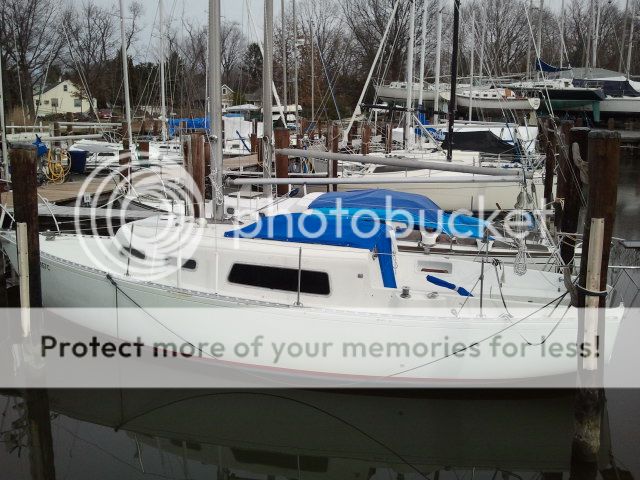

I made something out of Sunbrealla to cover my bright-finished hatch-boards and wooden handrails on the cabin-top -- after all the time I spent stripping, sanding and varnishing them, I don't want to be doing that every two years!
Unfortunately this is the best pic I have of the setup. It's actually two pieces; one covers the cabin-top and the other covers the hatch-boards. Velcro holds them together where they meet at the edge of the hatch. It's held on by about 12 snaps around the perimeter.

The new companion way boards look nice.... Have you thought about making companion way doors out of the same material? Put them on with removable hinges so that the doors can be stored below while sailing. Mine are on hinges just outside the track for the existing boards so boards can still slide in place without having to removing doors if I needed but since I got the doors the hatch boards have not been brought out of aft cabin for any use for a good 5 years now. The doors get taken below only when out in rough weather sailing with cluts crew on board. The insulted sunbrella hatch cover then get used to cover the companion way If the need arises to keep spray out of the cabin. The lead weights sewn in at the bottom of hatch cover makes it easy to roll up cover and let it rest on top of companion way when sailing.

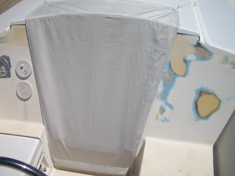

Bad,
I made up this cover with two layers of Sunbrella and in the middle is a layer of that radiant barrior / bubble wrap material you can get at Home Depot by the roll. I like the rigidity and padded look that it gives to the covers, it's easily sewn through, it adds an insulating property (I'm trying to hide from the heat here in Texas) and it doesn't mildew.
