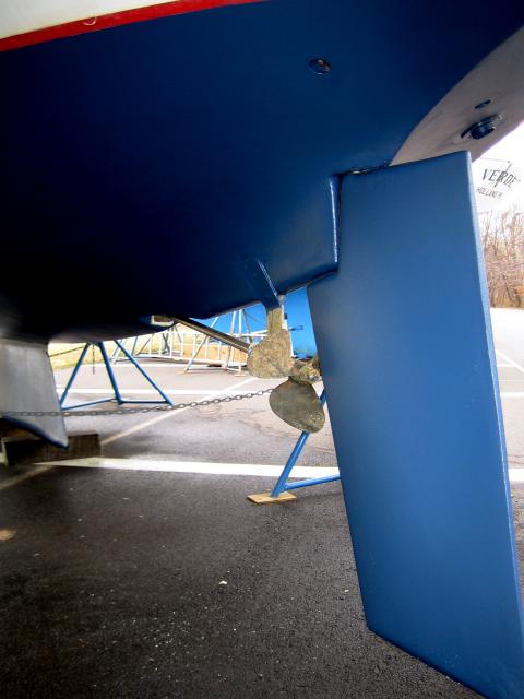

In your photo in your new topic, why is the strut covered up?
Also just occurred to me: many of us sail with fixed three blade props, and do OK. So save some $$ and time for when you fix your engine and leave the prop right where it is.

Stu - regarding the strut being covered, that picture was taken the first year I had the boat and painted the bottom. I didn't know at the time that the strut wasn't supposed to be bottom painted (I saw a lot of the boats at the marina had painted struts). The next year I removed it.
