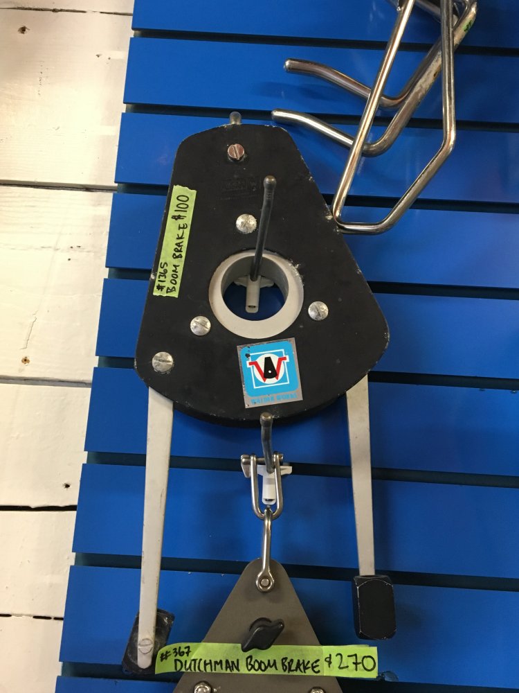

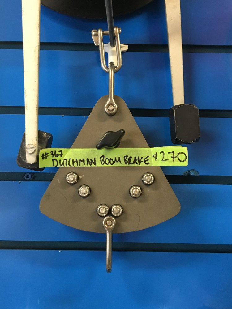

24,799
Wile exploring the Consignment shop in Poulsbo WA, I found these to boom brakes for sale.
F78A025E-2B9B-42B8-BC06-3A70ABCDD9CE.jpeg 6BDE6DE6-89BF-4E6C-9C7D-7D9C7F863E7A.jpeg
