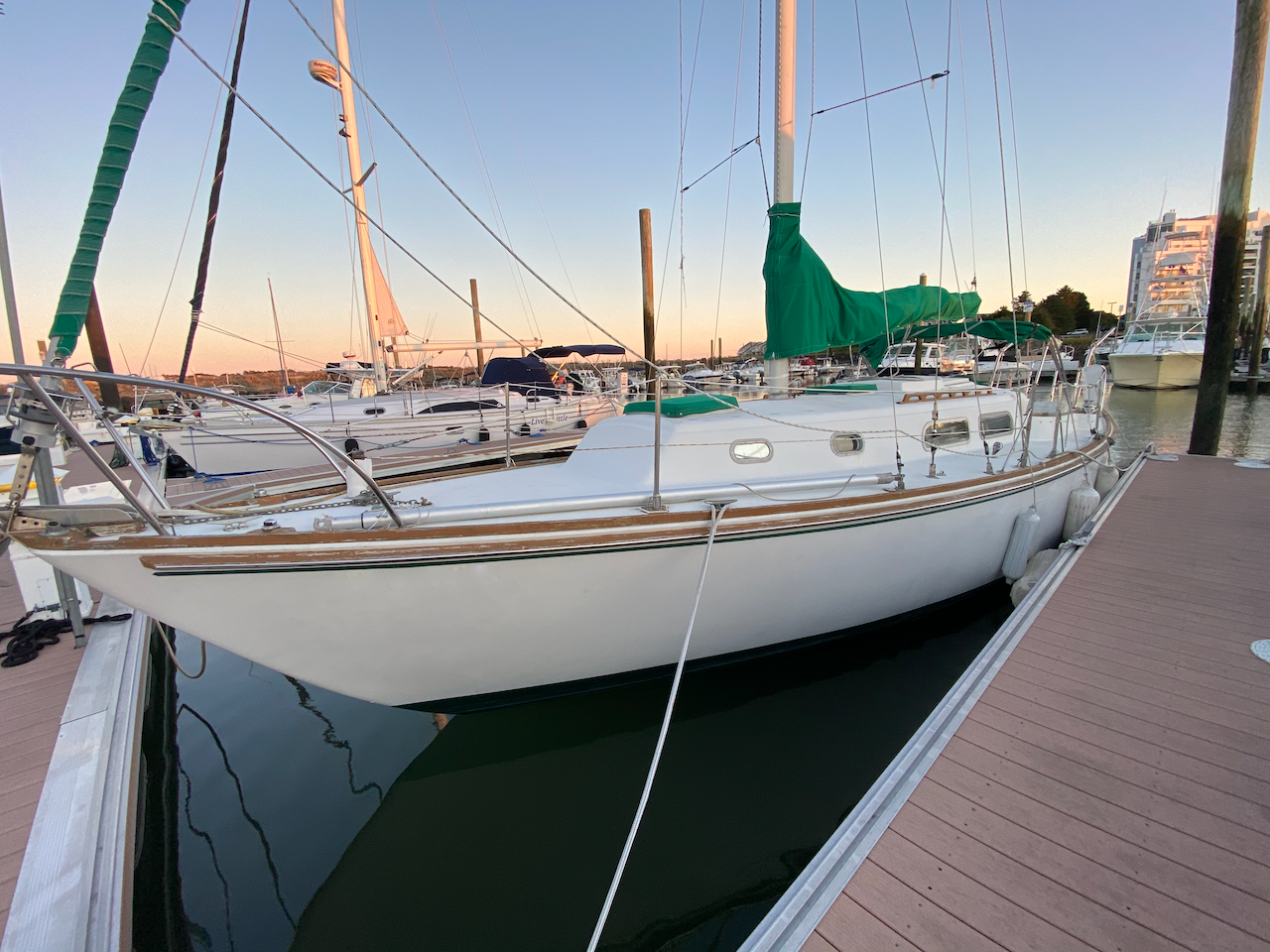

Hi all,
My wife and I are continuing our search for our first sailboat, and are lining up a second viewing / test sail of a 1974 Pearson 35. She's listed here: 1974 Pearson 35 Cruising Sailboat - 2nd PRICE DROP - boats - by...

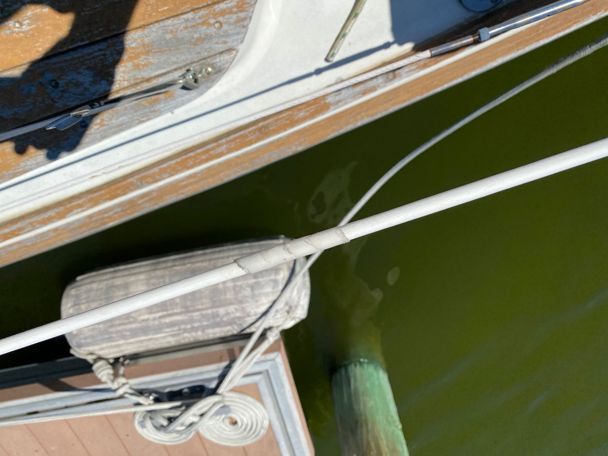

We noticed some issues with the brightwork, much of which looks rotted, as if it will need to be completely replaced:
The rigging, lifelines, and sails are all a bit long in the tooth, and she doesn't have a dodger, only a bimini. Otherwise, she appears to be in comparatively good shape.
Otherwise, I see no major issues as of our first review. That said: I'm new to this. :)
Is there anything specific we should be considering/looking at here? The current owner is an EE, and the wiring looks to be very well done; we'd be looking at some systems upgrades over time, but hope to negotiate the price down to around $10k. There is a survey from 2018, albeit one the seller provided, with no issues listed.

And, while some of the teak looks bad, most of the toe rail might just need a good sanding
and a few coats of varnish. It appears the current owner opted for paint stain in hopes of avoiding the joy of outside teak maintenance. :yikes: :banghead:

The teak brightwork just looks like it needs to be refinished... that old stuff peeling off looks like Cetol. Good weekend project. No biggie. Teak is very resistant to rotting... a lot of people do NOT finish their exterior teak, preferring the grey, patina look. What ever you decide refinishing it is a somewhat satisfying project because it makes the boat look so much better. FWIW, I quit using Cetol 15 years ago, now use Min-Was Spar Urethane. Runs about $17/quart which enough to do entire boat multiple seasons.

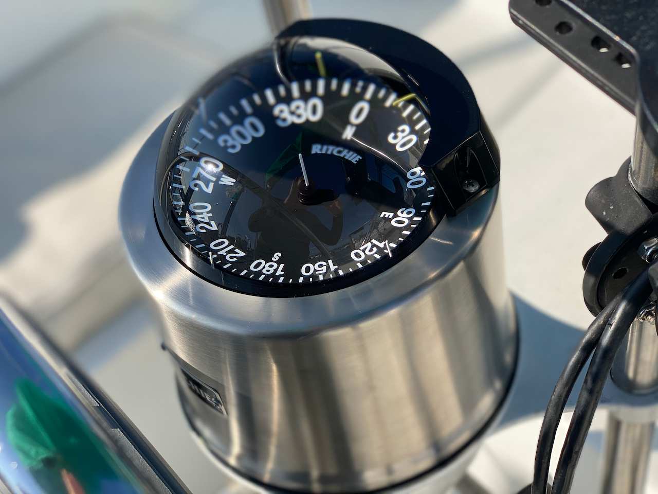

I've replaced the binnacle compass already, and in doing so removed the wire-nut connected lighting for the old compass with properly crimped wires.

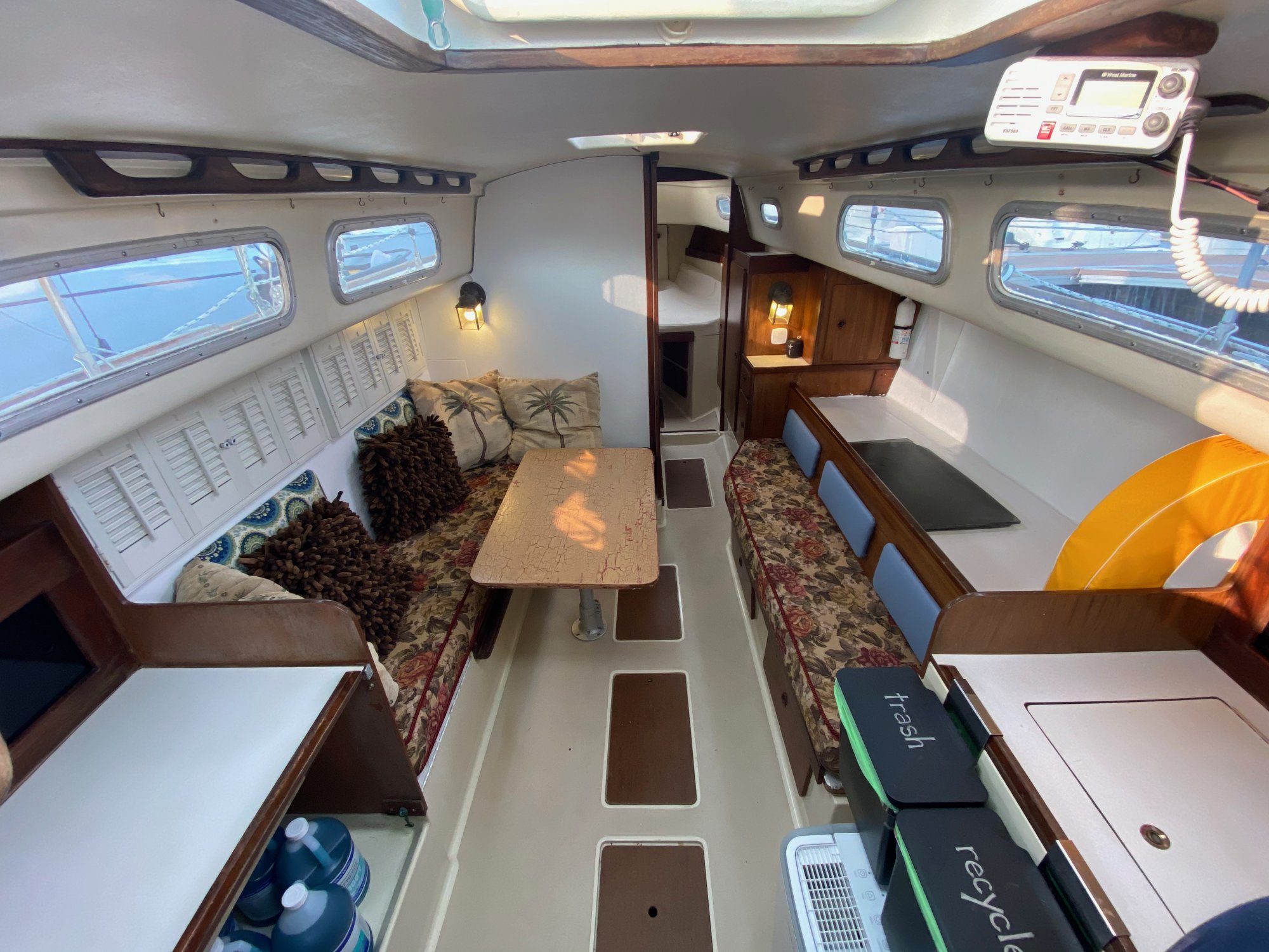

Here's her current state, complete with terrible upholstery and cushions that will go away soon. :)

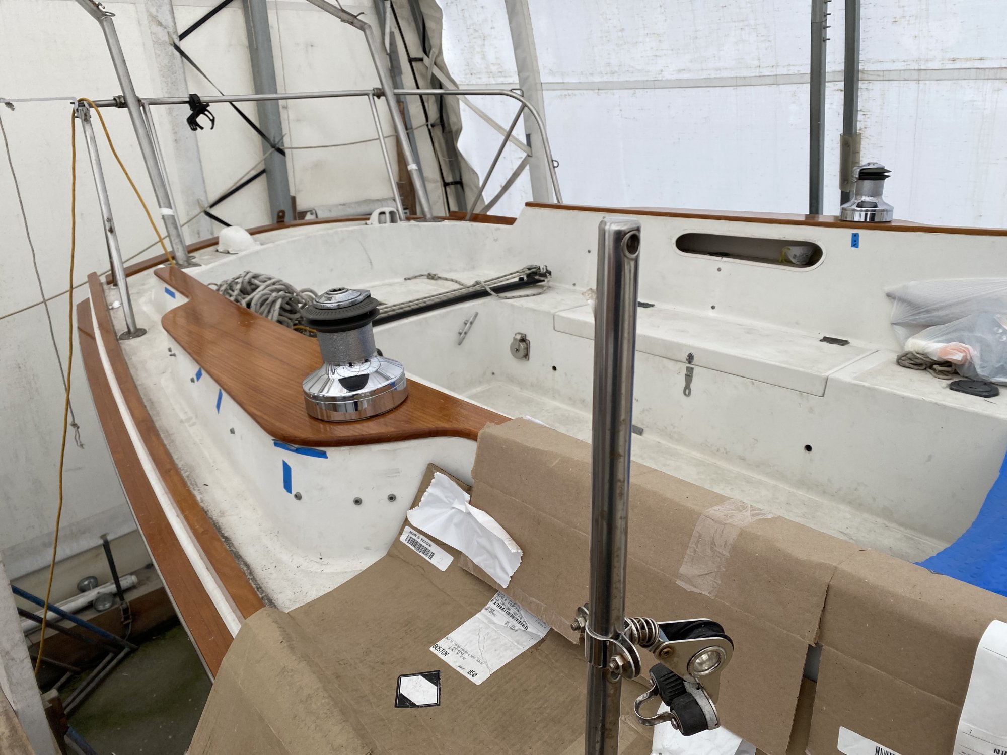

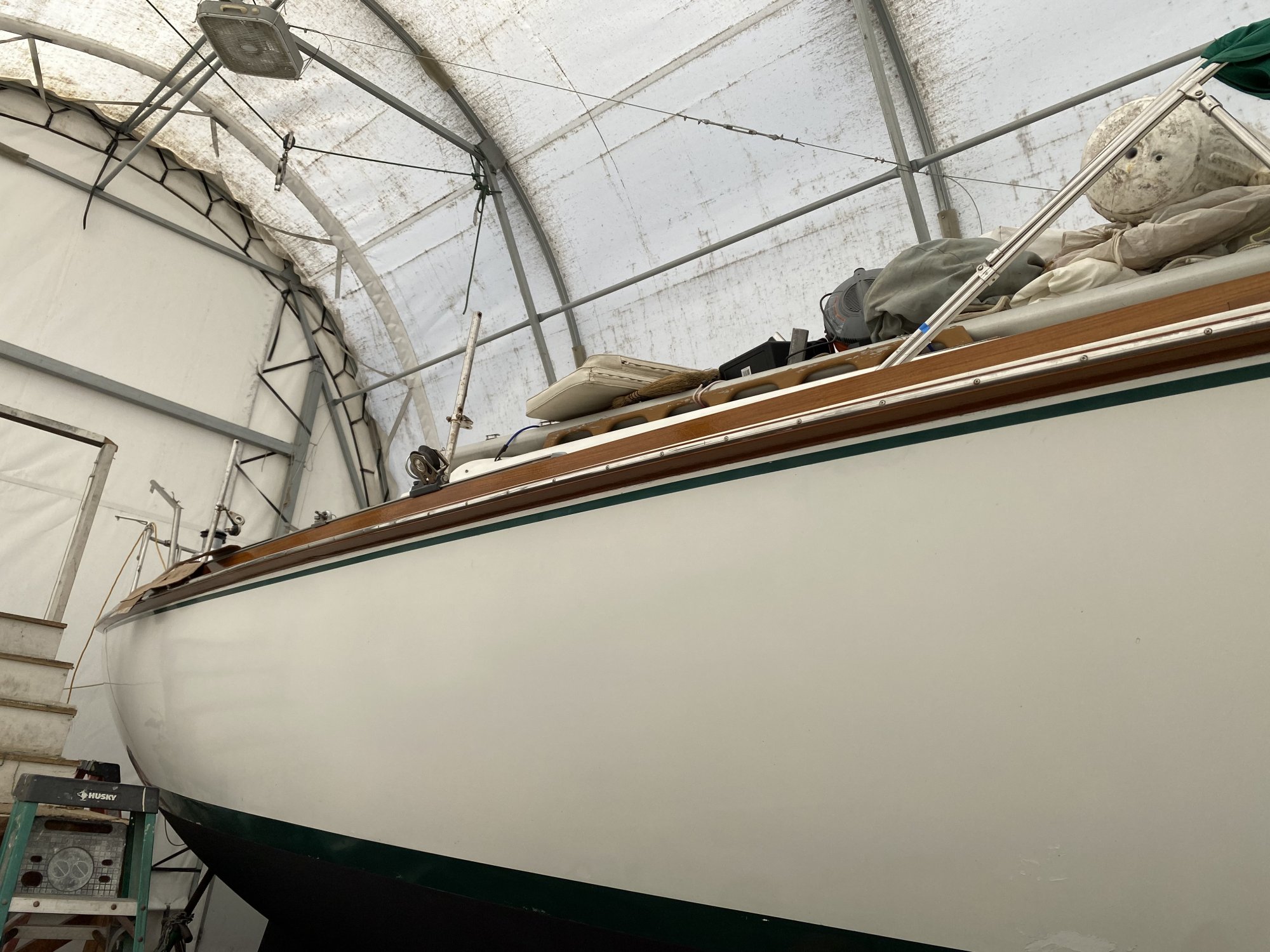

It's been a bit, and I thought it might be interesting to update everyone on what we've been up to. We ended up hauling her in the early fall of 2020, and she has been on the hard since. In the intervening couple of years, we've completed ASA 101, 103, and 104 classes, and are lining up 105 and 106 for the fall and early next year. We're roughly targeting a summer 2024 departure date for some longer-term cruising, and hoping to put the boat -- which we're renaming Wanderer -- in the water this month.
Here's the abbreviated list of what we've done, and what's to come:
  • New standing rigging (chainplates were good and done by the previous owner; rigging itself was of indeterminate age)
  • New motor (Beta Marine 25, as the Universal 25MXP gave up the ghost) and all new hoses
  • New 30g aluminum diesel fuel tank
  • New primary winches (two Lewmar 44STs, replacing the original Lewmar 40 non-STs)
  • Added secondary winches (two Lewmar 40STs), installing on the cabin top
  • Added clutches (2 3x Spinlocks) to support bringing the primary lines to the cockpit
  • New headsail furler

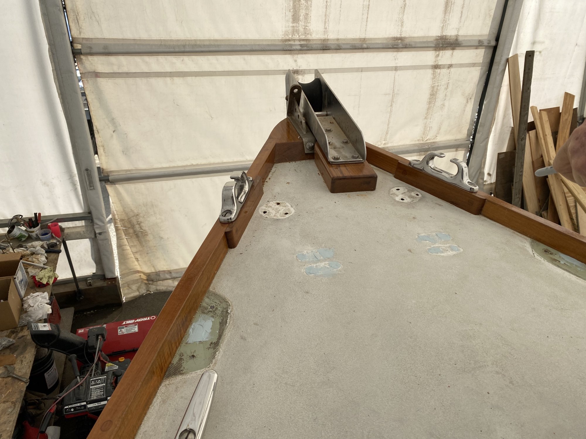

  • Completely replaced the toe rail, rub rail, and cockpit coaming with new teak, all with Sikkens as the finish; the deck-to-hull joint under the toe in particular was leaking extensively, and it was simply time; very happy with this, see pictures

  • New docking cleats all around
