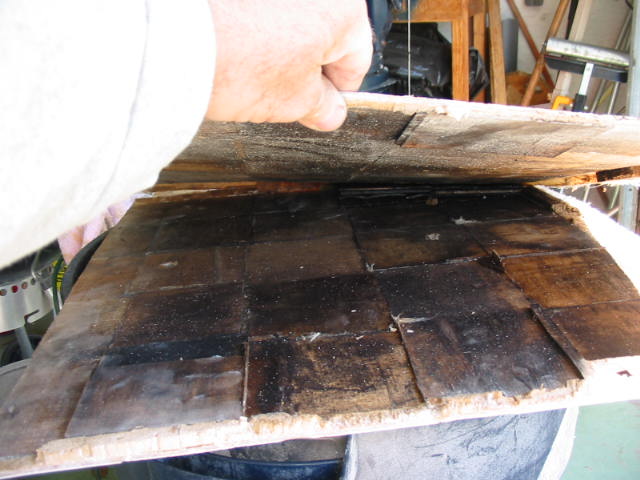

Sorry about not answering about the inspection trap!! I ‘been busy at night lately ... and after a quick look at my pics, I have none.
I have to say that "Carboman" clearly illustrated the space under the floor and he definitely means business when he starts a project! I guess the floor was soft ! Show us a picture when you finish.

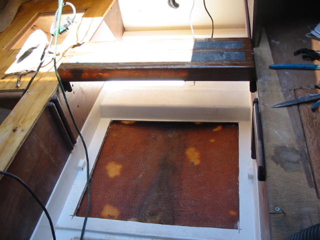

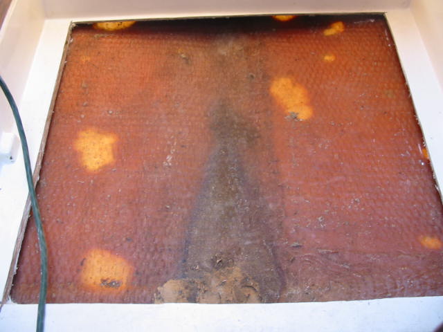

Inspection Port
Hey guys. Thanks for all the info. I took you're advise and added a port hole. Check out the pictures I took of the work.
https://plus.google.com/photos/1001...ms/5723985506454918865?authkey=CIaFvMDa2ZOZCg
It was a good thing I did! It was completely filled with water. Probably about a gallon, even though the actual bilge was near dry.
Now I can be confident that it won't get damp in the boat, and if there is water in there, I'll know about it.

Troy, that port hole idea is great! Thanks for posting those pics! I am going to be unwrapping my boat probably this week sometime... I am strongly considering doing something similar. Now that I know about this space under the cabin, I really want to be sure it's dry!
No problem. My fiance and I have been enjoying your videos all winter dreaming of launching our boat. I haven't even sailed my boat yet and I'm already cutting holes in the floor :)
Sep 29, 2005
31
HUNTER -23 Lake Onalaska
Hunter 23 floor gap?
