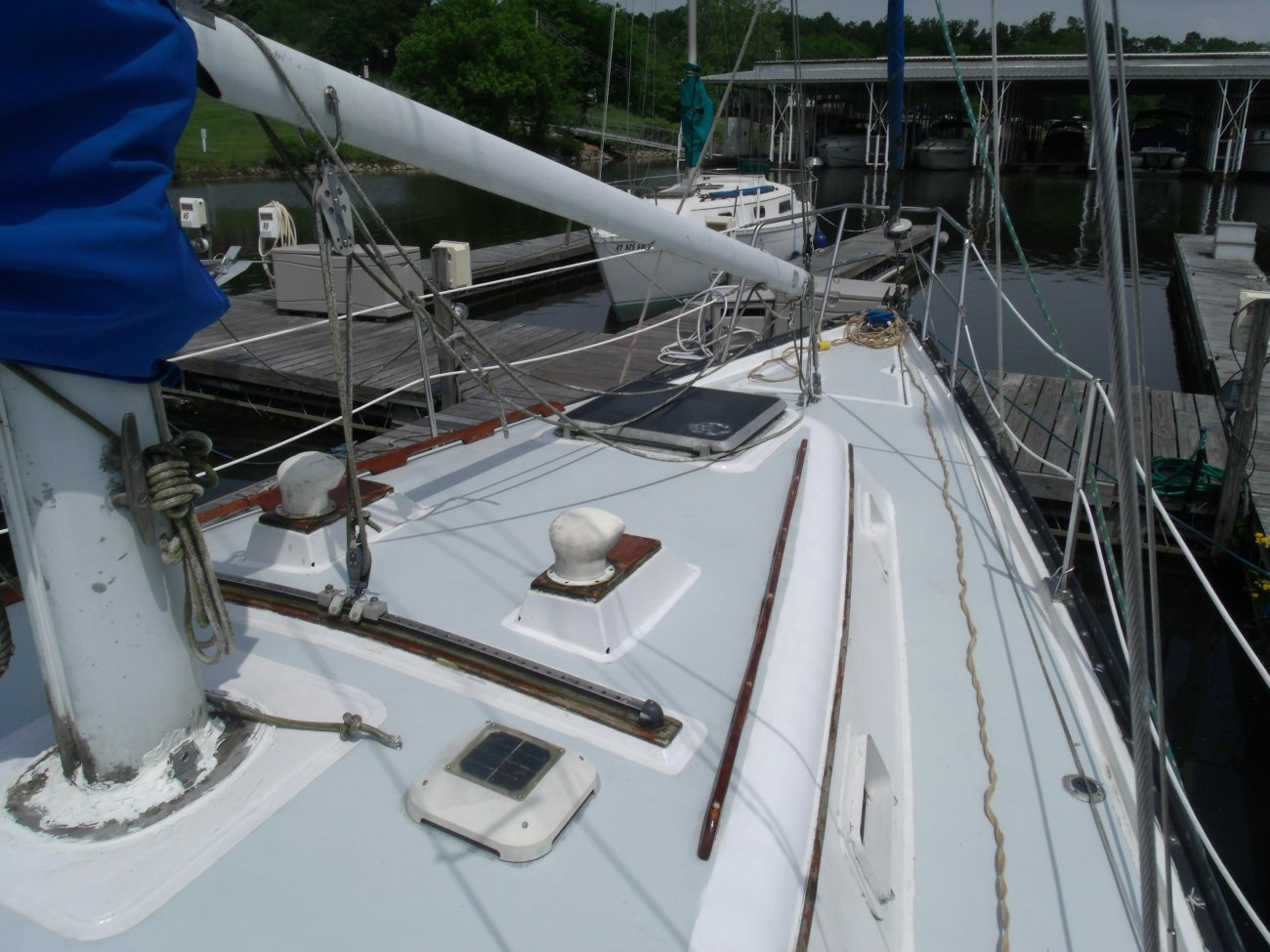

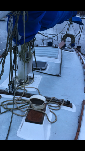

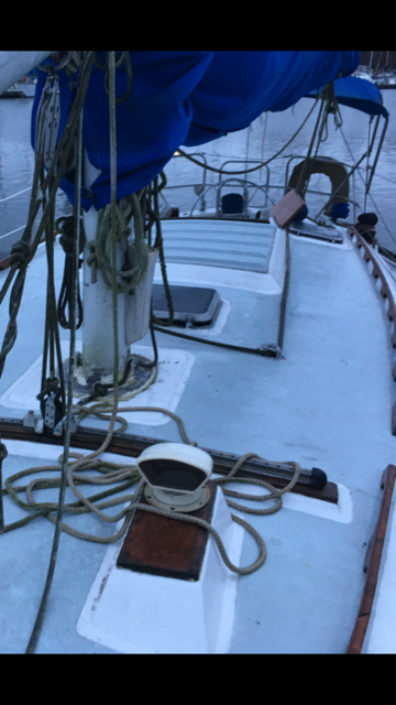

From the pictures of your boat there are a couple of immediate concerns.

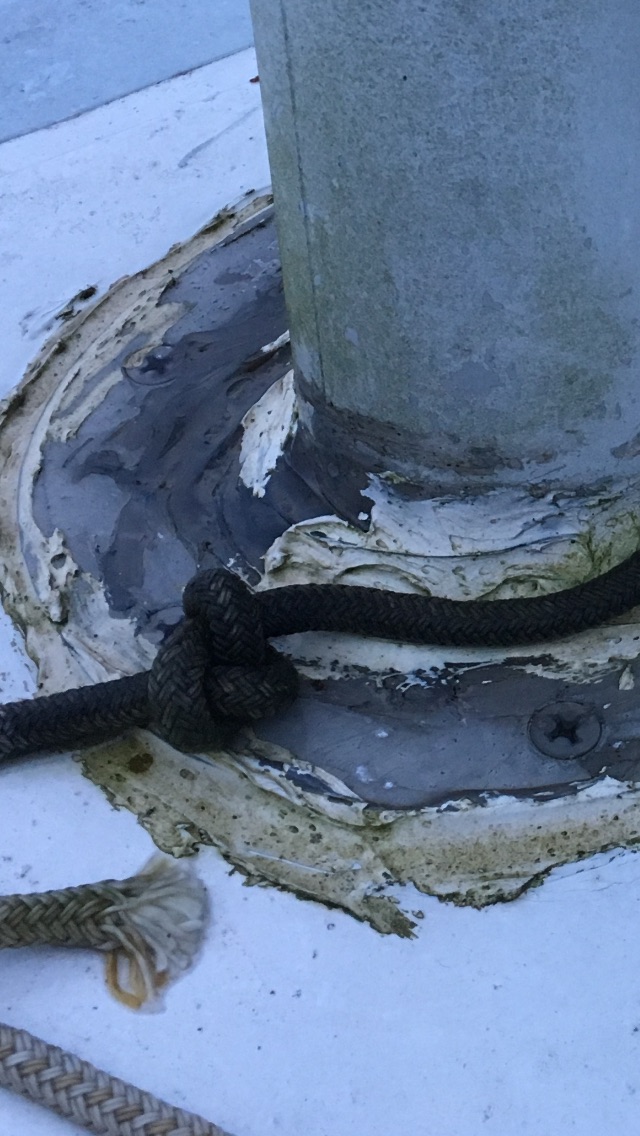

Lots of goo/caulking at the mast base. Indicates possible leak issue.

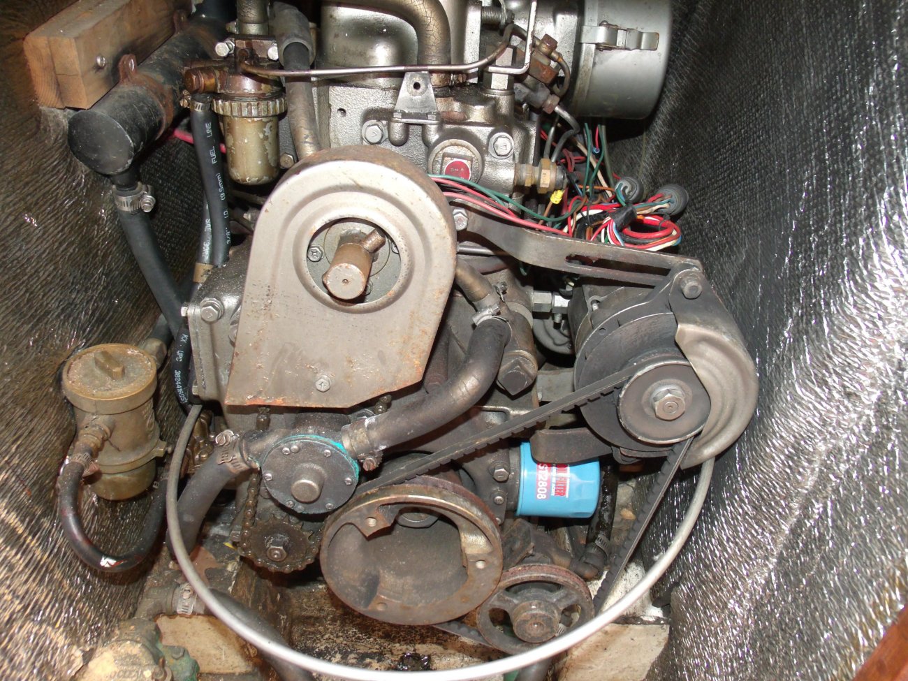

The motor when compared to image shown in other boats looks to have been used but may be poorly maintained.
Rust on front and flywheel. Black dust on alternator and frayed edges of fan belt.
coloration around fuel lines. Pretty blue oil filter.
Compare to images of other boats in list.
While not deal breakers for a handyman they may be reasons to negotiates the value.

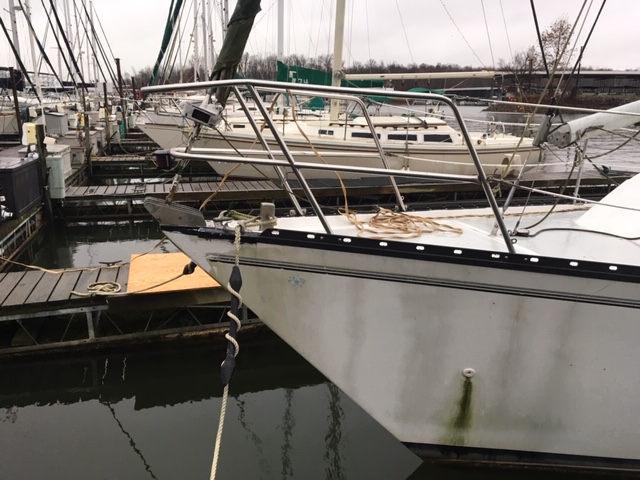

Thanks, everyone, for your advice and input. I made the three-hour trek to have a look at her. I pick my kids up close by once or twice a month so, it wasn't a special trip. That being said, I'm glad it wasn't a trip entirely to see the boat.
This girl is in serious need of a full restoration. I approach every boat objectively (as best I can being a lover of every and all boats especially sailboats), I've learned my lessons the hard way. When a seller says "a little paint and TLC" run away. Twenty-two feet is the largest boat I've done, but I can imagine the work and expense only intensifies with length. In fact, I know it does having grown up around yards and marinas.
I do think, however for someone with the means and time she could be a good deal. The broker is asking $12,000 and I suspect someone could get her for half that or nothing. The slip fees are racking up to a tune of almost 4K a
year. Then there is the insurance etc., etc...
I thought I would let the group know where she is and her status. At the very least it's another HC37 tracked down and with any luck, someone will take up the cause and bring her back to Bristol Fashion

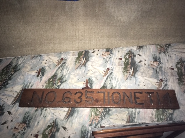

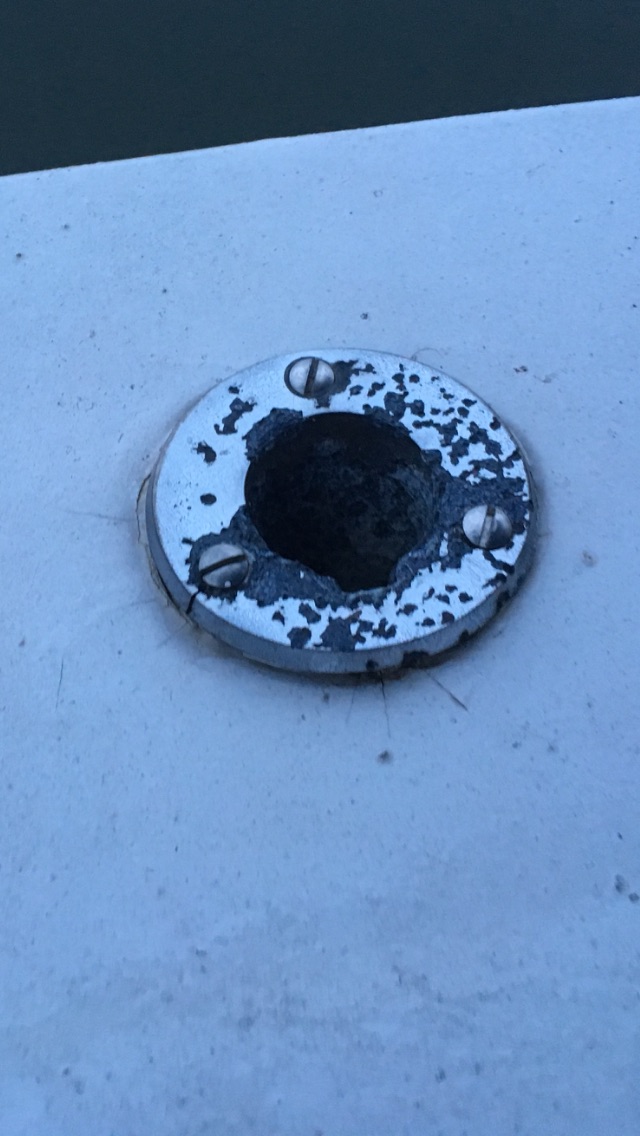

I'm not sure if this is her HIN or the Coast Guard doc. number but for anyone keeping score here you go.

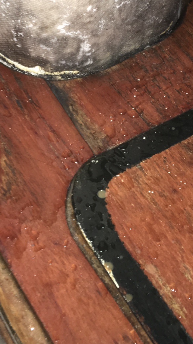

Now from what I saw, she has the original ports and is taking in moisture at the base of the mast:
The interior had that "I've been leaking" smell but, all the bilges were dry. I noticed "moisture beads" around at least one port, though there was no standing water of any sort.
The broker claims the engine is "winterized." I find that hard to believe as she looks as though she hasn't had a soul on her for years. Based on the other "deferred maintenance" I would be surprised if the owner spent the money to winterize the engine.

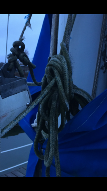

I can usually get a sense of how much maintenance has been ignored by looking at the deck. This one tells a story of an older owner, perhaps with failing health. The running rigging is mossed over, there is corrosion on a lot of the components etc..
Despite all these negatives, If the price was right (free or nearly free) she might be worth taking the plunge. I just hate seeing this classic go down. She deserves to be sailed and to have an owner that loves her. Even old sailboats need love! I'm going to give the owner a call and see if he would be open to letting her go to someone who would be in a position to do what needs to be done, that's just not me right now. And I suspect what needs to be done will take two years on the hard and about 20K to do it right.
