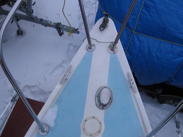

I own a Catalina 27 1977 hull number 2525. II have a plywood deck. I am lucky with my boat as it doesn't have any delamination. a few chips here and there but solid. Last year I resealed all the deck fittings, expecting a little epoxy re pare would be needed but behind every fitting was a solid deck.
This year I installed a compass and found the boat to be five quarter thick at that point. The fiberglass accounted for one inch and the rest was 1/4 inch plywood.
