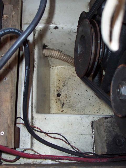

Engine Pan picture & dry bilge questions
I think the dry bilge was one of the selling points at the time.
We saw and continue to see almost nothing coming from the engine. Normal drips when running the engine coming from prop.shaft stuffing box, and nothing from the rudder post stuffing box. Main bilge stays dry for long periods of time...we are often able to sail out and back in -- engine gets little use. We don't shower inside the head...too cramped and hot...shower sump rarely ever gets wet. Most showers on deck. Cold water and breeze = welcome coolness when it is often in the very high 80's low 90's for most of the day. When at the marina, showers ashore.
Attached is a picture of the current very shallow hole in the engine pan that drains to the main bilge. We are going to plug this hole up tonight, as soon as I find my dremel.
cheers
Bob
