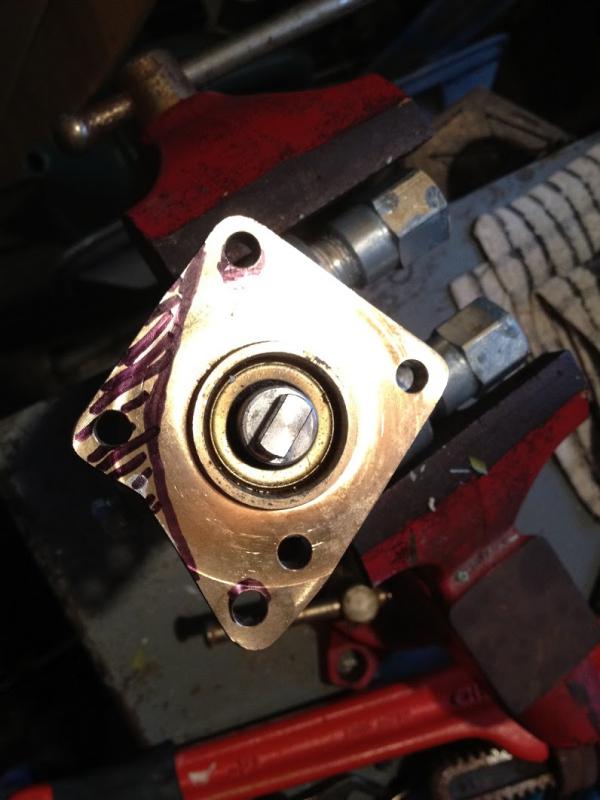

As far as the base trimming, look at the photo I attached (it was also included in the other post I did). The part marked by the black sharpie has to be trimmed off for the pump to fit flush on the motor. The two bolt holes were elongated. I did a pencil rubbing of the engine and cut out the area where the pump sits to make a template.
Again, it took about 20 minutes and I used an angle grinder and drill.
Good luck,
Jesse
