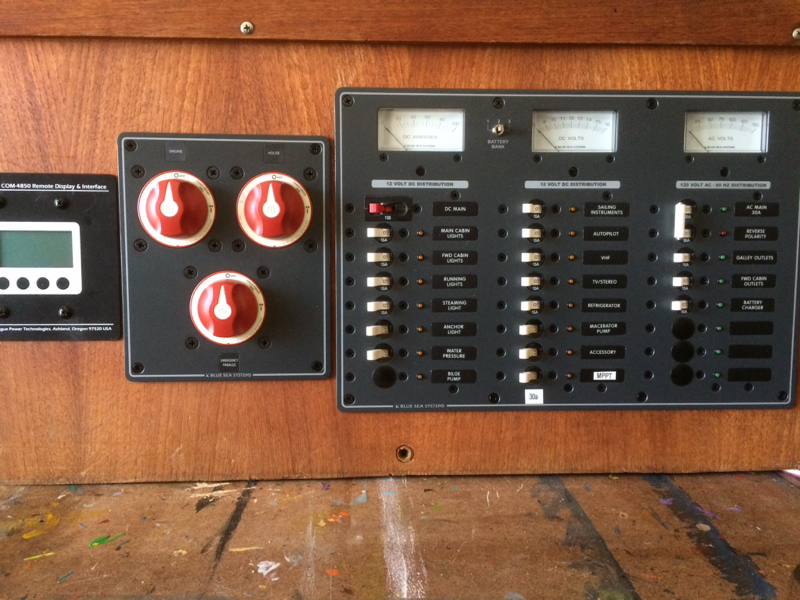

This is how I'm approaching the problem.
4 6v golf car batteries
1 12v starter battery
ACR to regulate charging
Switched with this:
Each switch is On/Off. One for Start battery, one for House Bank, and the third parallels the two banks for emergency starting.
