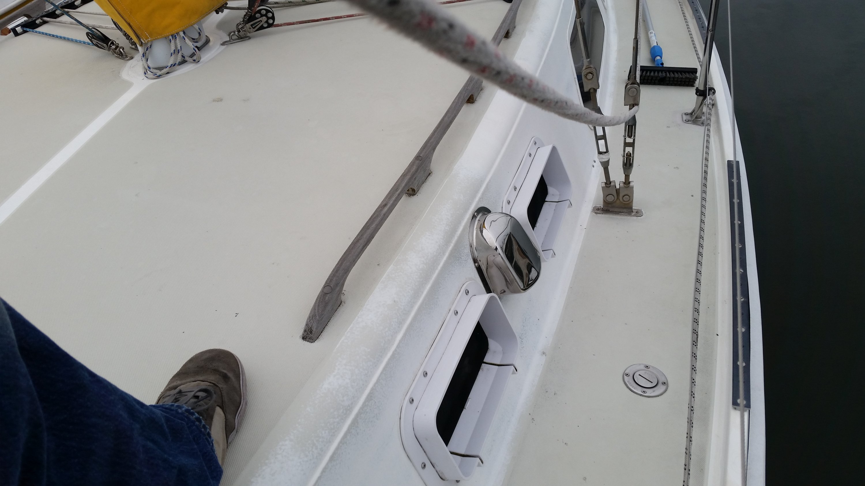

I don't want to pay for electricity at the yard where the Endeavour is when we aren't there .....
.... so made hatch covers for the three cabin hatches. The boat is in Florida and so far after about 6 years of doing this no mold in the boat with the ventilation they provide.

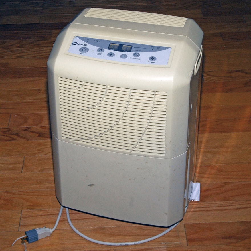

A big Maytag dehumidifier I got at a yard sale. Even in S Florida it will get it down to 40% in less than 24 hours after sailing. I tried it the first day using the built in condensation tank, and it filled the tank and shut itself off in less than an hour. So I bypassed the tank with a hose to the galley sink. It drips gallons of water via the hose into the sink after each sail.

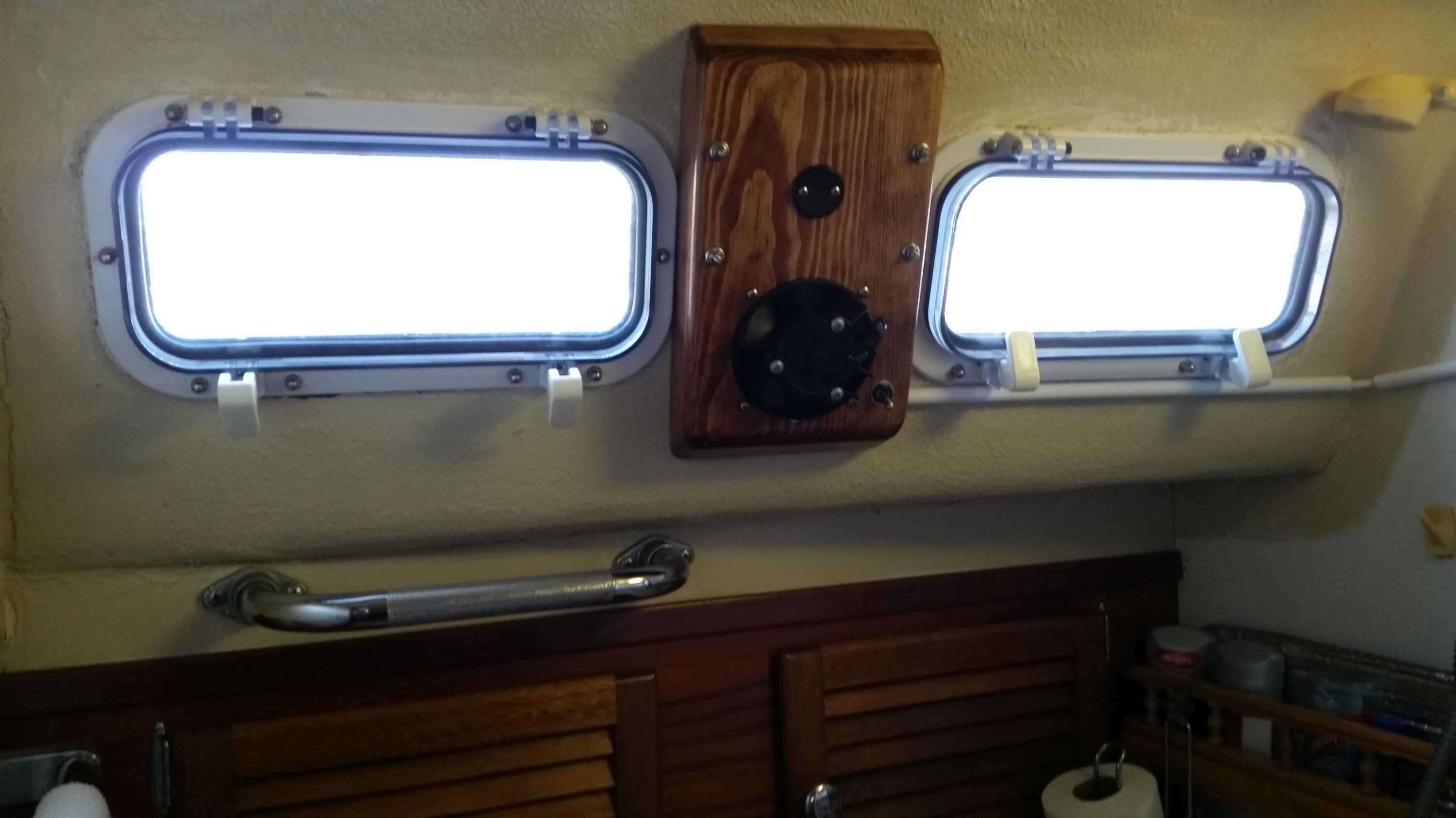

One of the things I did to create ventilation was to install a "bathroom" fan (2 photos below).... I installed a Vetus mushroom vent (so that I could close it completely), covered it on the outside with a screened cowl vent to prevent rain and spray from entering.... then I built a small fan box to cover it on the inside of the boat..... a 4" push-pull (reversible) moves a lot of air in a hurry... sometimes you want to vent out, and at other times its nice to have some cool air forced into the boat.
when the fan is not on, but the breeze is blowing, it acts like a dorade vent.
