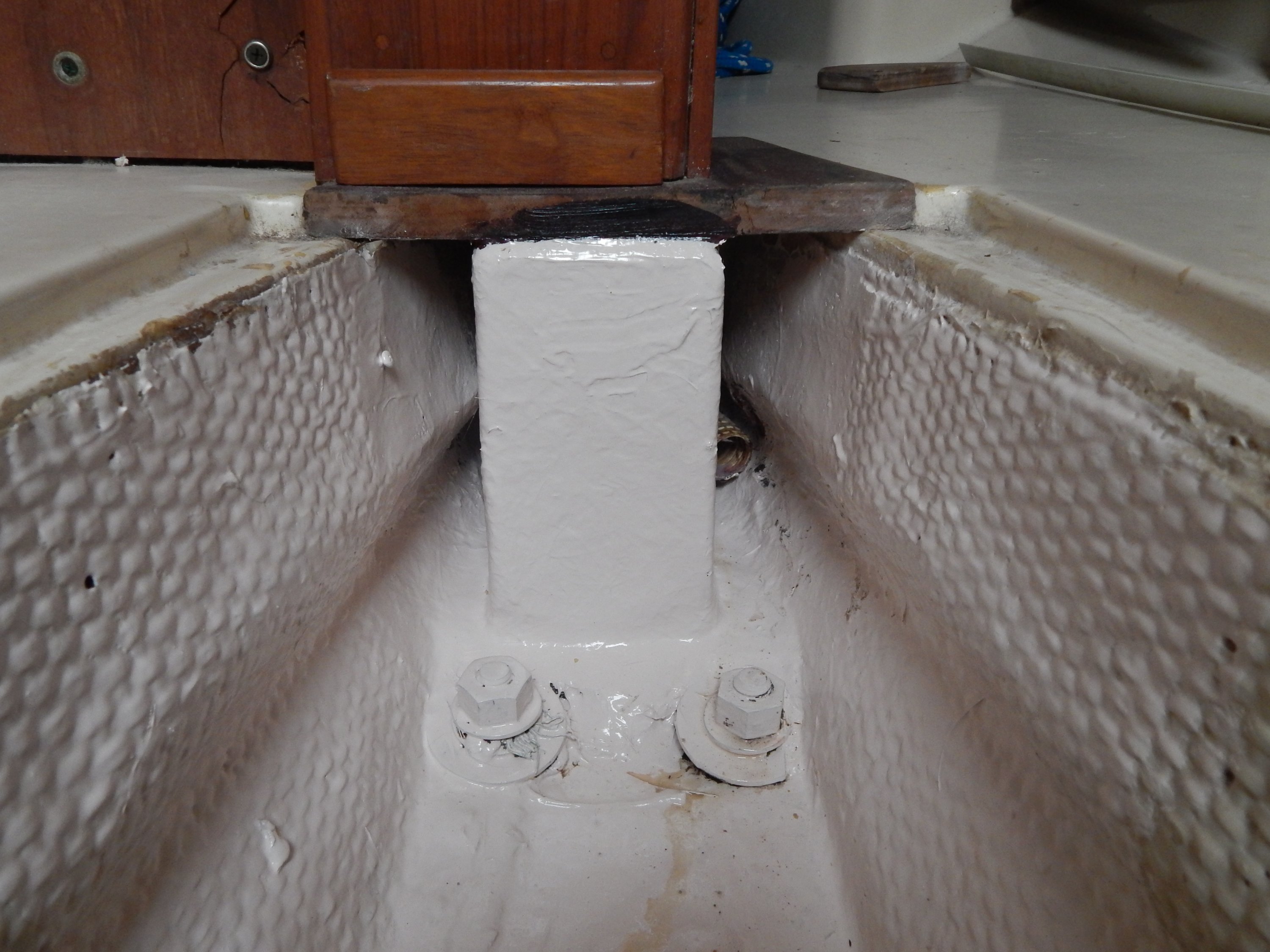

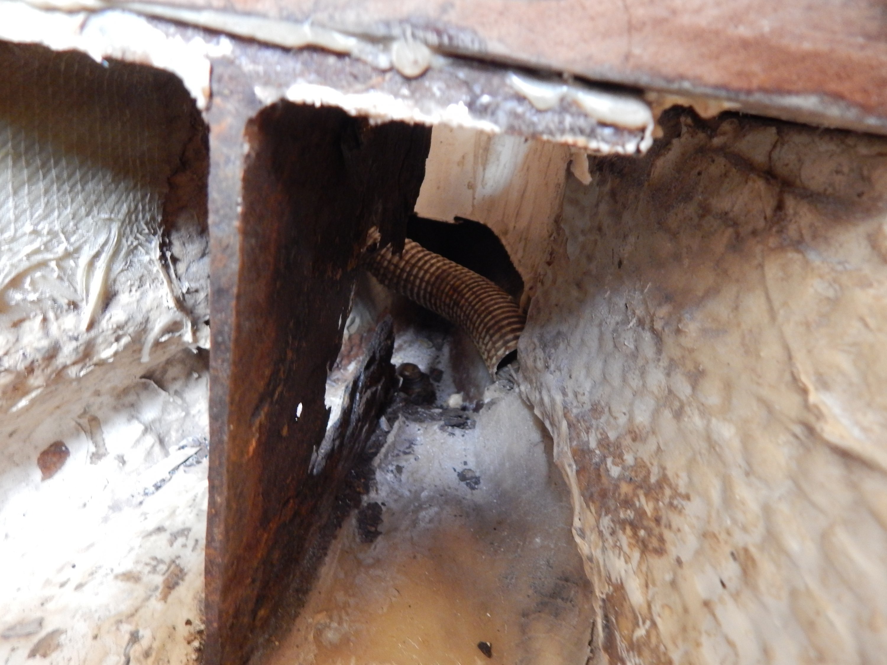

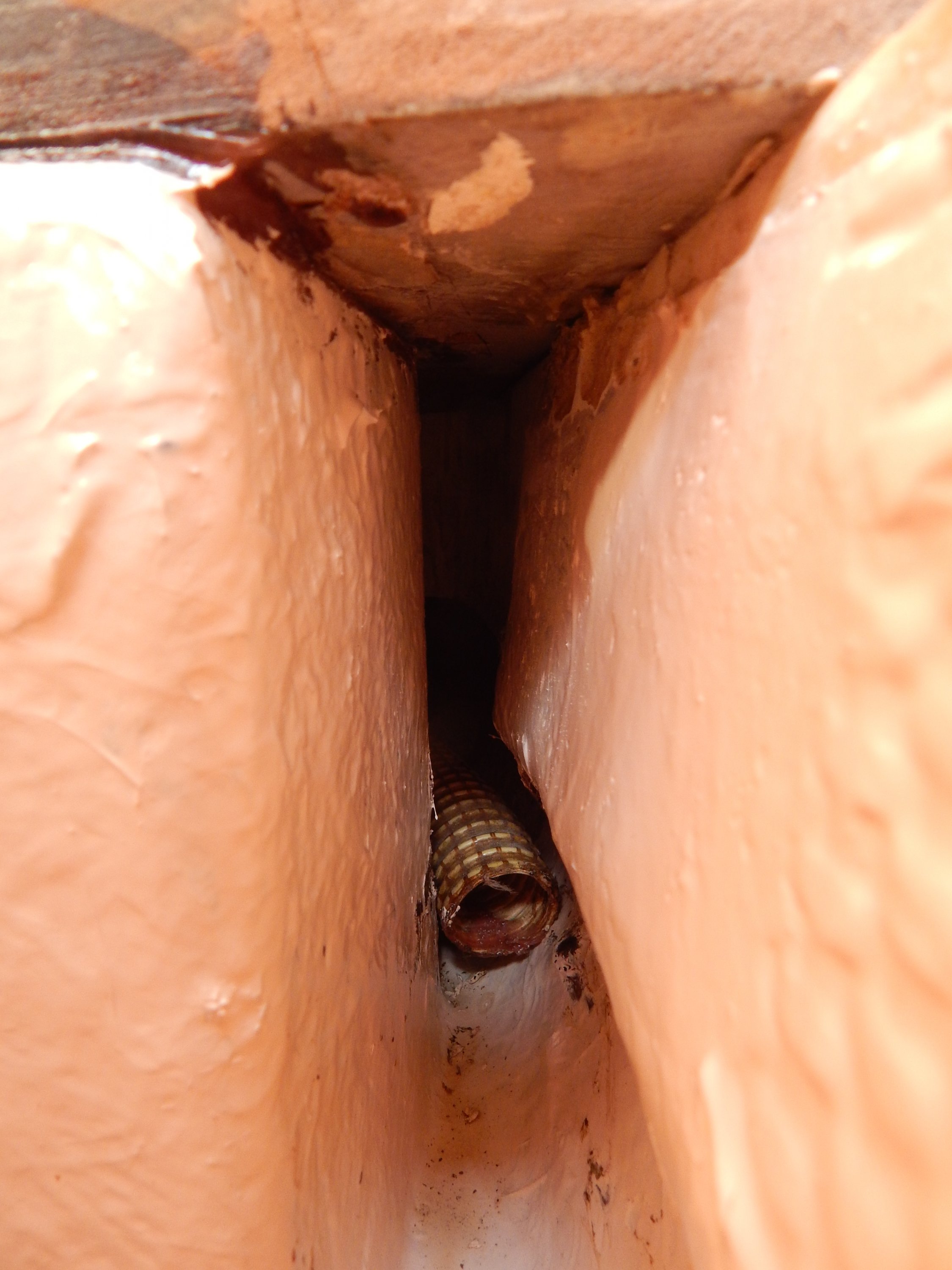

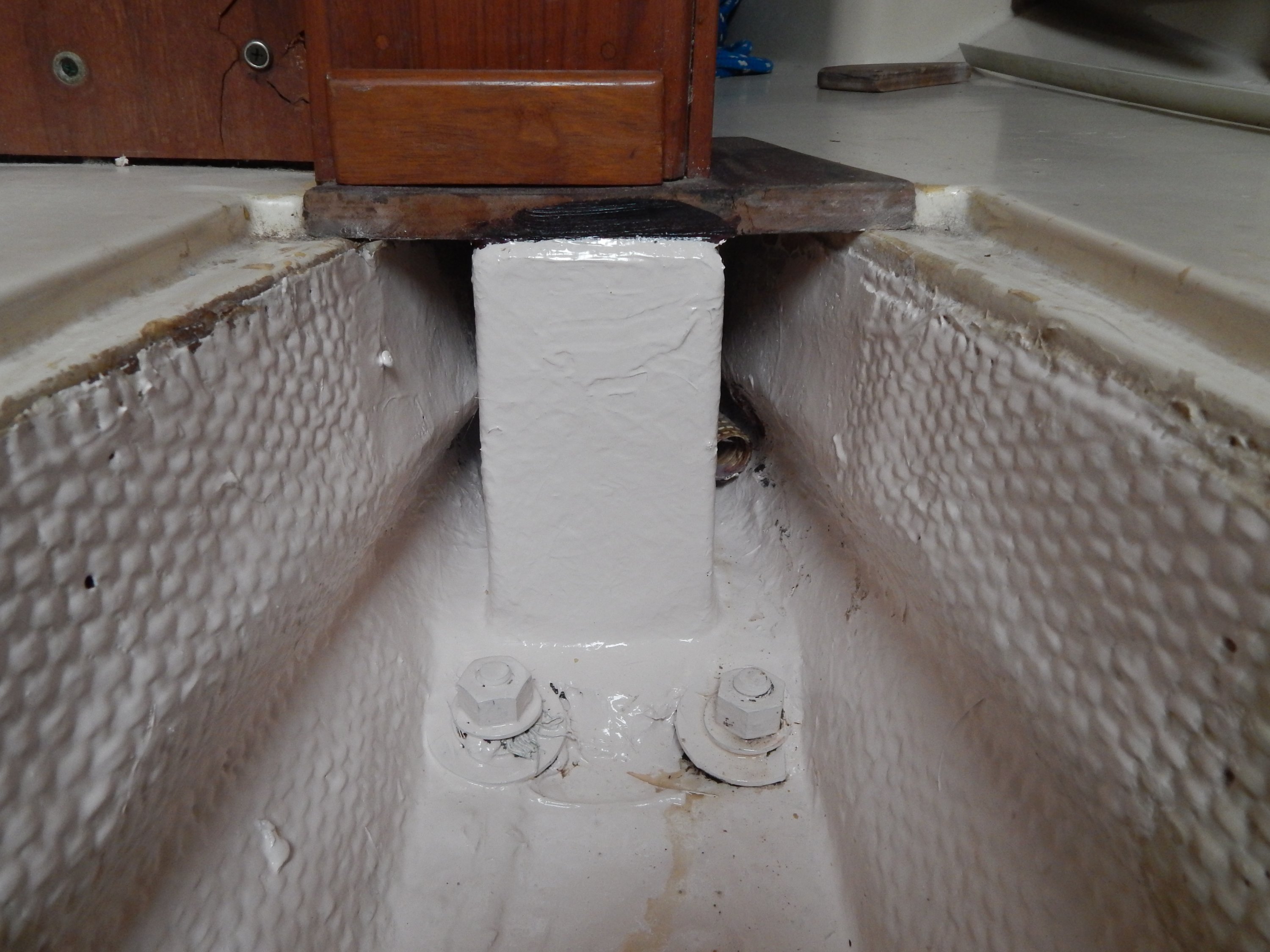

OK, so this is really a continuation of several other threads. Pulled the glass off the original I-beam and this is what was left. Removed all traces of it and cleaned all glass off. Had a block made of kiln dried Marine Tex (sp?) plywood epoxied and glassed over. Set in with epoxy and gel coated. The yard actually gel coated the keel bolts as seen in the pic. Have since cleaned the bolts of all gel coat. My question to the experts out there is, does this look like it should work and should I have left the stainless bolts and nuts covered in gel coat or did I do the right thing by removing it? What I know about stainless is that it needs exposure to oxygen to retain the stainless quality. Another question to JC. You mentioned in a previous post about not putting downward pressure on the keel. This block sits on an area that seems to be built up from the keel. Could you elaborate a bit further? Thanks.

The 'fix' I have been advocating about this is to make a 'bulkhead' of fiberglass athwartships under the sole there, to strengthen the sole itself to hold the mast. This could be made of fiberglass board (like from McMaster-Carr), could span the whole space, could be fitted with an longitudinal blade for stiffness, could be fitted with limber holes, and, most importantly, be tabbed in (structurally) to the sides of the hull to either side. This would spread the load, sufficiently and to the right places. The point I was making was that standing the mast on the keel itself (or transferring the load directly so that in effect it's on the keel itself) is patently bad engineering. Remember the mast is the arrow, the rigging is the bowstring, and the hull is the bow. You're trying to shoot the arrow through the bottom of the keel. If the bow works at all (and it does, in this case), then it's going to apply a load there-- to the bottom of your hull. And guess what the bottom of the hull is holding on?
In short: never compound loads from separate duties in the same direction... especially in a stressed-skin structure.
Even amongst industry leaders, we have all become soft about idea of fiberglass being a wonder material for boats. We think it can do anything, that it doesn't rot, that it's strong, that it's maintenance-free. All of these are myths, not even close to being true in the real world. Stressed-skin boats receive a variety of loads at a variety of points, often without being understood. Your chainplates pull up on either a (rot-prone) plywood bulkhead or a cored fiberglass deck. Your mast step presses down on a cored fiberglass deck. Your keel pulls on a fiberglass eggshell. And fiberglass isn't as good in tensile, especially when point-loaded (equivalent of clevis pin in hole drilled through 'glass) as most people believe. Where's the strength and the support? 'It's fiberglass; it doesn't need it!' --bah.
Even considering maintaining and rebuilding the existing aluminum block under the H30 sole is, technically, a waste of time. Sure; you can make the existing system work again, as apparently it did for three decades or more. But it's a bad system to start with and, when the occasion permits, should be replaced with a proper support structure.

Thank you for the explanation. I'm going to have to see how this works out over time. The block is made of several pieces of plywood, ( see OP), epoxied together and set in vertically. If need be, could I just add athwartship pieces and tie into the sides of the bilge? Does that even make sense? Thank you, again, for all your help over the years.

Yes, it does make sense, Roland; but as you say, it's basically a better version of what was done before; so we'll just see how well it lasts over the long run. I just get afraid of the very bottom of the boat any time I'm not sure how thick it is.
When I reset my keel I didn't really remove it, just jacked up the boat a little and so the keel bolts did not fall free of the holes. So I really don't know how strong it is. At great effort, since G-10 is very hard to work with (kills every sharpened edge you put to it), I made 'backing blocks' to catch the two biggest keel bolts to either side and set these into 5200 and drew the boat and keel back together. I also made a triangular one to catch the forwardmost bolt (the one under the greatest tension and shock when you hit bottom) and did the same there. Of course I taped over the threads (the tape is still there) to keep the 5200 from bonding to them, which would make impossible any future tweaking of these bolts. I had noticed some (very minor) delamination and cracking along one side, outside, and it scared me. But it's got 2-1/2 tubes of new 5200 in there now; so, less to concern me.
I still would be wary of standing anything on top of the bottom of the boat. As I tried to explain, on a stressed-skin structure, you want to spread the load. If you ever did any more than you've done now, it would be to fabricate a web (thinner now, since it's not holding the compression) and fasten it to one face of your block and 'glass it to the sides of the hull (don't even worry about the bottom edge). Think of it as a bulkhead, a blade, that won't distort vertically. Properly 'glassed to the hull, this will be a rigid structure.
People (like my brother the aerospace engineer) dismiss rigidity like it's a recipe for failure. On a boat I totally disagree. You always have the boat's own movement in the water to take up any excess loads. Therefore, say I (and said my dad), make it as stiff as you can. Anything that's 'too' stiff, that would break under impact, or vibration (neither of which you have to any appreciative degree on a sailboat), will be mitigated by the boat bouncing in the water or heeling over. And you will sail better with snug shrouds and rigidly-fastened bulkheads. From a design, engineering, component, and utility perspective, I don't see any detriment to that.

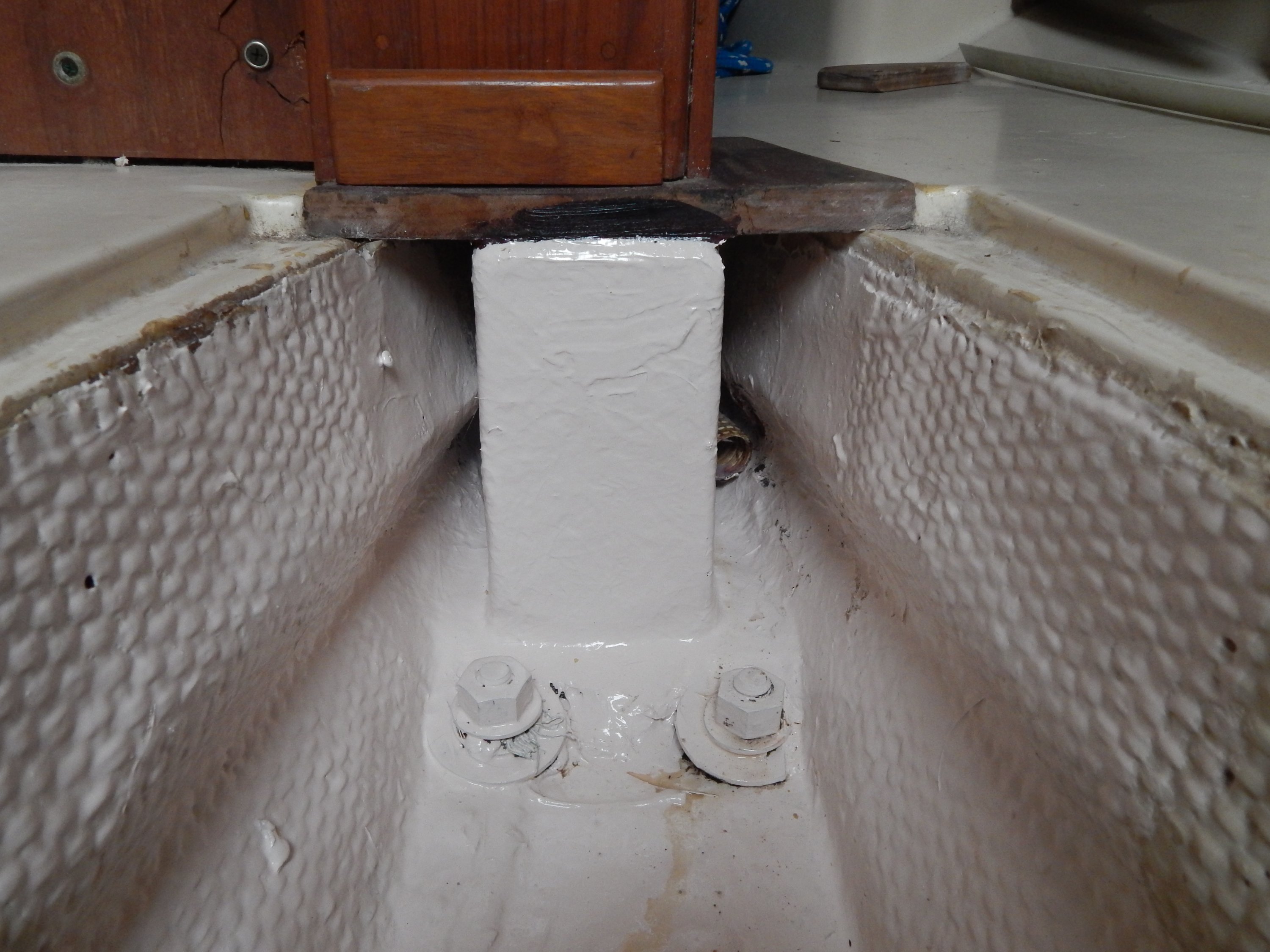

If you can, take an after photo at the same distance and angle as the before shot. Thanks!
First pic at the best angle to the 'before shot' I could get looking forward. Second pic looking aft from the cutout in front of the post. Dimensions: 7 inches deep (fore and aft), 4 and 1/2 in. wide, 8 in. high.
