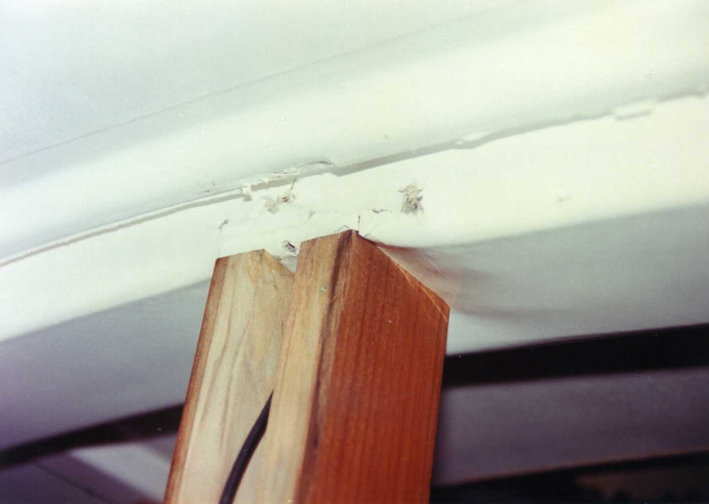

Yup.. Like Allan says, the post is not held in place top or bottom, except by compression from the rig loads. The door frame/bulkhead keeps it where it belongs.. so when ya have the teak off, the post can be removed by releasing the rig tension and jacking slightly. Attached picture shows top where post bears on cross beam.. no other attachments needed. You can see the trace around the OD of the post I made before removing it so I'd know where to cut the beam.

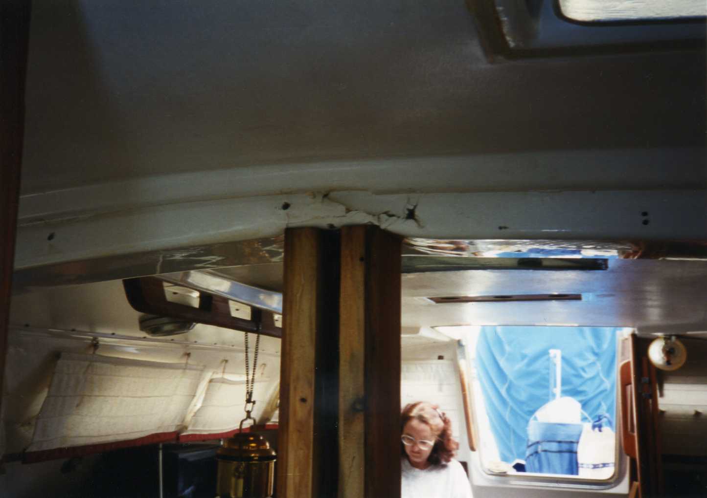

That doesn't look like a compression post failure. It looks like a cabin top failure by too aggressively cranking down on the rigging.

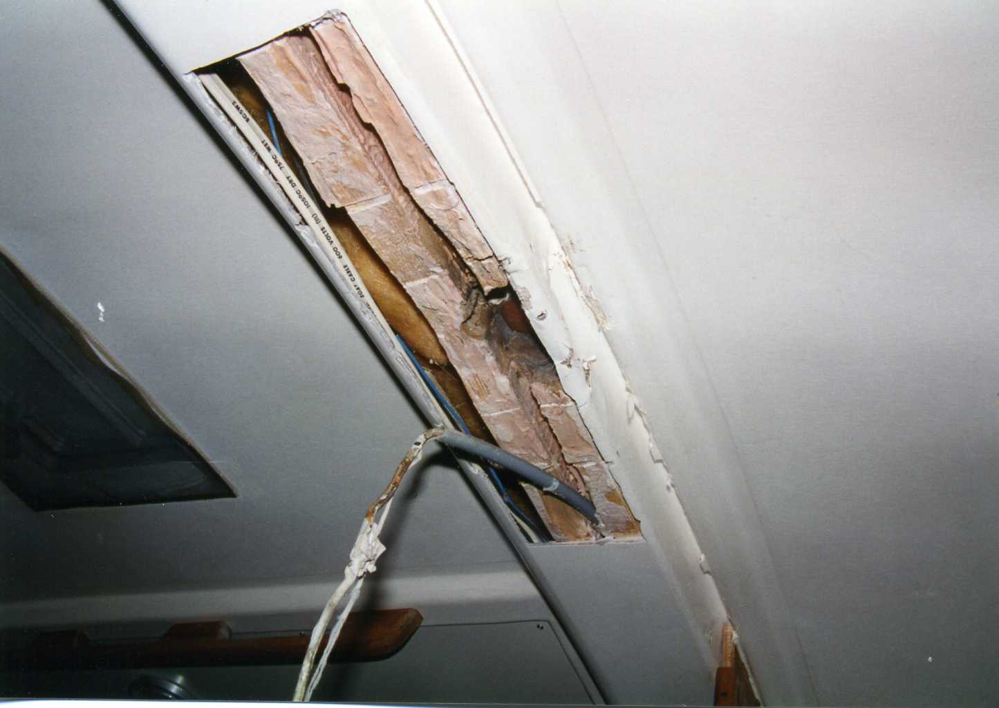

That's what we thought originally even though we were tuned in spec. Then we started inspecting. From the picture you can see the "support" inside the beam is a transverse piece of Douglas Fir. That's not the ideal direction to take a compressive load. See the deformation in the block. Next, there is a big notch for the wires to pass through. That is the actual center of the mast, so you can see much of the load was unsupported. This then allowed the deck to take the load and push the beam down and around the compression post.

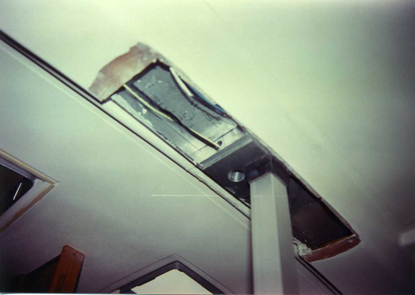

Others have found water intrusion as well through the hole in the deck under the mast. So not only do they have the beam support (if you want to call it that) crushing under the unbalanced load, they also had rot of that beam and the guts of the compression post. The solution in my case was to fill the cavity from the underside of the deck to the top of the post with aluminum.
Once there is a solid couple under the mast to the top of the post the load is no longer supported by the deck and all is well. I was lucky and caught mine after 11 years, so it hadn't leaked and rotted. Others have had to replace their posts as well because of the added complication of rot. All in all, it was a design flaw and eventually all the 31 and 34 models will need this retrofit. More creative people on this site have shared their repairs requiring much less invasive surgery through a smaller hole. Just cut the wood in half through a small hole and shove it aside. I fixed mine in 1996 and it hasn't moved one iota since. The rigging doesn't go slack every week like before either.

Allan, My 1988 Hunter 33.5 had the same problem. Water leakage from under the mast wiring hole into the cabin leaked water onto the wooden compression post. After removing the teak covering that encased the post, I could literally grab chunks of rotten wood from the post. Did a repair similar to yours with an aluminum post & wrapped it with teak.
