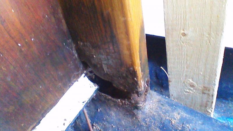

I was thinking that all I needed to do was to use some git rot and my dry rot on the bottom of my compression post and bulkhead would be fixed.
Then I started preparing for application and found just how bad the rot was on my compression post.
Boy was I stupid! I should have caught it sooner!!!

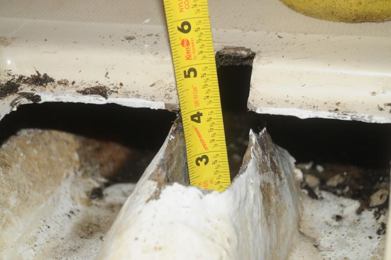

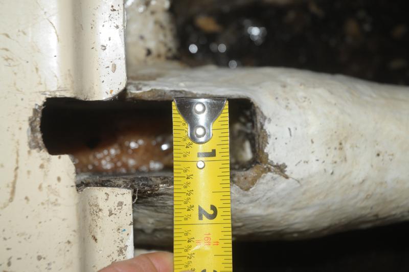

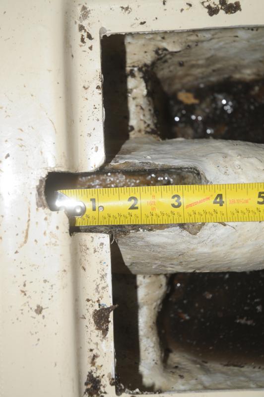

I have a 79, and did mine this past Spring- the previous owner left it open for a while, and it had about a foot of water in it for some time. I replaced all the bulkheads, hull liner, and the post. The post was rotted out at the trunk line.
I made a prototype out of pine 2x4 for fit and shapeing. For the final I used used oak, and it IS 3.5 x 1.25. by about 58 inches, if I remember (take the measurement from headliner to the trunkline, and add at least 4") , sitting in the socket about 3.5 - 4" deep. (see photos) . I made mine about 1.5" too long, and slowly pared it down on a table saw to fit after planing the thickness dimensions. You will need to rabbet the port bow edge for the bulkhead fitting. I had to pound it in somewhat "lightly" to get it to fit, but I wanted it snug, like the original.
I went to all 3/4" ply for the bulkheads- it worked well for my last 25 , and is stronger than the 1/2" . You will need to rework all the dimensions for that 1/4", but I think it is worth it. Don't worry about jacking the liner to install the new bulkheads - it can take an inch or so...just make sure you get the taper of the bulkhead tops in the slots right!
I put 2 coats of epoxy on the bottom 6" up and varnished the rest of the post. The bottom of the post has a 45 degree cut about 1" in height on the stern side to facilitate "rolling" the post in. I set mine in thickened poly, and it's bomber now.

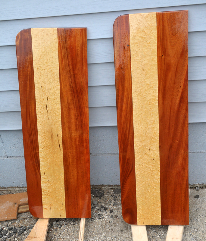

Also built a new table to replace the original international orange one. Used mahogany with a birds eye maple center strip, and it looks nice, with a teak support and 8 coats of varnish.
