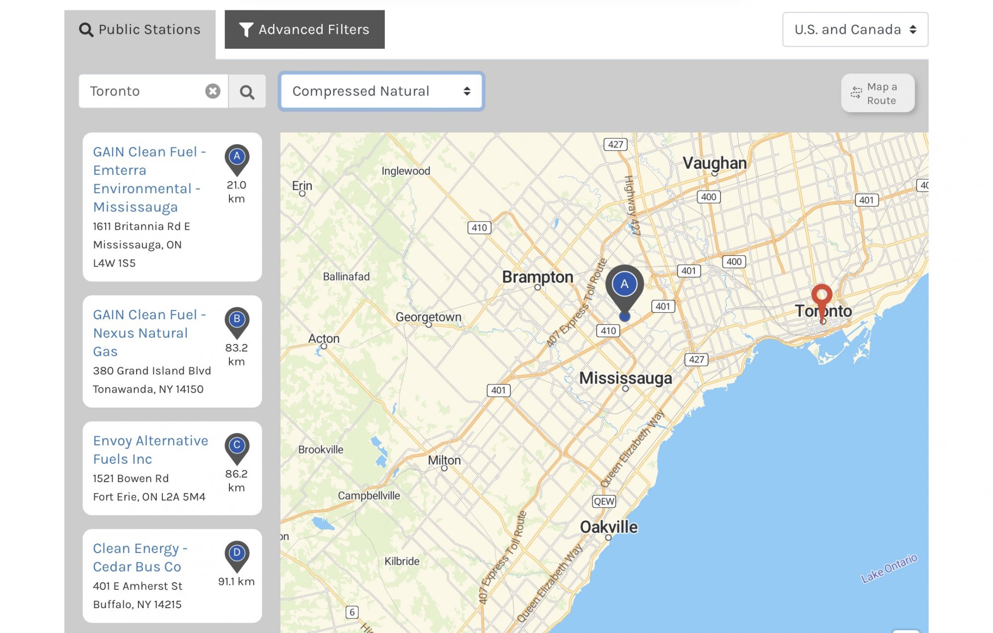

This site lists various filling stations in Canada…
Assuming you are in the Toronto area, there is a place listed near Mississauga.

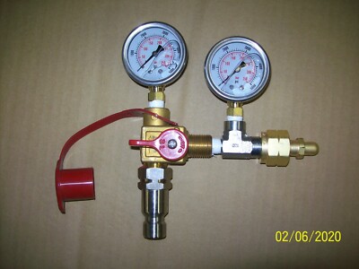

That is why I have been using this device to refill my CNG tanks for the last several years.
I do this where CNG powered trucks, busses and cars fill up. Around here they are all self serve.
You have to decide for yourself if you think it is safe or not. Or whether it is legal or not.
I do recommend that at a minimum you have your tanks hydro pressure tested before filling. That is generally required every five years.
It generally costs about $2.00 at the CNG station to fill each tank to 2,000 pounds.
