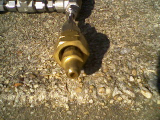

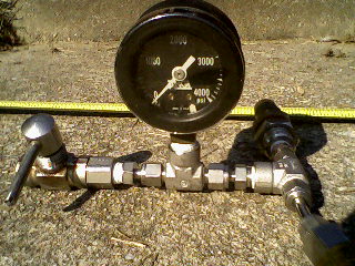

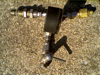

Make an adapter
to convert from left hand thread bottles to gas station quick connect. CNG is about $0.70 a "20 hour" bottle at the pump.
you can get everything from the internet just make sure it is all rated for 4000+ psi

Bill, the pictures are fine but could you post a list of the various parts that we would need to locate to make this adapter.
I already have an old CNG pressure regulator that I can salvage parts from.
There are several locations on Long Island that sell CNG for motor fuel but you need to set up an account with them first.
