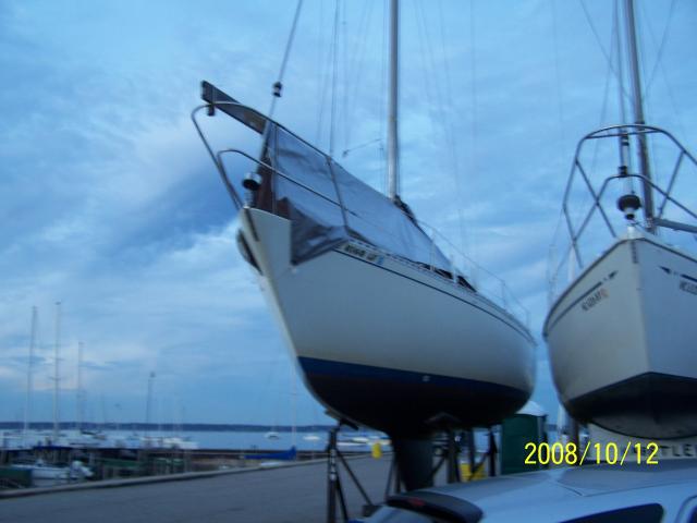

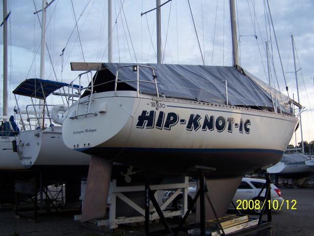

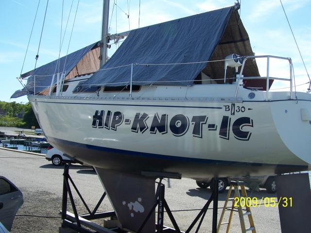

Islander Bahama 30 Muskegon
I have gone the compound the boat and wax the boat way and it helps the results are still not that great for the cost and effort. A friend of mine recommended the Vertglass system that he used on his boat 4 years ago. His boat has a great shine and draws a lot of complements. Last summer we did a test patch on my 1981 Islander B30 and it looked good still this spring. I ordered up a Vertglass kit from http://www.marinestore.com/vertglas-images.html?cart=33285123081434 The results were amazing and while it was far from easy it was still easier than what I had previously tried with unsatisfactory results. It took my wife and me about 2 days to apply the system and we were amazed. The boat looks like it is brand new and every one in the marina wanted to know what we had done to it. For 2 days we had people stopping by and asking about it, they thought it had been repainted. Vertglass can only be used on gel coat if you boat has been painted Vertglass will not work. I do not work for Vertglass but it works. The two pictures on the right are before and the two on the left are after, I did use Main Sail's On and Off trick on the tannin stains. In the third picture you can see the Virtglass test patch between the T and the I in HIP-KNOT-IC.

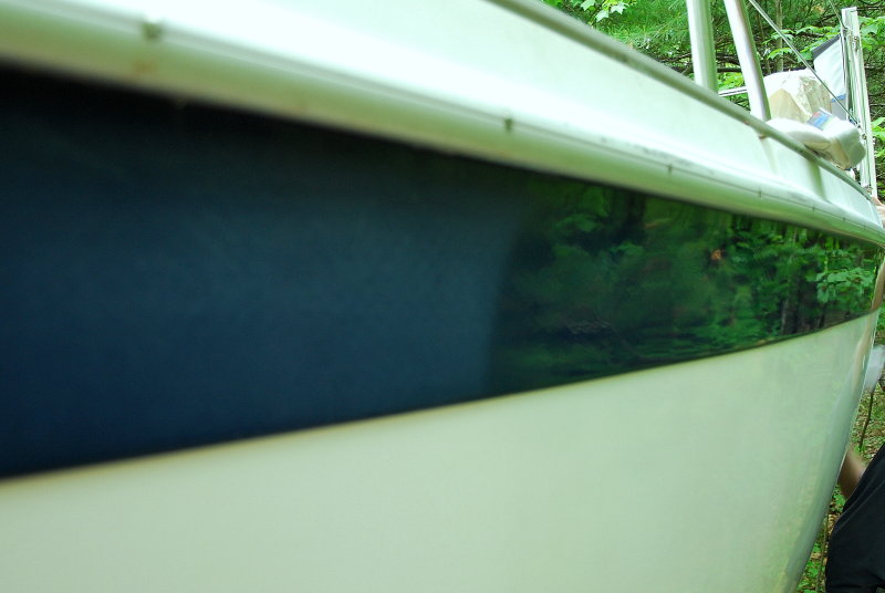

Do not use compound or sanding on old fiberglass it does not work.
Absolutely not true. Old gelcoat can be made to look very good with proper compounding and polishing. This is not your average DIY job. It is something that needs the correct tools and supplies and then must be learned. If you were to apply any of the miracle products to the chalky gelcoat on the left it would not look nearly as good as the gelcoat to the middle or right of this cove stripe.

Do not use compound or sanding on old fiberglass it does not work. I have had some success with the Poly type polish and it is much easier.
Hmmm... Really??? I have not yet come across gelcoat I can't bring back...
How old is old?
Before & After (compounding only @15-20 minutes)
