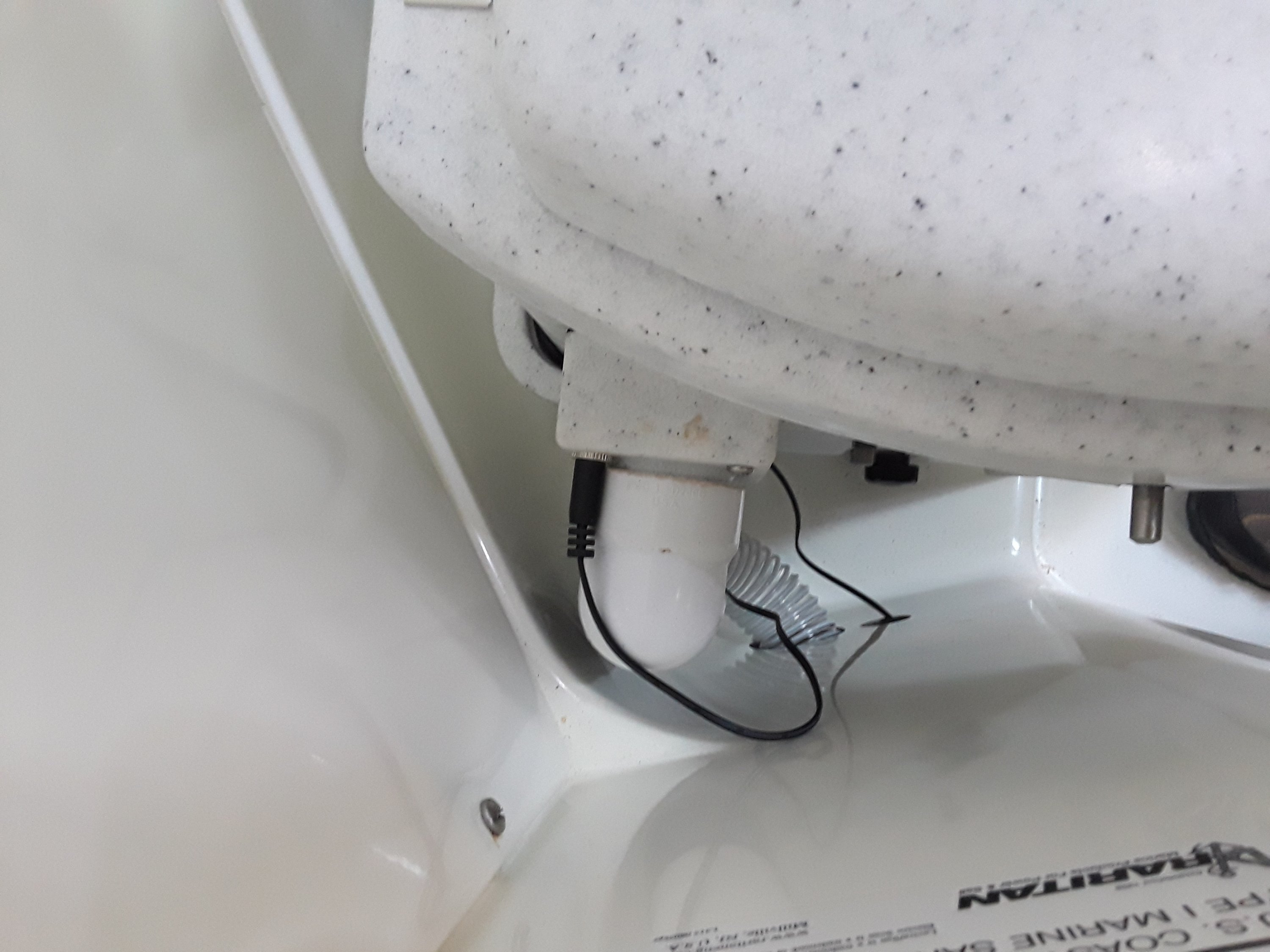

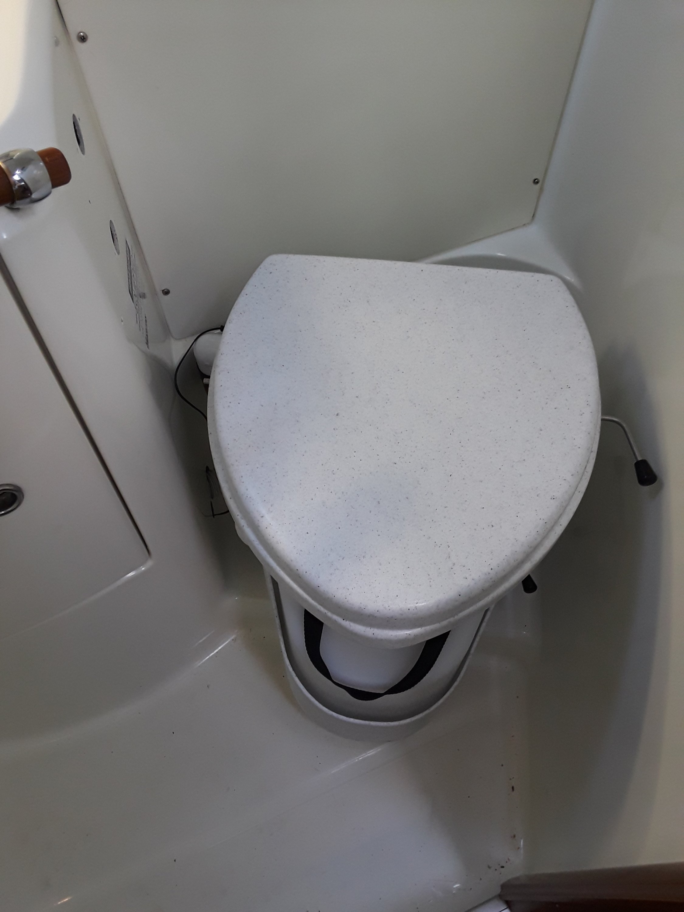

OK quick update, the toilet fits, I have not secured it, or the venting, completely but I'm moving ahead with drilling holes. It's pretty tight and the toilet has to be taken apart to even get it thru the door but the whole thing sits on the ledge and there is room for the vent on the side, spider turn and all that. See attached image.
Plan is to find a PVC angle and get the hose up to the side of the roof as close to the wall to aft cabin as possible (we have 2 cabin version). Then we'll have a clamshell on side to cover for rain. Roof vent is not option as it will vent into the cockpit enclosure which seems less than ideal.
Also it's unit is pretty tall, the Air head might be an option as it's smaller but I'll have to say that the angles sort of helps this fit as it gives the fan some open air on left and handle slides along wall, I'm not sure the handle on the Air Head will. Once installation is complete I'll make some more pictures but I'm quite relieved that it fits.
Mrs now has plans to convert the space behind it to storage for coir and composting accessories. Her idea is to either finish the interior or possibly mount a small built in "cabinet" in the fiberglass piece that covers it, my idea is to put the cover on and have a beer.
Edit: Read the comment about the door, I tried my best to simulate usage and was able to close door just fine, I'm 6.3.

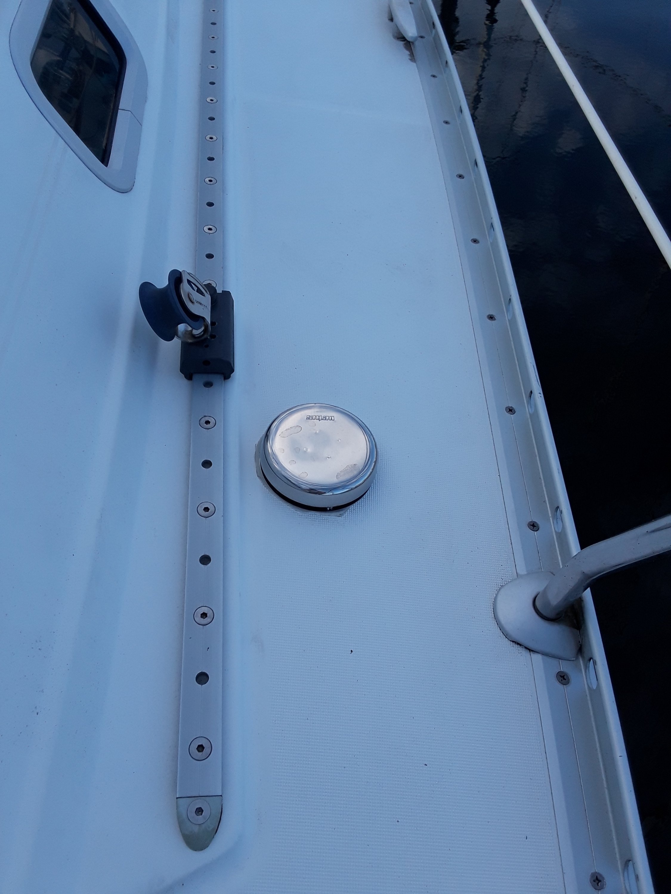

One question though, why don't you simply use the existing vent from the holding tank, or even the pump-out hole? I think I had seen on Youtube how other people have used the pump-out hole as their vent.
Oct 29, 2006
388
Beneteau 381 Olympia, WA

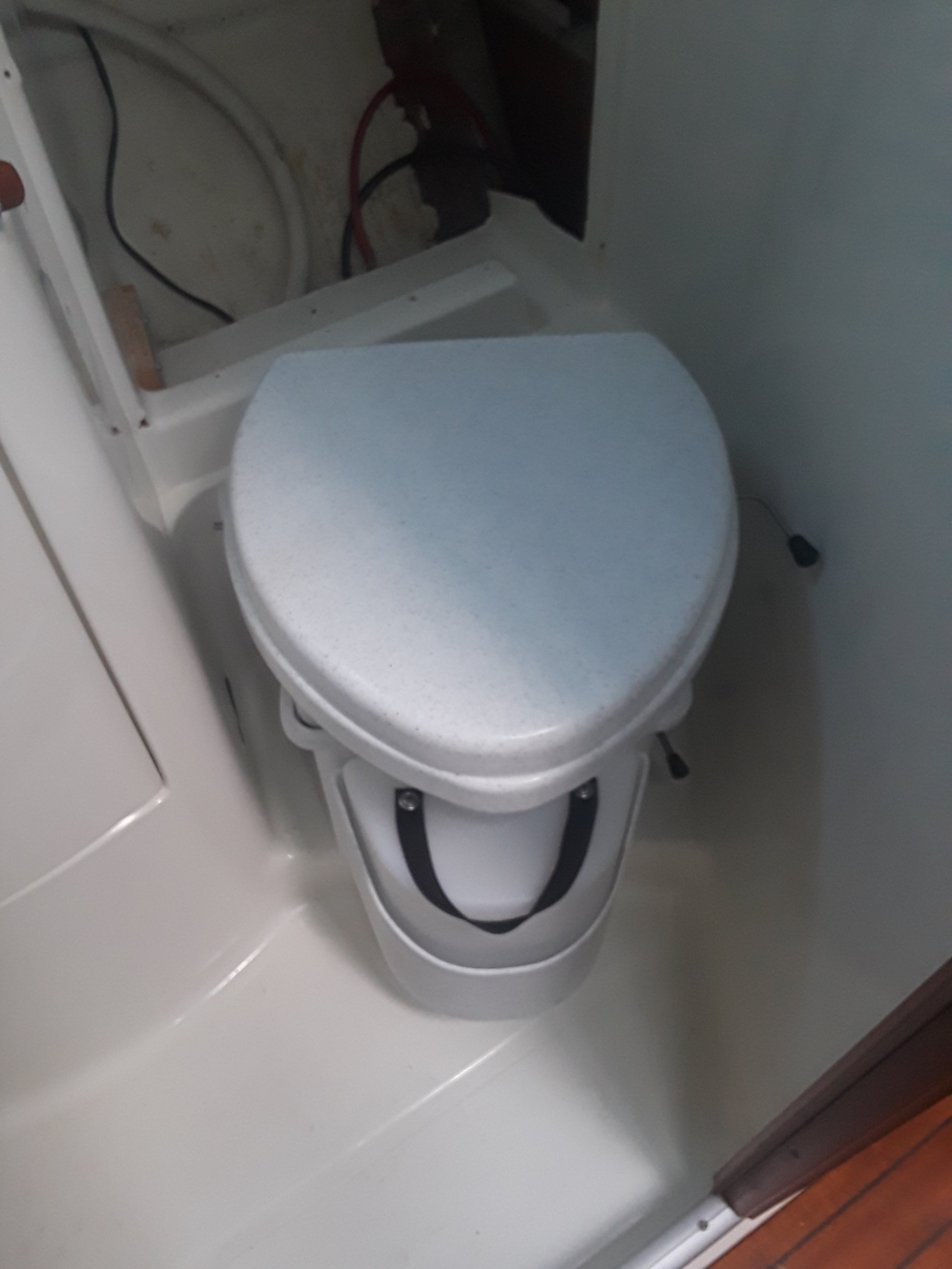

I've permanently installed the head and working on venting. Original plan was to come out from right side and up but after getting the clamshell yesterday and actually dry fitting at the boat I think I'll take it to the pump out and move fan to left side. The clamshell fits over the pump fitting, so it doesn't have to be removed, and the vent hose can be clamped onto the fittings barbs from below so it's very simple, but for the fact my hose is a foot or two short... I'm looking at extending it.

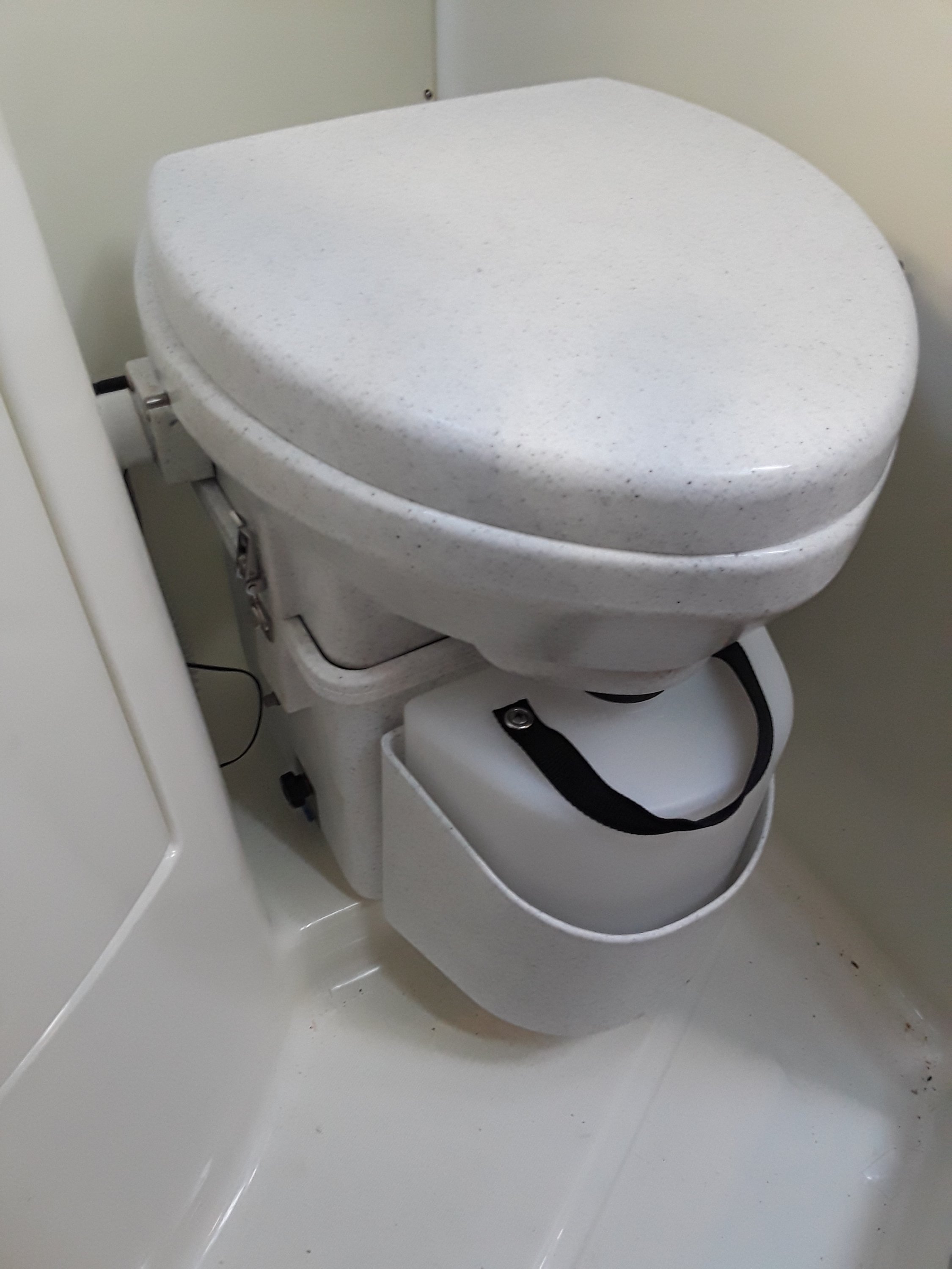

ok installation all completed. used pump out fitting instead of drilling new hole. air is flowing and we either need to close the vent cap or sail nice. have not tried both functions of the head but bottle works. for those interested I got this from nature's head:
spider handle head
extra tank
screw cap fitting
5 feet hose
I didn't get the 5 feet so had to extend it, easy enough but 5-6 feet total vent hose would be nice. we are doing a 3 week sail to San juan islands in July, I'll post how we're liking it.

Just converted my 331 to a Ogo composting head. Lost a bit of floor space and had to make a larger platform but was able to use the waste deck fitting as the vent and used the old macerator feed to power the toilet.
