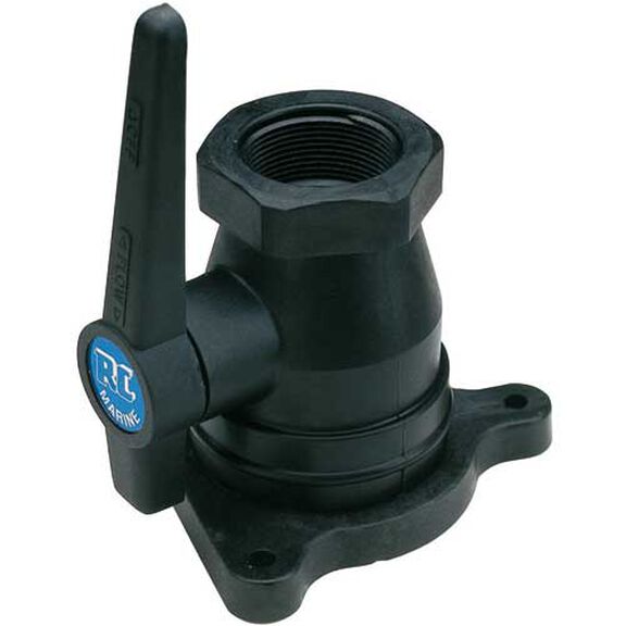

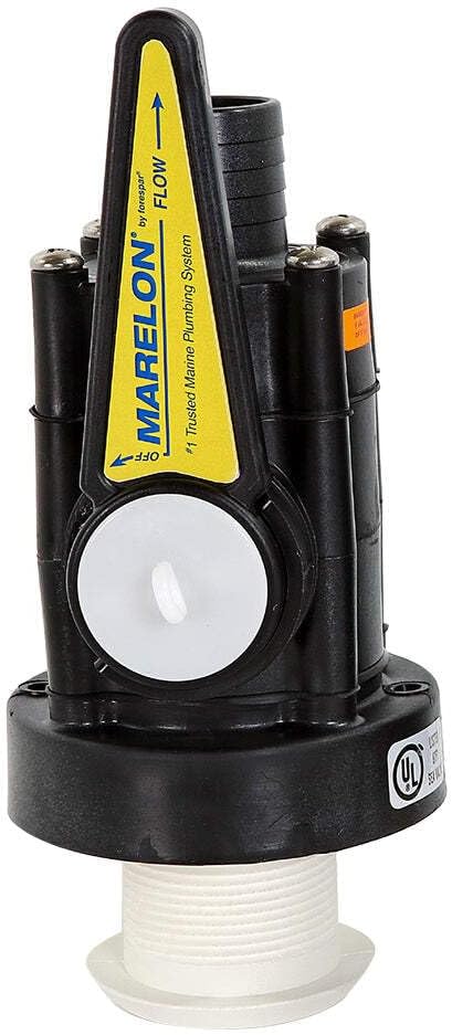

Pictures of bad and good choices attached.
An alternative that I like better than the Forespar 93 series is the ones by TruDesign. They not only have a better way to attach to thehull, they also have a teflon bearing housing for the ball that stays easy to use without any additional maintenance.
Mark
BAD:
GOOD:

Some clarification might be in order. Forespar purchased the RC Marine line of Marelon sea cocks and valves sometime in the late 80's or very early 90's. They then re-designed the tooling to produce their "93" line of valves. Our '88 boat was built with all RC Marine sea cocks, and due to them all sticking (evidently the ball material was slightly hydoscopic and expands a smidge with immersion) I decided to changed them out.
You can keep them working OK, but do need to exercise them regularly and apply a proprietary lube.

Note that the later/current ForeSpar 93 model sea cock can change out a valve with the thru-hull base part still in place, and this can be done with the boat in the water.
Jun 14, 2010
2,487
Yup. That white cap installed on the side of its body is a plug that can be stuck in to cover the hole from outside the boat.
