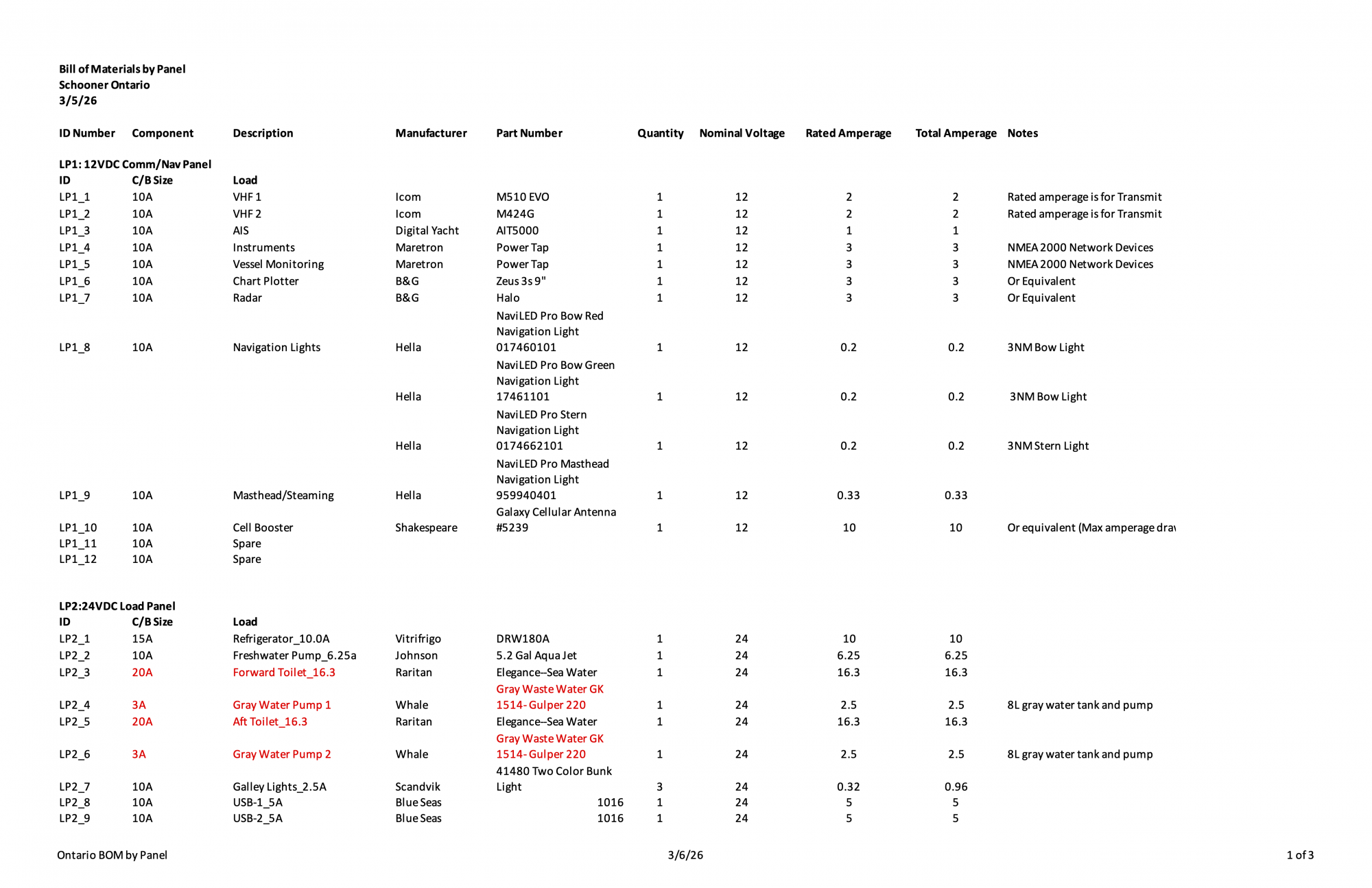

Start with the main DC+ Bus and work out. Problems closer to the bus will have the most wide ranging effect and the most serious consequences. Think, batteries, inverter/chargers, alternators, and solar. Next work to the distribution panel(s). Last work on the individual circuits, prioritizing the most important circuits, VHF, AIS, chart plotter, instruments, bilge pumps. Work down the priority list, refrigeration, water pumps, propane system, etc. Last would be the lighting, it will also be the hardest because the wires will be buried the deepest and hardest to trace.
To help with prioritizing, this is a list of the emergency circuits required on an USCG Inspected Vessel:
VHF1 Standby
VHF2 Standby
AIS
Instruments
Vessel Monitoring
Chart Plotter
Radar Standby
Navigation Lights
Masthead/Steaming
Anchor Ligh

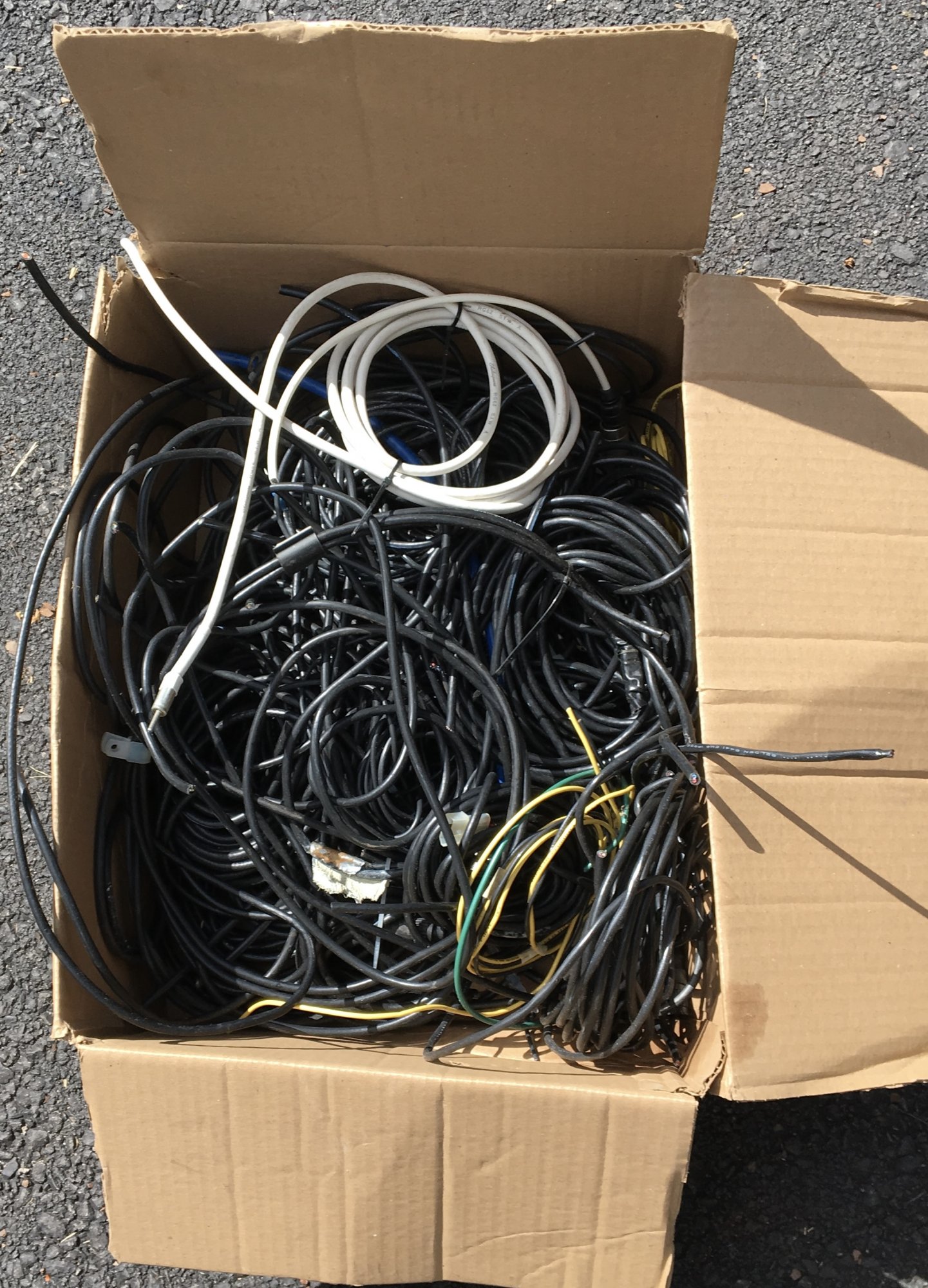

The remains of the second pass at cleaning up the electrical system and removing the old NMEA 0183 system.
Save the wire, copper wiring of any size has good value at the metal recyclers.

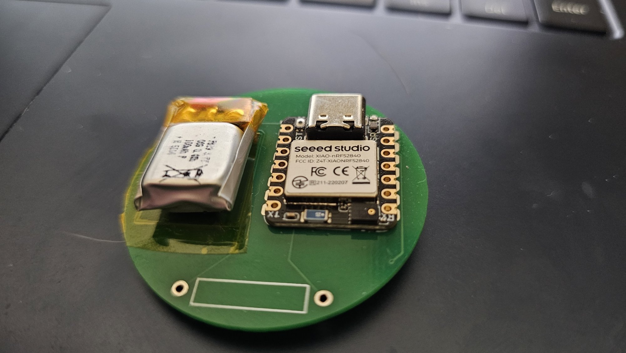

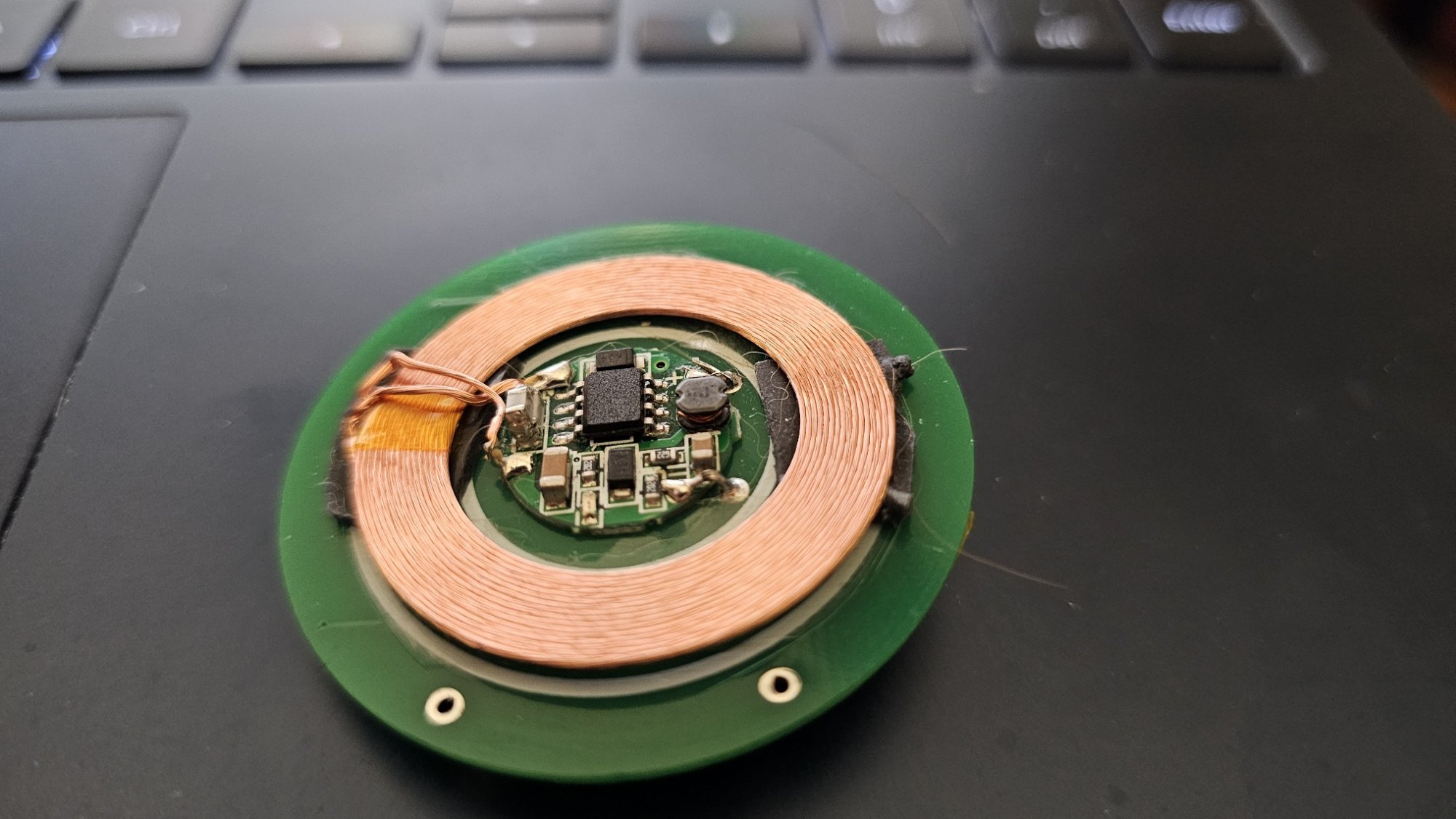

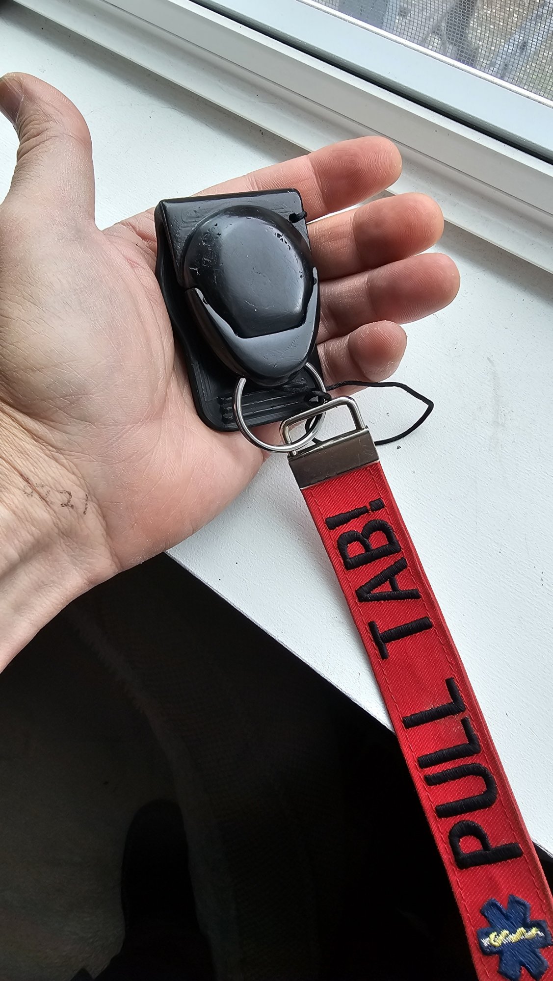

Please do tell more!
Nothing much to it, really.

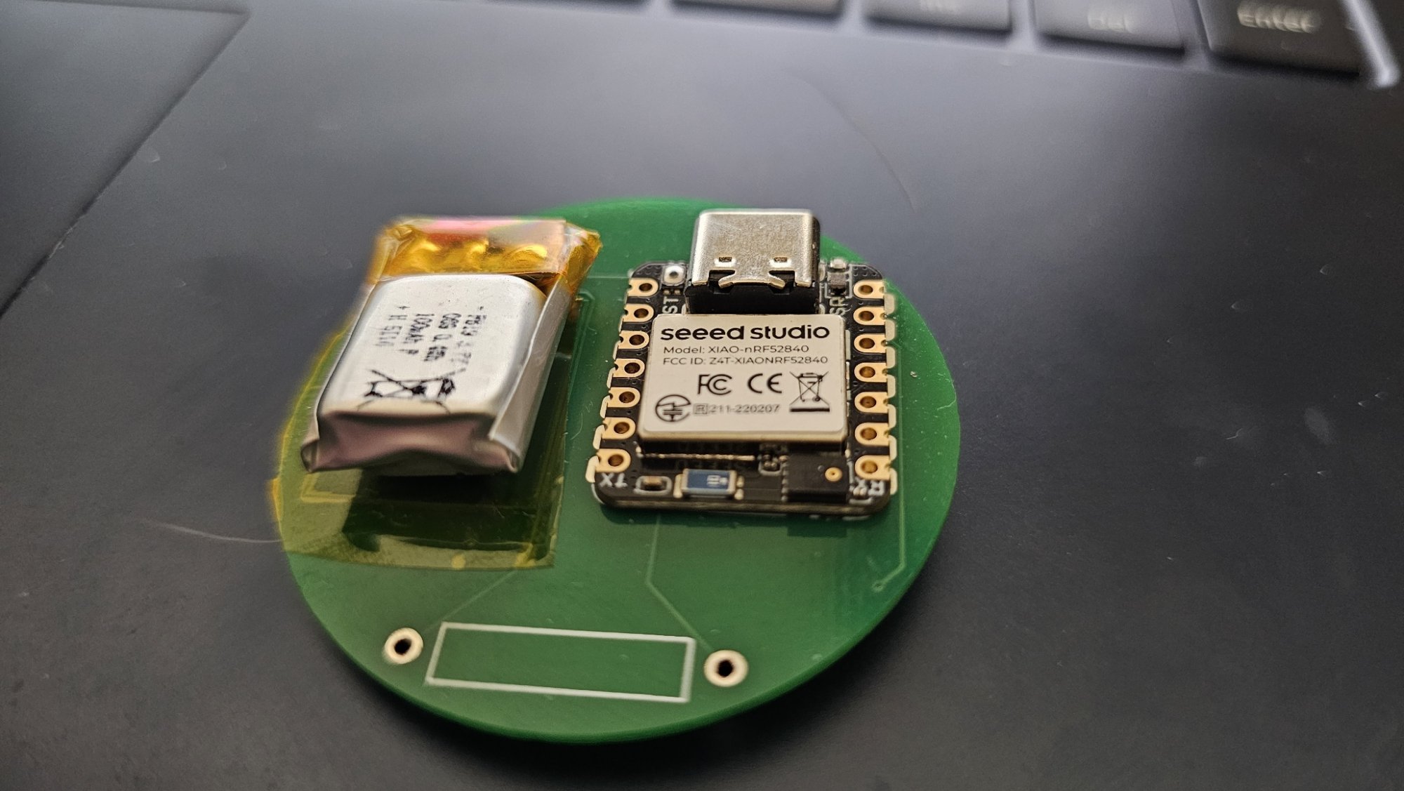

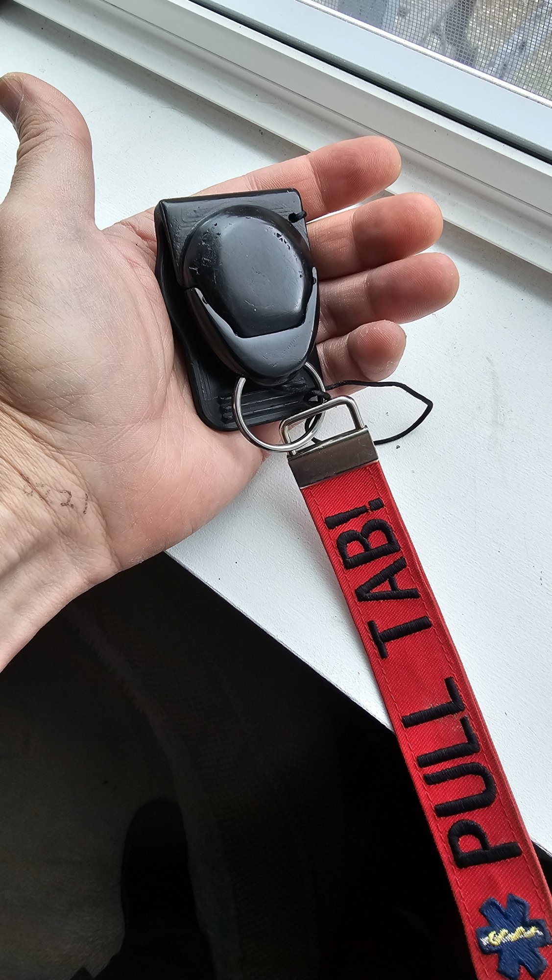

The long story is that I use a service dog whose job it is to get assistance, when needed. I designed, built, and carry this device:
I wear it on my belt. When required, he pulls the tab which activates the device, which uses Bluetooth to connect to my phone. I developed a simple app that runs on my phone and, when the device connects, it initiates an emergency response sequence using my GPS location and some other data.
This works great, but it has always bugged me that the device must actually connect to my phone. That connection takes time and, as most people have experienced, Bluetooth connections can be a little fussy and unreliable. Also, the way I designed this, the device is always on and not rechargeable. So, I need to replace the battery every month.

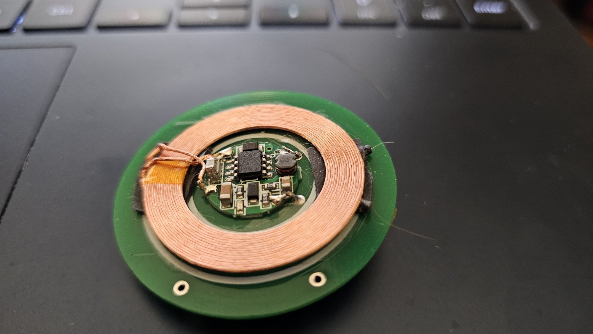

So, I recently decided to improve the device. My new one (nearly done) has wireless recharging but is also ordinarily powered off. It only turns on when the tab is pulled, using a NC reed switch and magnet. And, it doesn't need to connect to my phone. It just broadcasts its ID. That's it's only job - turn on and broadcast a unique ID. My phone just detects that a device with that ID just became visible - even just for a split second. This is much more reliable and crazy fast.
For this device, I designed a custom PCB to fit everything into a compact form, but that isn't necessary for a harness monitor for the boat.
Then, the code that does the main job is just about a dozen or so lines. To wire this into a wiring harness, I would use an ESP32-C3 (about $4-$5), a 12v-3.7V mini buck converter (about $2) and 3D print a case in PETG (pennies). So, at maybe $7-$8 per unit, I can put one of these pretty much anywhere I want in any circuit.
Since each one has a unique ID, I can immediately tell which are powered and which are not by looking on my phone. I'll probably write a simple app that shows active vs inactive beacons in a list - maybe with a diagram to help me visualize, if I get really motivated.
If there's any interest, I'll post instructions for making these, but it is really super simple - just solder the buck converter to the BAT +/- pads on the XIAO and program the microcontroller with Arduino IDE. The code is really just:

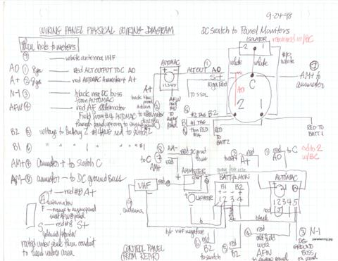

My approach was like "How do you eat an Elephant?" One bite at a time. When I first got my boat, I had a very good manual which I reviewed and compared to what I saw in front of me. If I found anything different I documented it. i also had a tremendous c34 website, which included, among other things, an important article about the infamous "wiring harness" between the engine and the cockpit panel, and also included the color coding. I used this when I upgraded my alternator and installed a Balmar MC612 external regulator. For those areas that were undocumented by any other source, I investigated and drew my own wiring diagram. An example is my nav station where dealer installed equipment was built in with little documentation as to how it was connected.
An "all-or-nothing" approach usually leads to failure. Just take it a step at a time. Plan ahead, take notes and document what you do. I have an entire three ring binder boat Electrical System.

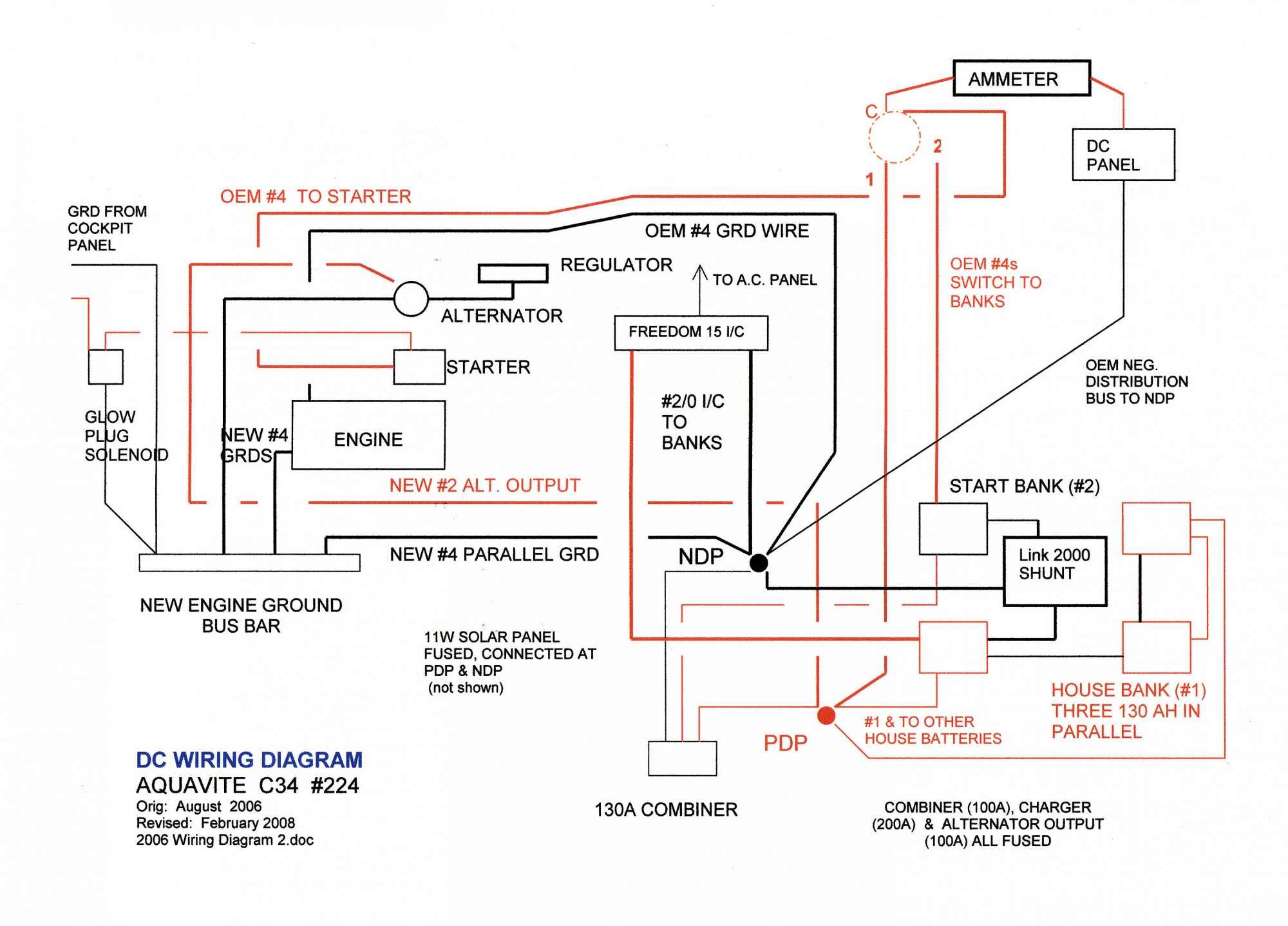

You're making it too complicated. The image below is a portion of a wiring plan I am working on it has all the information that is needed for any circuit. It was easy to set up in Excel. The wires are labeled by panel and breaker/circuit. Columns could be added to indicate wire gauge and color. (This is a draft, the items in red were edited from an earlier version, highlighted so I could easily find the changes that needed to be made on other drawings and tables.) Wires are labeled by the Id Number. Note on LP1_8 there are 3 devices controlled by the one breaker. All three wires will have the same label, depending on how the wire is actually installed, we may add a second descriptor, eg. LP1_8 (Port Light). This particular table is for 1 of 6 load panels on the boat.
