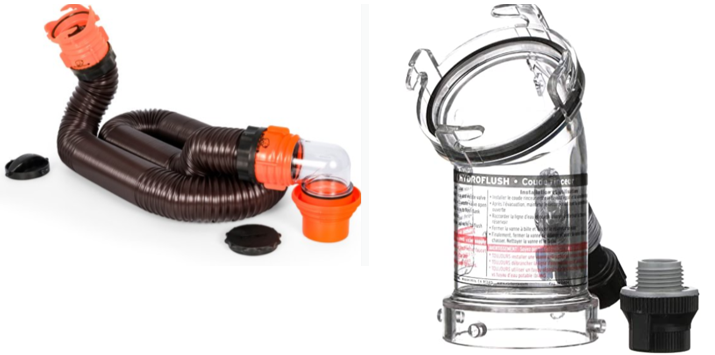

You need to gravity flow into the rv waste disposal system..............so thinking out of the box you could install a gravity drain from your holding tank, of a suitable diameter for gravity flowing the tank's contents (ideally liquid only) through a new thru hull that you can fasten a "leaf-free" adapter to a 3 inch rv hose with elbow (like shown below) to connect into the rv waste disposal system. So that just becomes a pumping project. You will also want to provide a way to flush the system with water so you could install an additional part below to enable back flushing OR insert a hose into the boat's waste tank pump-out nozzle on the deck.

I agree a "low" head pump would work. I was proposing a simple system with minimal additional components. If Tedd's boat has a macerator pump on the holding tank discharge connected to an existing thru hull then he is good to go OR install a new pump, as Peggie suggests, and hose lined to a new thru hull. Then connect leak proof fittings to the thru hull to an rv waste disposal hose to rv dump would work. This would be a simple plumbing project that can be tested with water. Just do not want excessive velocity on the RV hose, which is designed for atmospheric pressure and gravity flow.
