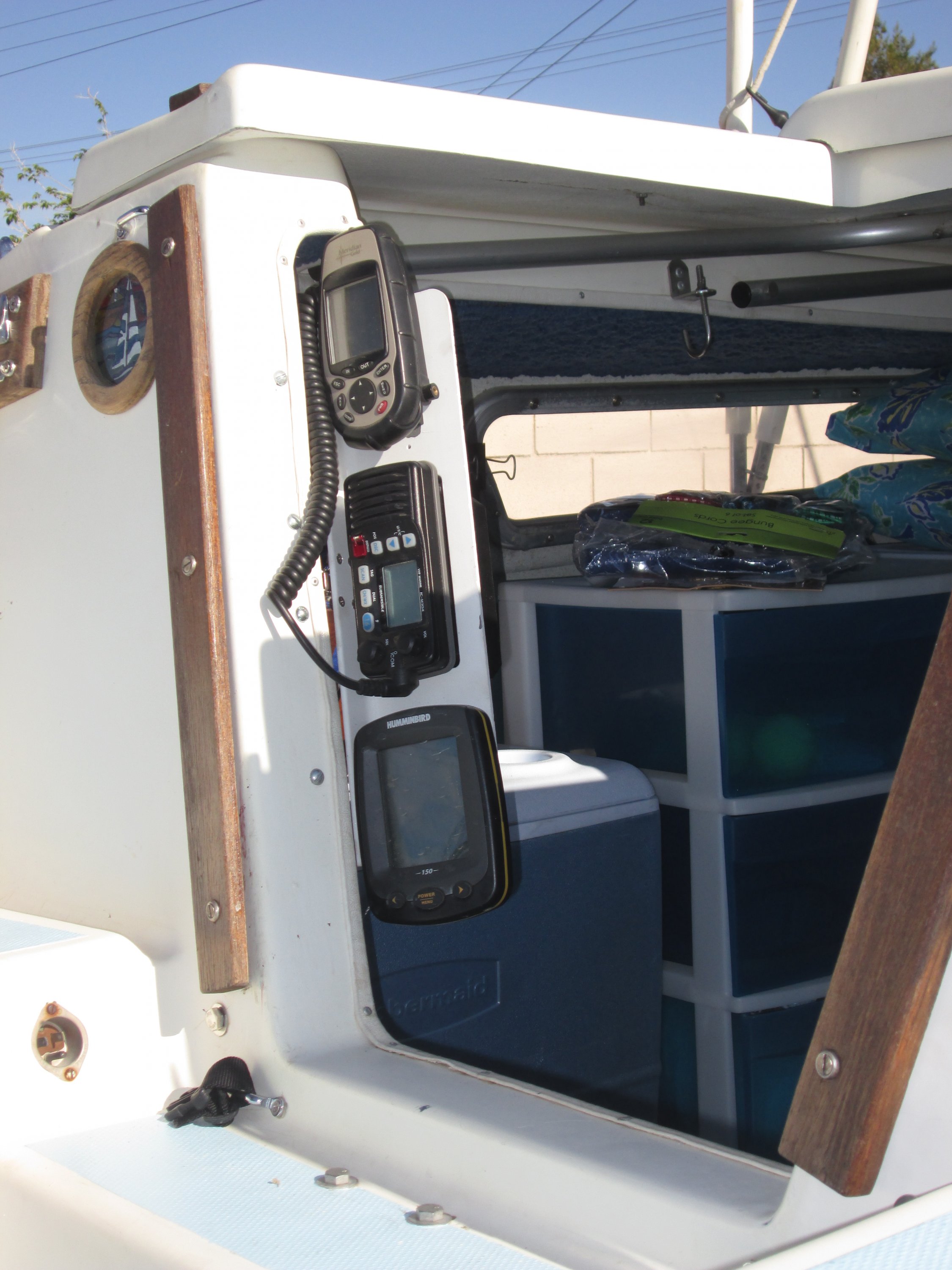

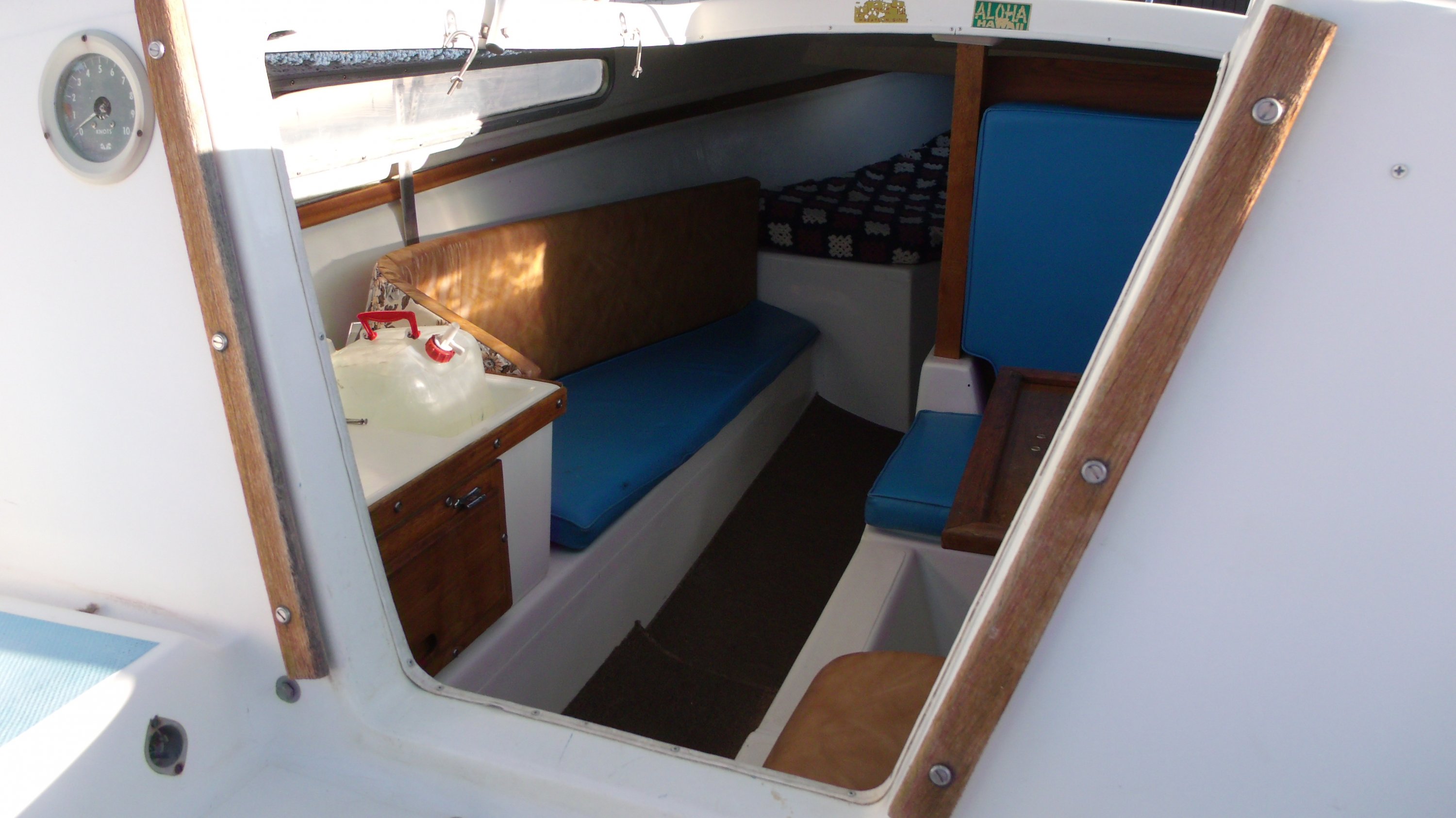

Not particularly scientific but here's what I did with the hole when I removed the unused obsolete knotmeter from my previous boat. I only wish I had a picture from inside. The sained glass looks really nice when the light shows through it.
