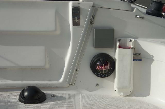

Mine mounts like this and it does not care if you knee it.
I dont have a liner but it still invades the cabin a bit.

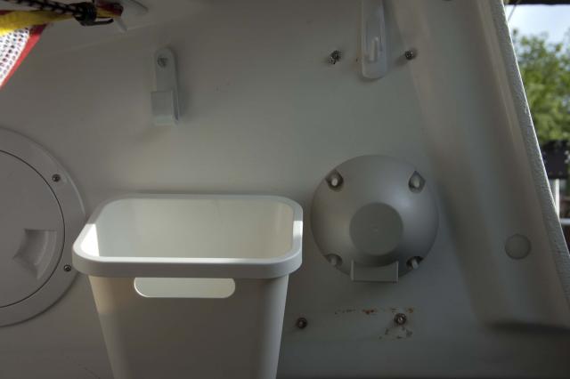

Mine is mounted through both layers. It's the way the PO mounted it. I don't think theres much choice with a bulkhead mount. I had to replace the original with a Ritchie. Mine has a cover on the inside cabin to cover the back of the compass.

So is there something between the layers to keep them separated as they would normally be, or just let the mounting screws pull the two layers together?
My compass has covers for both the inside and outside.

I replaced mine, a year or so ago, it was just sandwiched between the 2 layers... did not leak. and it has a interior cover.
my advise is get a popular brand so in 10 yrs, you can replace it with the same model...
(I got lucky, suminto is getting out of the marine compass business, but was able to order same model..) and it was leaking... not sure why.
I do like the bulkhead compass...
