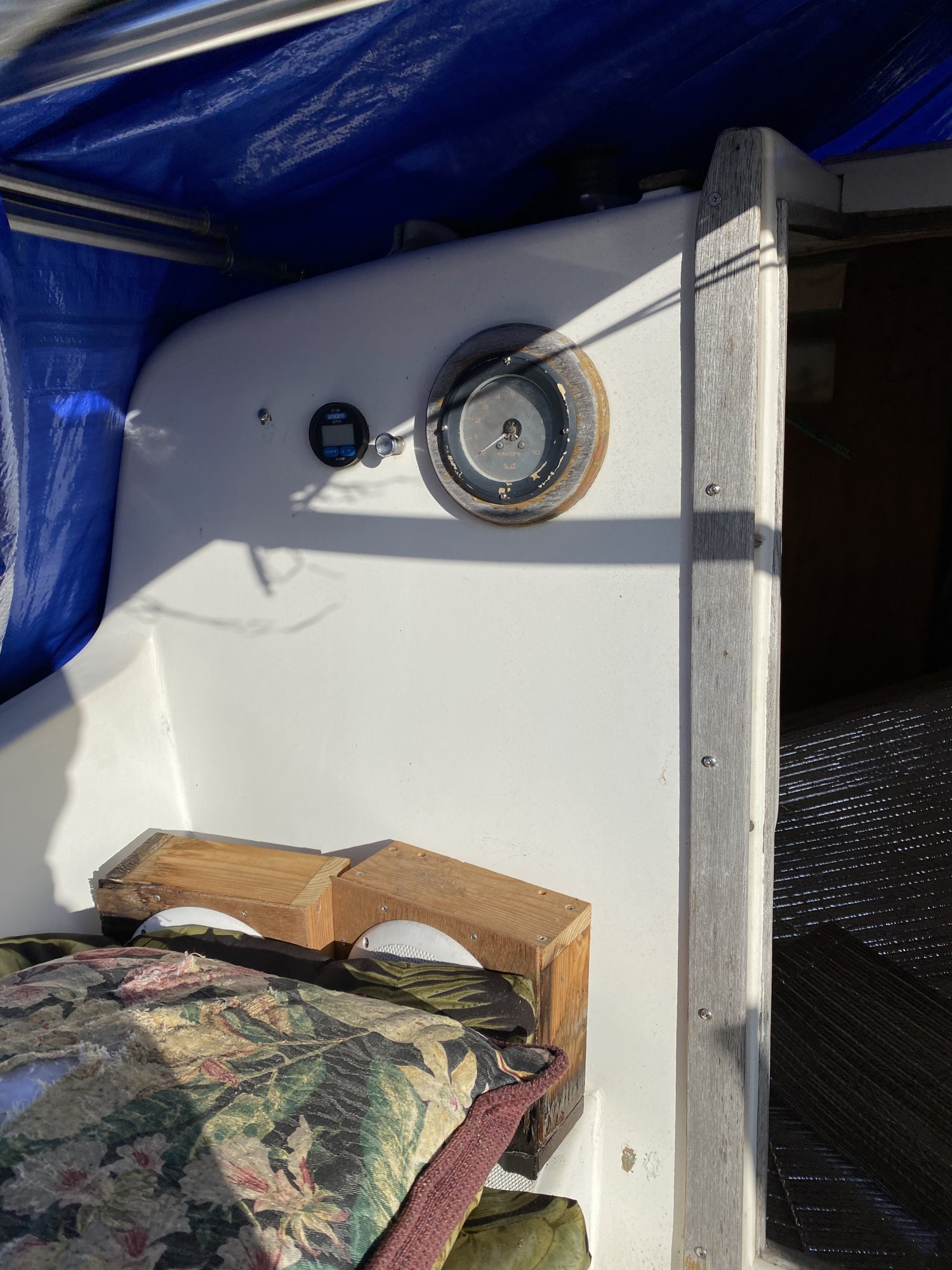

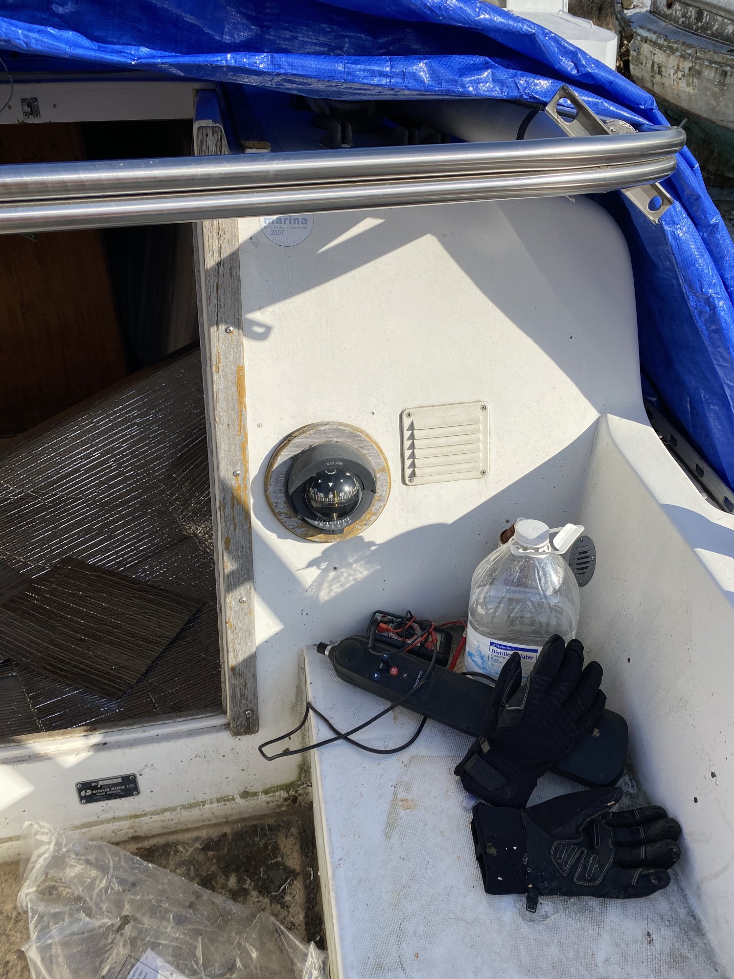

Hey everyone, dreaming about summer and I was wondering where your compass is located on your bulkhead? Port, starboard, high, low? At the moment mine is on the low side of my starboard bulkhead, I have a non working knotmeter on the high side of the port bulkhead, I was thinking of putting my compass in place of the knotmeter and buying a cover to close the hole on the starboard bulkhead, what do you guys think?A2990C02-03D8-48FF-8831-4FC18351266C.jpegF1E9D253-B550-43B5-8C78-5CA71BD20F9B.jpeg
I want to remove them anyways to redo the teak base

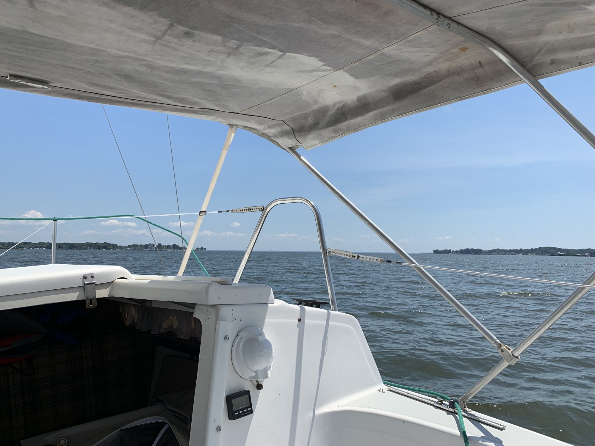

On the starboard side with the depth gage. Never use the compass as I only day sail in the Hudson River in fair weather. I can always see land and know it well where I am going. Occasionally use the compass to check that I am on a constant heading.

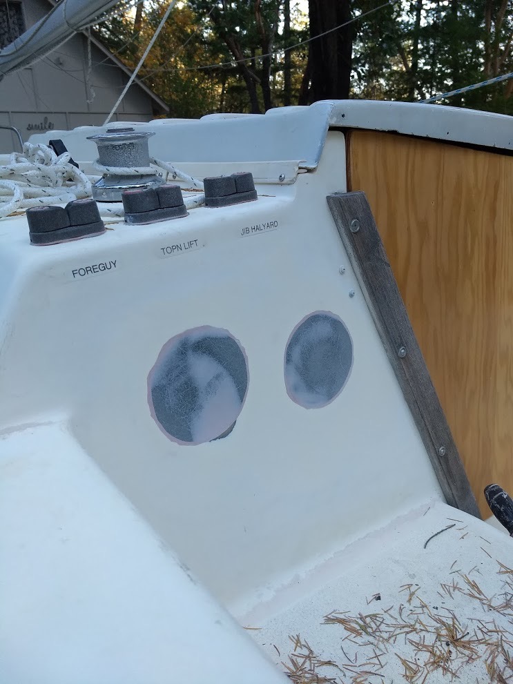

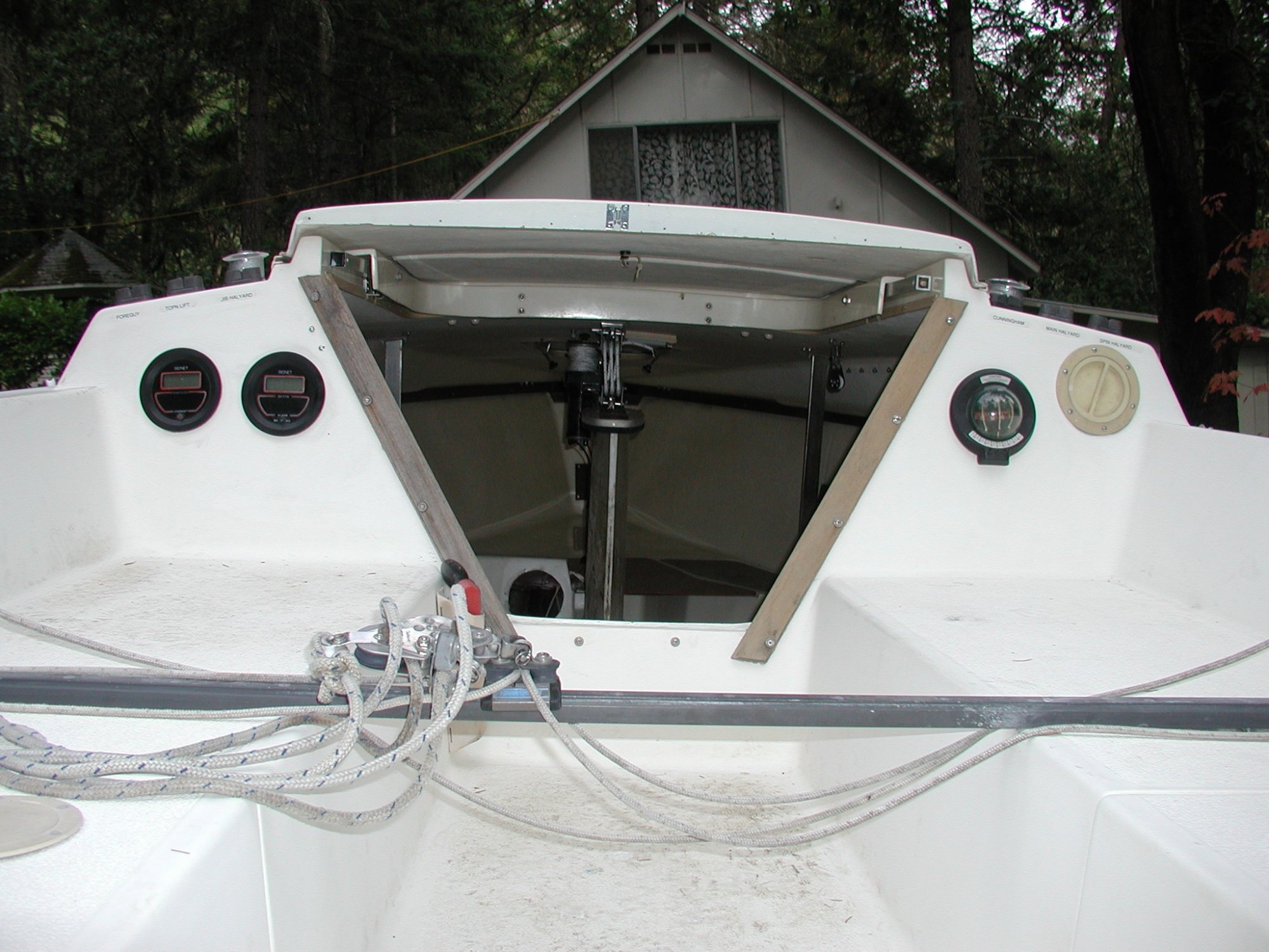

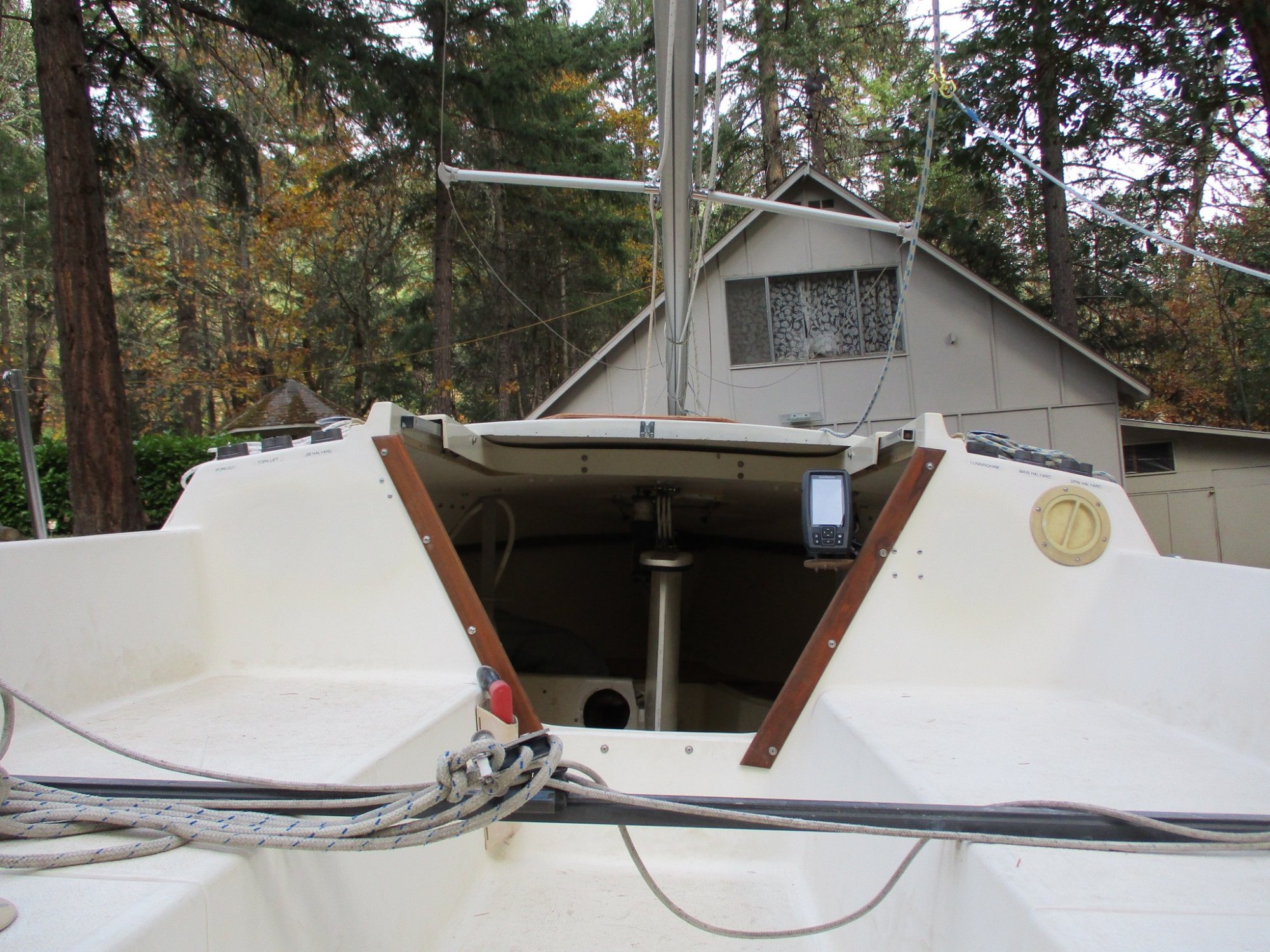

Fiberglass is so easy to work with why not glass in the holes and start over. a blank slate, so you're free to place things where you want them rather than be dictated by some funky covers.
as purchased..................in progress.............blank slate

Pointers? nothing special on glassing in the holes. it does save some time if you have a piece of scrap fiberglass laying around to cut out to fill the hole with. but not mandatory. from there it's just a matter of filling the voids around the edges and sanding it down. I use rattle can paint to blend in, just on the area ground away. might take trying a few cans to find a good color match, but not that hard.
