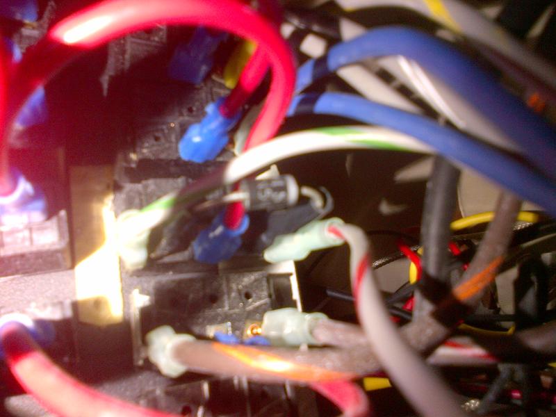

I believe the PO did some mods on my mast head and anchor light. I've been on and off this project for a while and if stuff was labeled, I probably wouldn't be so frustrated. I had a post last year which Dave commented on and explained the wiring for those lights with the switch 'jumper' added at manufacturing. Currently that jumper wire is in place and when I use the three way switch, on either side both the mast head and anchor lights go on together. Not sure what to do there. I also saw the wire diagram in the manual which confirms what Dave explained about the jumper. I disconnected the jumper to see if only one would go on but somehow both still go on.This will have to be a project for the winter to rewire everything in the mast. Hate electricity!

I attached a picture of the jumper in place. There is something on that jumper which I will assume is a diode. I don't know how to identify if it is a diode or not but I will confirm what the numbers on it are today. I'll compare to those in your attached link.
I can't stress enough how much this particular issue has stressed me out.

From your photo it looks like you are wired correctly there. You could use a test light or multimeter on the switch to check. My suspicion is that your deck connector at the base of the mast may be wired incorrectly. - ie power is going to the anchor lights ground connection and one of the power wires being used as the ground instead. On our boat it was the mast wire to connector that was incorrect.
Assuming your 260 still has factory wiring here is the mast wiring diagram. I would check that the black wire on one side of the deck connector hasn't changed places with the white or red.
http://www.marlow-hunter.com/export/Model-Information/260_1997_2005/260 mast light wires.pdf
10,536
-na -NA Anywhere USA
If you have the three prong deck connector for the mast lights, generally the largest prong is for the negative wire(if there is a yellow wire, that will be for DC ground vs. the traditional black-not sure when the switch was made). The other two prongs of similar size will be for positive. Then it is a matter which positive wire goes to which. Remember the anchor light is a 360 degree light while steaming is a forward 180 degree light. The mast light was a two light unit separated by a wall but I have forgotten the manufacturer..
