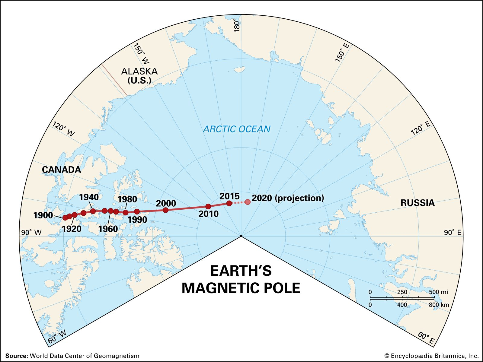

The North Pole is moving... and has been for years :yikes:..
Then we begin to wonder... what else is changing.:biggrin:

The good news is that magnetic N has gotten closer to true N over time!

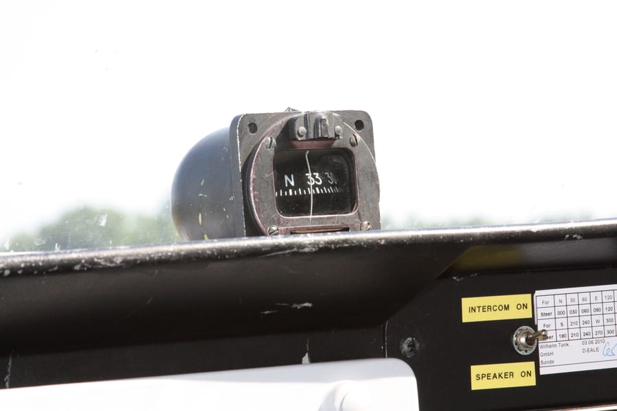

To go back the OP's question. Inside the compass housing there are 2 small magnets of pieces of iron. A screw attached them will rotate them in the housing to help zero out any deviation. In reality the deviation is seldom eliminated, however it can often be reduced.
Most compass cards are only accurate to ± 2.5° or less. That is more than close enough for most navigation so long as charts are on board and the eyeballs still work, and someone on board learned to navigate without relying on Navionics.

used to do compass swings on aircrafts and that took a few hours to make a deviation card. The problem that i have seen even on my boat is what do you have by the compass part time as some items could influence the compass heading.

Looked it up at the internet. The srew fpr correcting E and west is at the stern side of the compass, the one for correcting N and S at the starboard side. Thanks, Viktor
