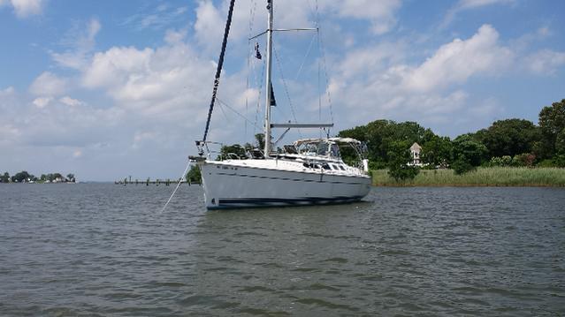

The Admiral and I decided on a 2007 Hunter 41 Deck Salon. We brought her home last week and really love it!
Thank you all for the replies and feed back.
TFlight
Congratulations!
Post pictures.

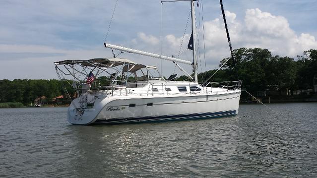

TFlight, she looks beautiful. Looks like you have the Hunter davits on the back, as I do. Appears to be a solar panel on top. I am about to mount panels on the top of mine as well, just wondering if there is any way you can send a picture of how it is mounted.
much appreciated
Dave
Thanks, Yes she has a Hunter Davit Sys and 205W solar panel, 4KW Gen, and a bow thruster I'm trying not to use too mush as I learn her basic handling characteristics.

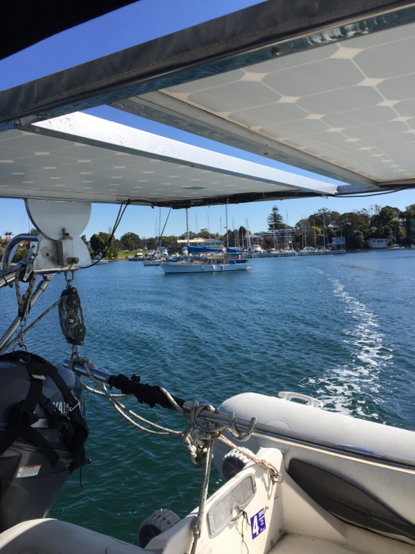

I have 3/175 watt Solar panels fitted on top of my davits as well as a solar booster. They provide tons of power image-3091633849.jpg

I have 3/175 watt Solar panels fitted on top of my davits as well as a solar booster. They provide tons of power <img src="http://forums.sbo.sailboatowners.com/attachment.php?attachmentid=90737"/> <img src="http://forums.sbo.sailboatowners.com/attachment.php?attachmentid=90738"/>
I notice your bottom paint wraps up your transom. Is it in the water at rest at the dock?

No the water only goes up there when motoring or in really freshwater. It was starting to get a brown mark along there so I decided to put the anti-foul long there as well
