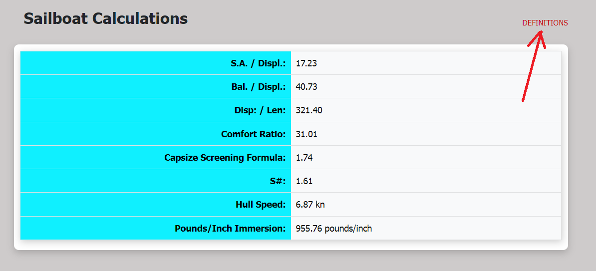

If you scroll down on the "sailboatdata.com" page for the boat you are looking for to the "Sailboat Calculations" field, you will find a bunch of numbers that are used to compare and contrast the performance of different sailboats. If you need some help understanding the numbers, click the small "Definitions" link in the top right corner.
So you described the boats ability to handle waves. Two things that speak to the sea-kindly nature of a boat are the Bal./Displ. ratio and the Comfort Ratio. And if you want to compare performance (especially in light air) the S.A./Displ ratio is the number you want to compare. I also pay attention to the S#.

You want to be smooth in chop you need a boat that will be bigger than the chop you are experiencing. The ComfortRatio gives you a mathematical insight. You will only know if you sail on the boat.
The challenge is you are going to run into compromises. A slender long boat will cut through the waves. A light fast boat will ride the surface yet be bounced about. Look at hull design and identify what experience you desire. You have mentioned sipping drinks in the cockpit in several posts. You just posted about a boat with a 26' LWL and 13K displacement. This will make 4ft waves feel like ripples and your drink will stay put. The original Catalina 30 is 25ft LWL and 10K displacement. 3ft waves... ok may be 3.25ft. The O-Day 25 has a LWL of 21ft and 4K displacement. Bouncy bouncy in 2ft ripples isn't that what concerns you?
