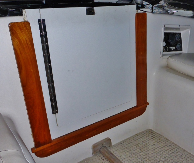

Or you could go this way. Personally, I HATE hatch boards. This is the very first job I undertook after moving aboard. It slides tightly in the hatch board slots. A bit of starboard and a hinge.

Not to steal the thread, but I would like to hear more about that event. What did you do to secure the companionway after you lost the hatch boards? Did you do a complete rollover? Was that in your current boat?
capta
Jun 4, 2009
5,006
The boat had solid wooden doors which were not lost. The sliding hatch was torn off.
Not my current boat. That was a wooden boat, this one is fiberglass. I believe we owe our lives to the fact that she had wooden masts and the main was a solid tree. I'm sure the buoyancy of that tree righted the boat before she had taken on enough water to sink. Just a theory, but that's what I think.
